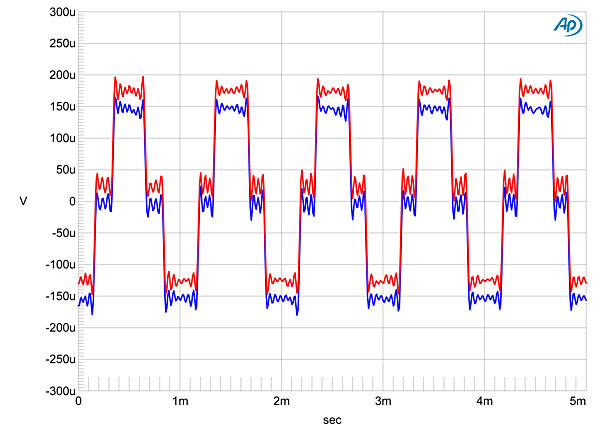

Ok I read the white paper by BenchMark....... 16 bit systems (CD's) I agree they absolutely ought to be dithered.... Here is that 16bit undithered at -90dB. that poor signal waveform needs to go away and probably well before -90dB. So, you reduce the bits or dynamic range....... but to be rid of the noise created by dithering, Benchmark adds a step to shift some or all the noise to above the audio range. They refer to it as "Properly-dithered" throughout the paper.
-90 undithered 16b

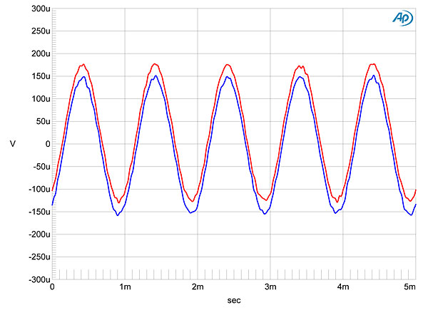

A 24 bit will never add noise to the system (-144dB). And, doesnt need to be dithered at all or until way below -90dB. Possibly the noise floor itself will do the dithering.
-90 undithered 24b
24b word lengths provide a very efficient method of improving the noise performance.
Now, I dont know and I should try to find out, if the 16b/44.1 CD player I've used for years (Sony) even added dither or did added it and did they do it 'properly".
But clearly whether 24 bit files used or didnt use dithering, I wouldnt notice it at -144dB area or where ever the noise floor actual is. So, I tentatively doubt dither was responsible for the improved sound of 24b files.... unless the increased dynamic range was a part of it.
