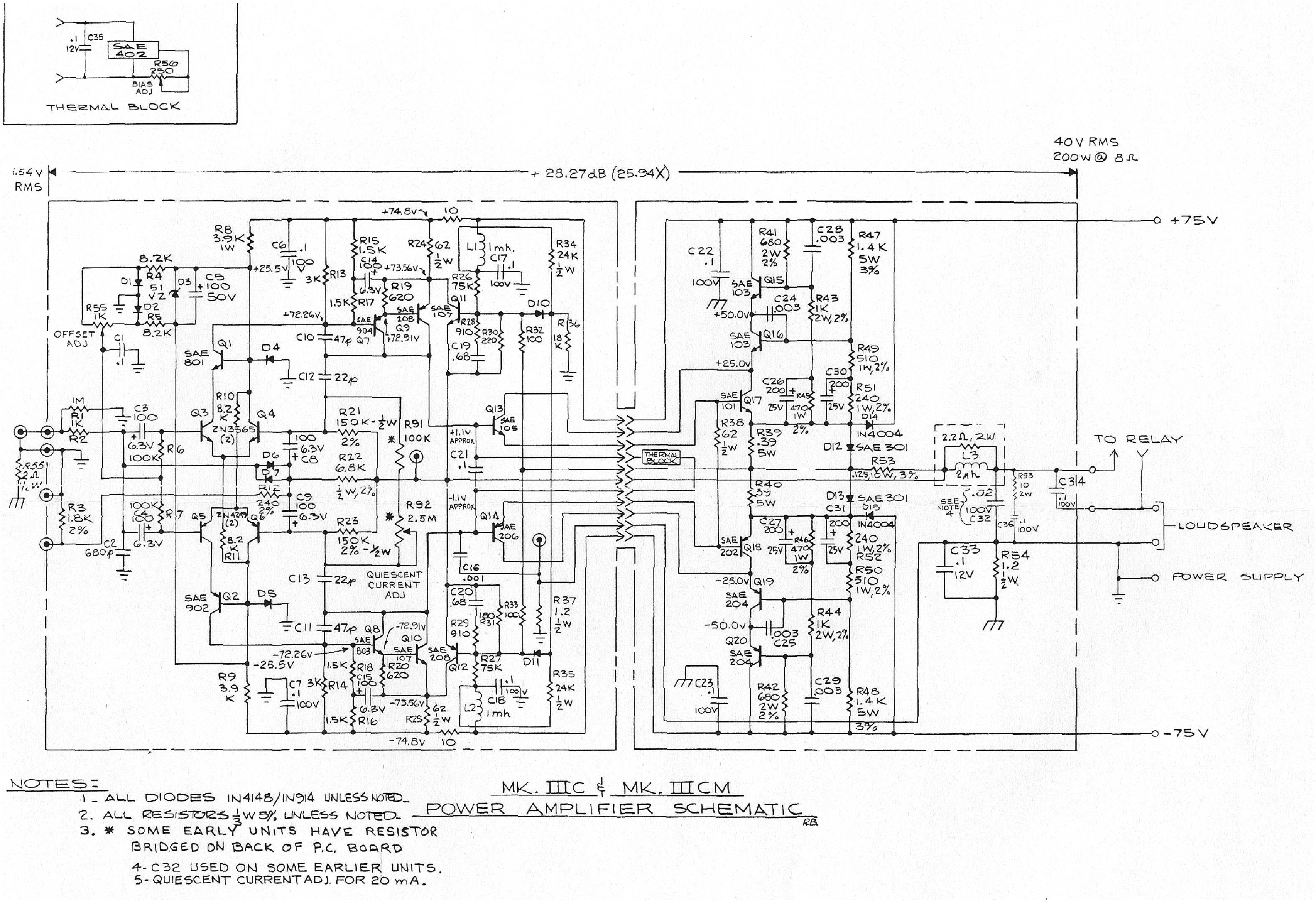

Very interesting.
James Bongiorno had same ideas around that time in his SAE MarkIIICM amplifier....and also his GAS preamps!
SAE is Scientific Audio Electronics history and models
James Bongiorno Designs
Very interesting.
