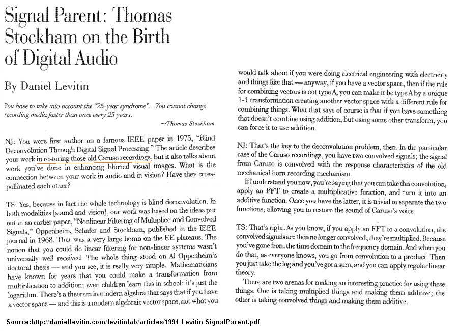

Noob Query :
Suppose we know "specific" equipments used in historical recordings (Tapes, Mics,) and know their (equipments) inherent problems and limitations Can the recordings be cleaned and improved upon "specifically" to that recording ? Kind of like forensic appraisal.

Yes and it has been done
AES E-Library Restoration of Old Acoustic Recordings By Means Of Digital Signal Processing
http://daniellevitin.com/levitinlab/articles/1994-Levitin-SignalParent.pdf
George
>Edit: Recording company Soundstream did it commercially for RCA in 1976
