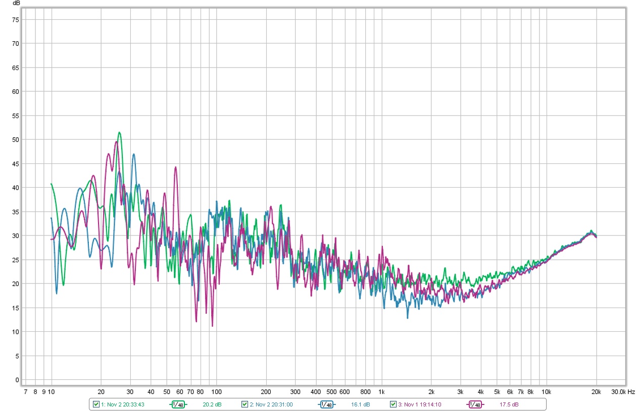

I measured my listening room late last night --- 22dB. Would that help you?
[I can easily hear sounds some dB's below that background.]
This is my living room at it’s quietest (during daylight time, plots are some 20dBs up) . Each of the three plots is a two measurements averaged. Each measurement last for 5.9s
