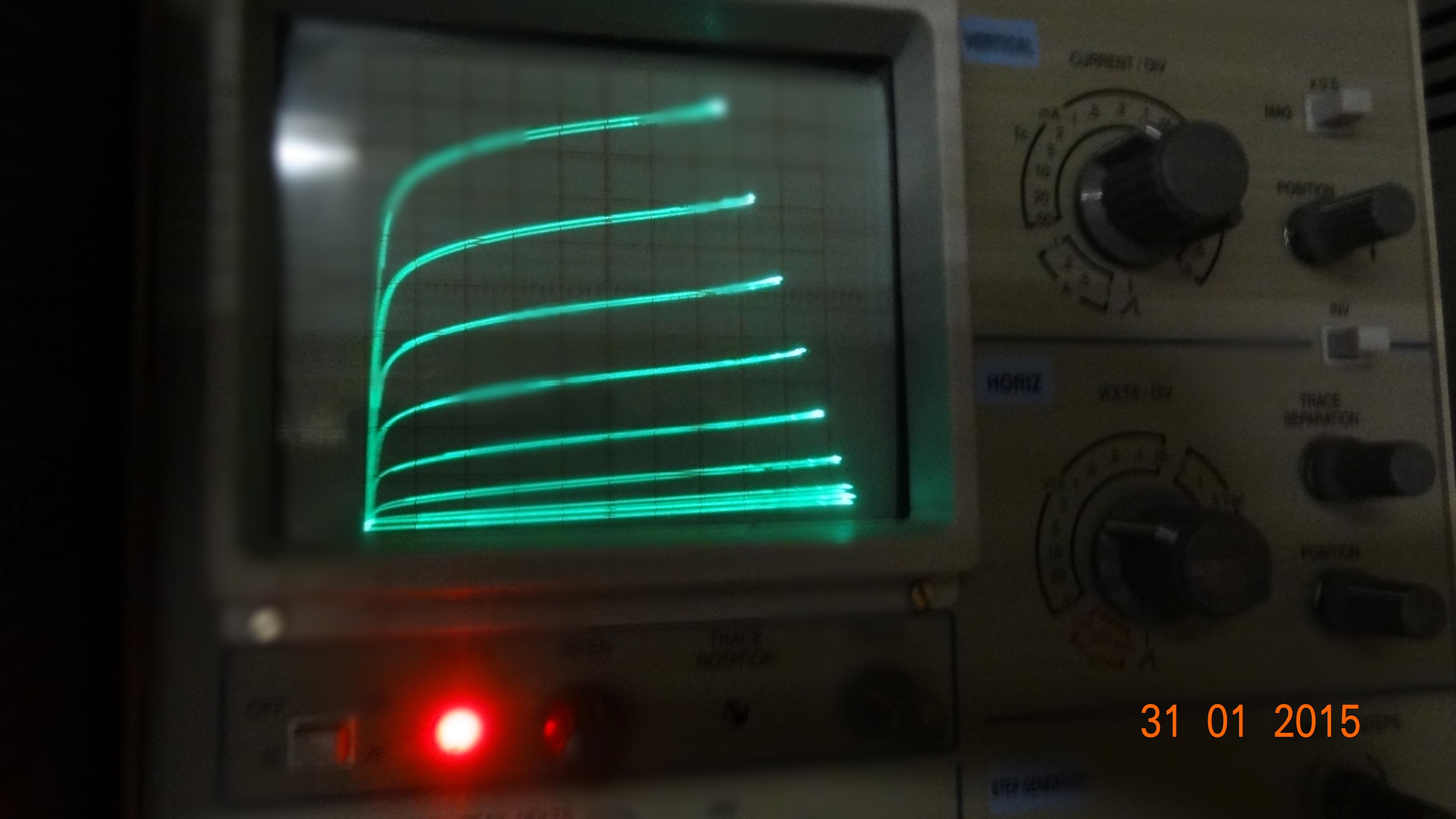

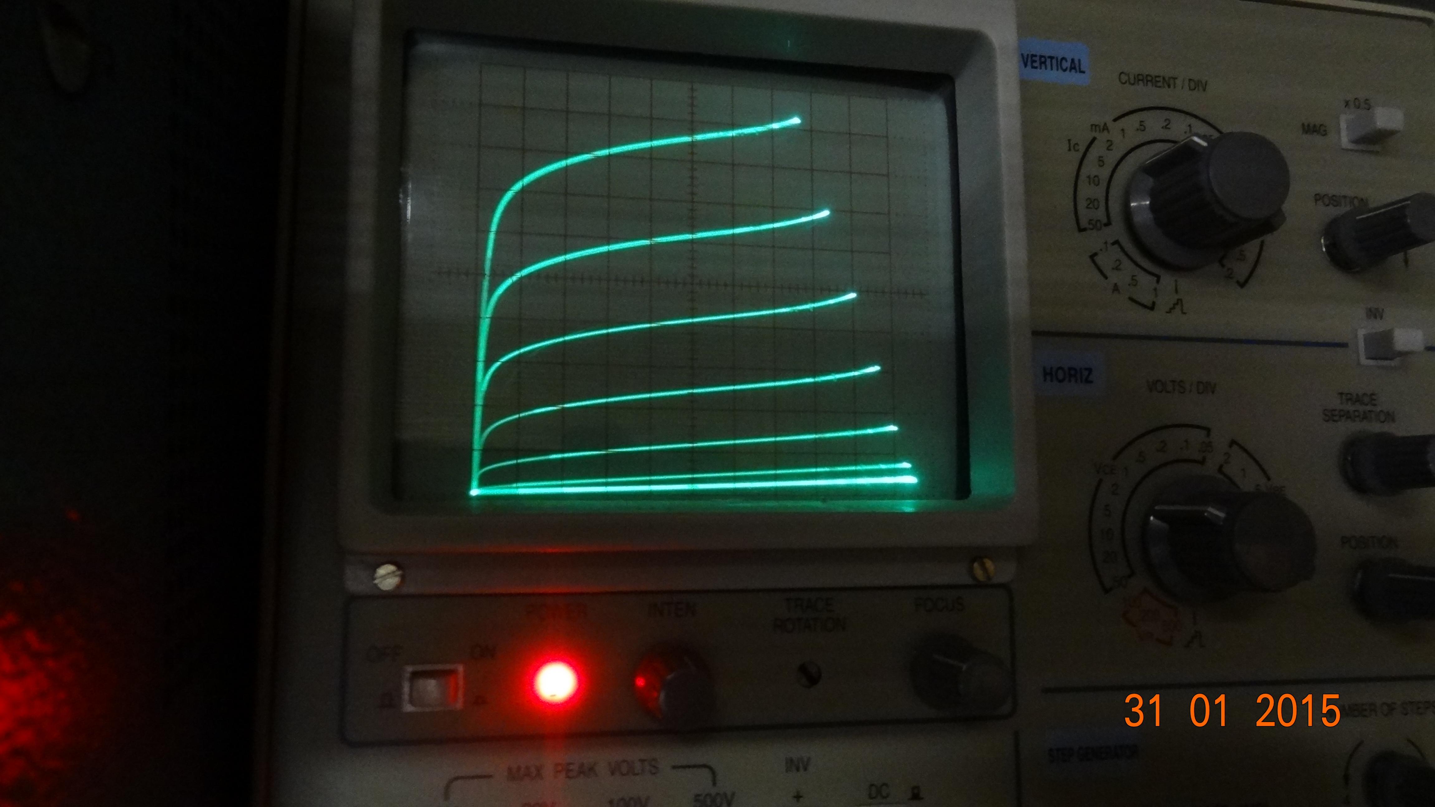

If you have a can of freezmist handy, what happens when you cool down the DUT?

Richard, this indeed might be a shift in the DC operating point of the device. The die/package thermal mass on a SOT23 device is very small. Of course, I say this expecting that you used fine wires to attach the device to your test leads. Once a SOT23 devices is soldered down, the copper lands can be made large and the effect is reduced - this is of course also how the package dissipation can be improved.
If you have a curve tracer you may be able to verify this proposition independently.
In any event, for practical purposes, as long as the 1/f corner is below 100Hz and above that it's very low, I think it's good to go.

BF Transistor: About 5 seconds between pictures..... normal room temp and freezed. Sorry I didnt use the scope camera -- just hand held camera... left the curve tracer sitting on the storage rack and set as per last use. step level shifts.
THx-RNMarsh

hey, you were talking about a "a modified version of Mr Wurcers X1000 amplifier",
AC-Couple that to the display :rolleyes:
Maybe you should have used a blowtorch for the job :eek:

A thermal camera is much better as you get a calibrated reading, all you get with a DSRL is an indication of the hot spot. Used Thermal cameras a lot on designs over the years (Fluke), excellent tool for showing what's going on heat wise, and where hot spots may be, you also need some black electrical tape for the shiny components...
Now some may see the small SMD packages as being disadvantaged over older PTH packaging, this is not the case in many situations, what you get is a much lower thermal resistance between the die and the rest of the world, allowing you to control the temperature of the die much more closely... When mounted on a PCB. The packaging also has much less parasitic's from the board to the die, not so critical for Audio, but hi-speed and RF much better.
So this is not a problem, in-fact its an advantage when doing designs as said you can control the temperature of devices easier and in a more confined space. Just spent a few weeks re-designing some PCBs for thermal performance, lots of thermal vias, hybrid modules and 0705 Resistors.
A better test would be the DUT mounted on a PCB, we do device PCBs for a certain company that does Diodes etc. quite complex boards mechanically to fit in the test jig and hold the device down.
