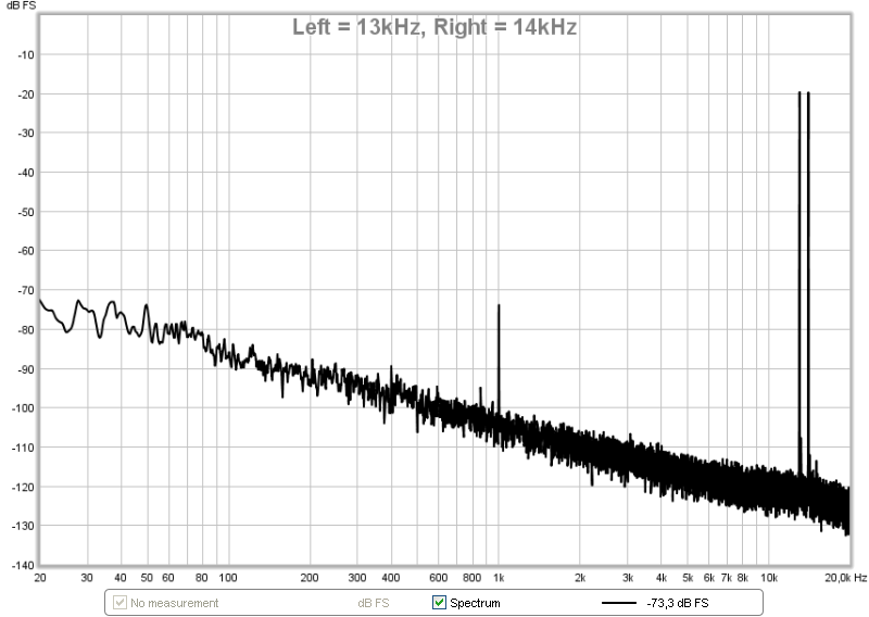

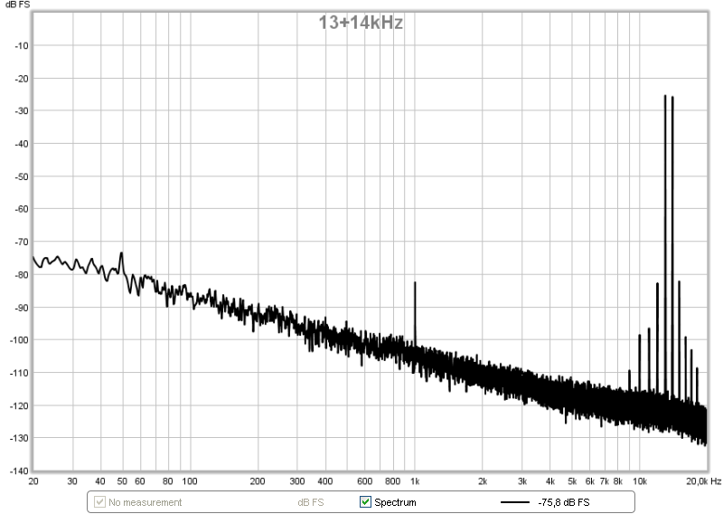

I have shown, in this thread a measurement of a midrange driver at 2kHz and about 2Vrms and was told that high order distortion components are a product of the measuring microphone and I was suggested to use a compressed air to clean it. Nice shot, but out of the target. As a proof, I am demonstrating a CCIF 13+14kHz of the tweeter. It was measured with 2 speakers by 2 different test signals.
First signal was pure 13kHz feeding left speaker and 14kHz feeding right speaker. Thus, there is no intermodulation in tweeters, only in a measuring microphone. We can see, in the measurements shown, that there is a difference tone, i.e. 2nd harmonic component, in the microphone channel output. But, no 3rd, 5th, 7th etc. No skirts. In the second measurement, only the left speaker was driven, with 13+14kHz twin tone signal. Now, we can see not only the 2nd harmonic, but also the skirts of 3rd, 5th, 7th and 9th. These are tweeter odd harmonics intermodulation products. Not microphone products. Just to mention that system intermodulation (electrical circuits) is invisible in this scale.

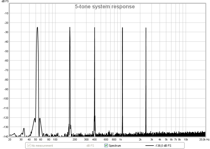

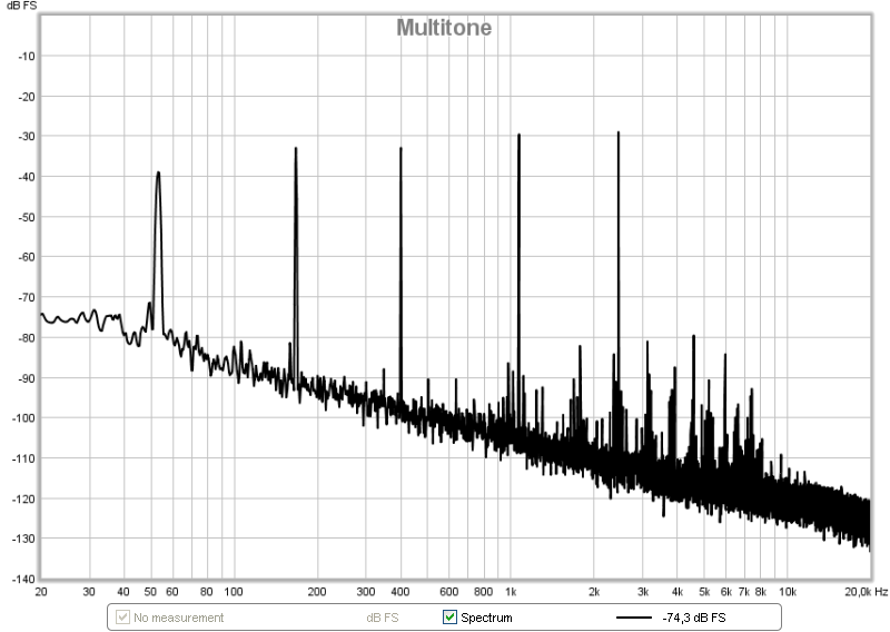

I have made a set of multitone measurements of speakers: 3-tone, 5-tone, speech, ITU_T 0.81, low decade, high decade ….., so if anyone is interested, I can post more plots.
Pavel, how did you determine the system electrical responses - was this measured at the speaker terminals, at the same time as the speaker responses were taken?As a start, 3-tone and 5-tone speaker responses compared to system electrical responses.
Excellent test methodology.

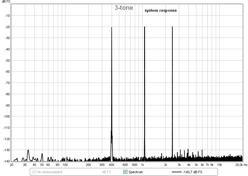

Thanks for testing.
This all looks quite familiar, an increasing floor of modulation components orders of magnitude greater than from electronics. In short, speakers produce lots of modulation noise.
Andrew

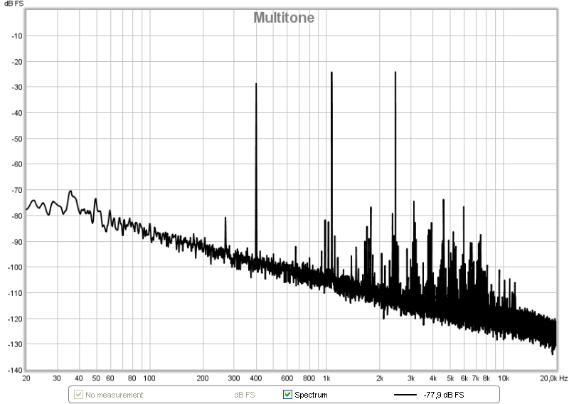

This was 3-way. Vrms <2V
Results are quite consistent with different speakers.
There is a rule, 3-way has less distortion than 2-way and 2-way less than fullrange. Smaller woofer has higher LF distortion than bigger woofer.

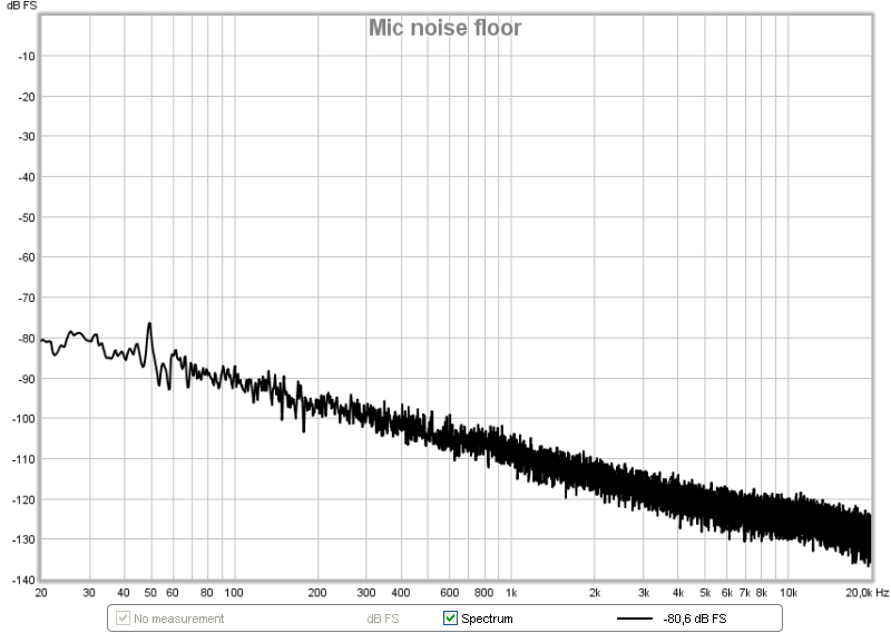

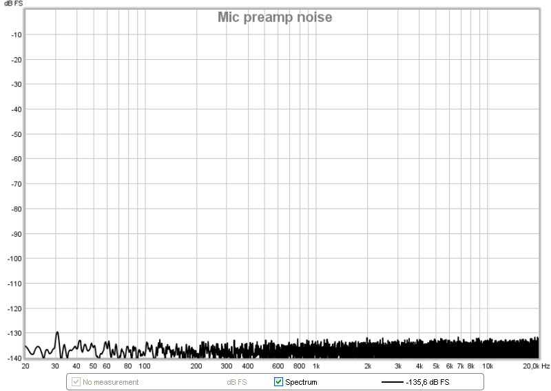

Pavel where does the rising noise floor come from?
Scott, please see microphone input (preamp, open input) noise floor itself and the same with phantom-powered ECM8000 connected. IMO it is the capsule noise + noise of electronics integrated in the ECM body.
That certainly makes sense but an isolation chamber would give a definitive answer but this certainly is not a problem in proving your point.
