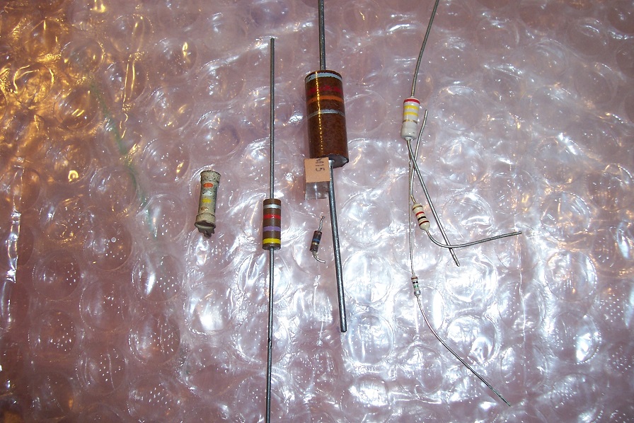

Carbon resistors exist in at least 3 flavors: the oldest is a sintered rod made of a mix of carbon, mineral binder and filler. Exists with metallized, tinned and soldered terminations or pressed brass machined ends.About carbon resistors
The "Carbon Composition" type is based on thermoset compounds: pure for the outer envelope, and mixed with carbon and filler for the active inner part.
Carbon film are the ones described by Fdw.
From left to right:
-A relatively recent example of sintered rod (earlier types were much older, >60years ago, and much larger)
-4 examples of carb-comp, including the ubiquitous 1/2W, a rarer parallelipedic type, a 1W, and one of the nastier example: a 10 Meg-1/8W (which has probably drifted to 15 Meg, in spite of its very optimistic 5% tolerance)
-3 examples of carbon film resistor; quite stable and reliable compared to the two other types
