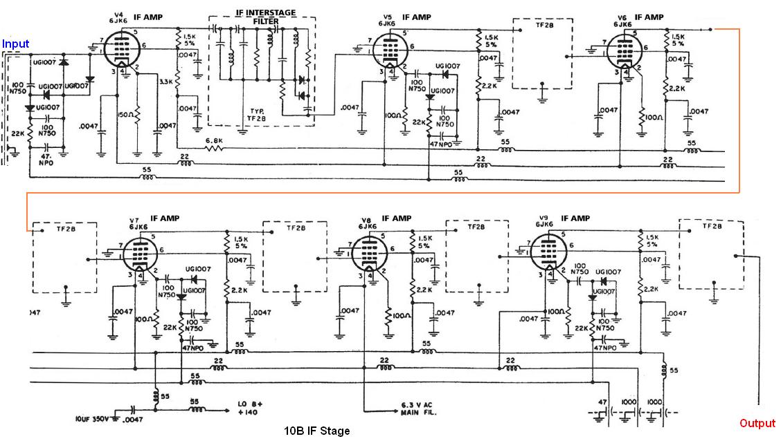

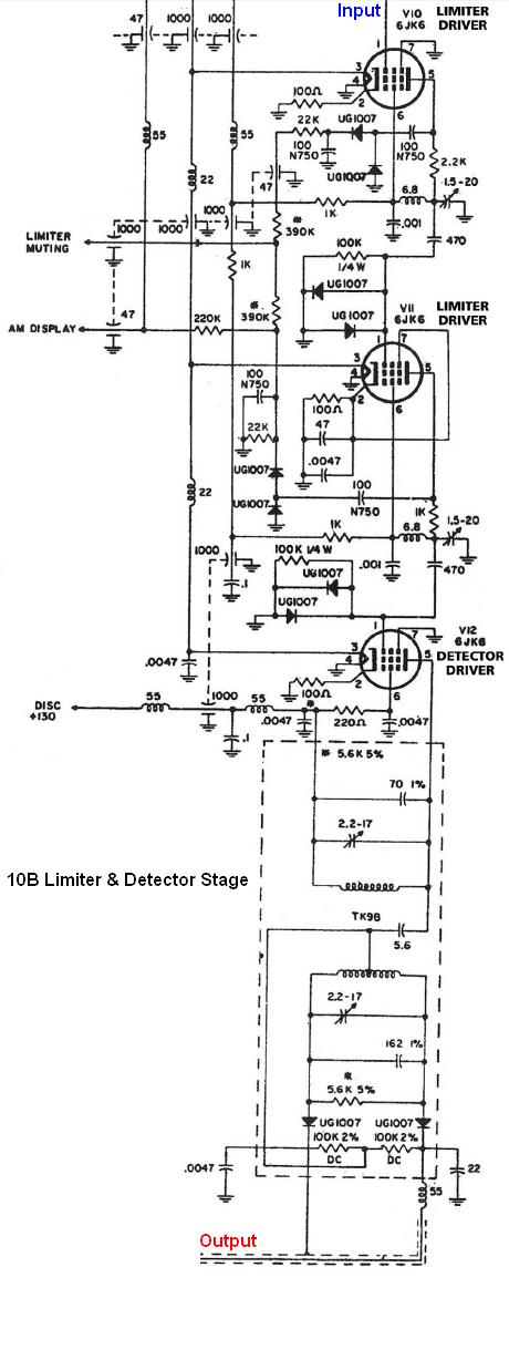

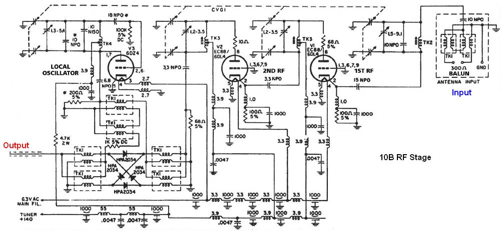

The CRT is only an expensive way to build a multi indicator (*). The technical beauty and real value of the 10B tuner is in the (complex) tuner circuitry and (surprise!) in the attention to mundane points.
Please notice the meticulous B+ and heater lines decoupling where it matters.:)

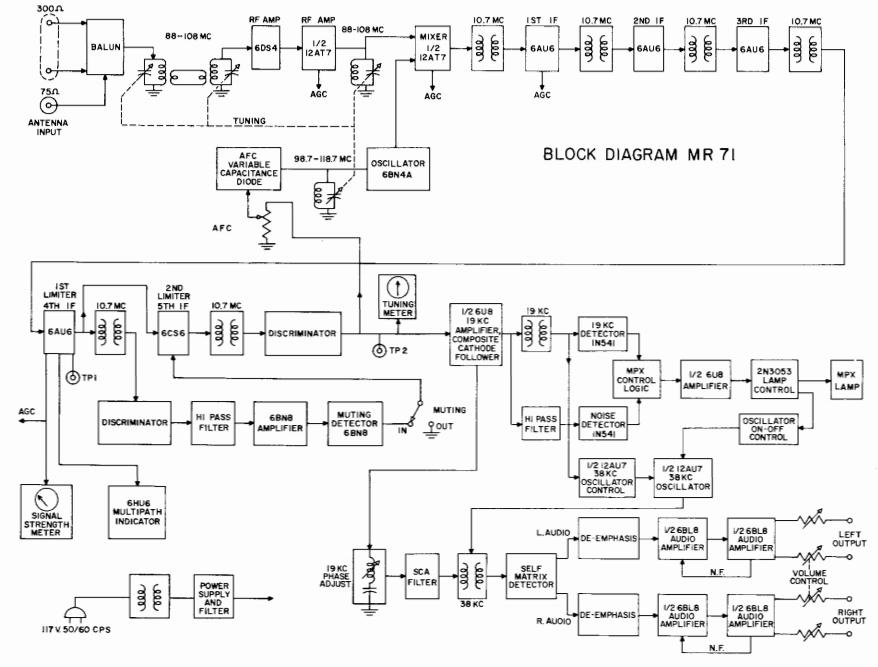

What would be so different in the 10B tuner than say the tube McIntosh MR71 tuner that I have or the later SS model mentioned earlier and the old SAE II tuner that I sill have sitting on a shelf? Both of these tuners have been some of the best I have heard that actually can discriminate between adjacent stations and lock on a signal. What makes the 10B such a unique tuner vs many others such as my Mac or say some of the older Fisher tuners of old?

If 10B and MR71 are well maintained, there will be not much difference btn these two. But the 10B has three optocouplers which fade with time and degrade the performance of the tuner.
In general, there can be no simple answer to the question ‘which tuner should I choose’ (and IMO tuners are much more complex and demanding compared to RIAA preamps)
The most important of all the criteria is what are the reception conditions and requirements at your location.
If you live in a remote area with a few FM radio stations far away from you which are not close enough in frequency, you will mainly need a simple tuner with good front section sensitivity and low noise plus a good rotating directional antenna. If you live in a metropolitan area with too many FM strong and week stations closely spaced, the requirements are tough and you will have to worry about front stage overloading and selectivity, LO pulling, IF selective bandwidth, much of image and AM rejection ect, that is, there is a need for a complex and well engineered tuner.
Block diagrams and detailed circuit diagrams will tell a lot. Then construction details, then specs. A good site for tuners info is Tuner Information Center - Vintage Stereo Tuners
