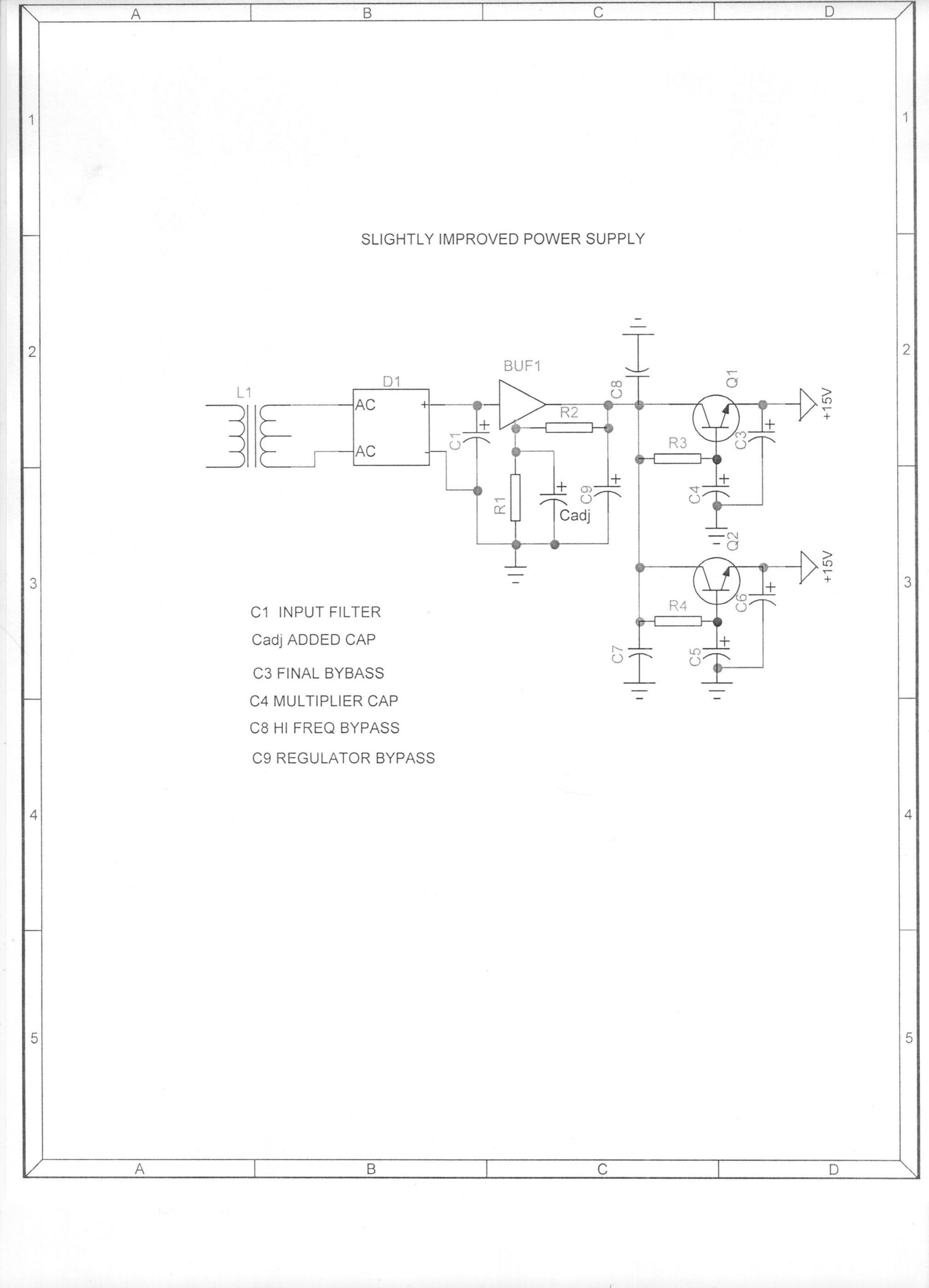

Trudging on. '-) We have a simple schematic for an audio regulator, but no values as of yet.
Generally C1 should be between 1000uF and 10,000 uf. We found that more capacitance sounds better, I think it is because of the improved 'ground return' that the larger cap gives. Of course too much capacitance and we stress the transformer and generate noise that will come out into the line and make trouble for other components.
Cadj, and C9, can be 10uf to 100uf typically. This is consistent with the 317 app note or data sheet. Works pretty good, except for noise and transient response.
C4 should be 50uf to 220uf, depending on what will fit and what you have around, not too critical.
C8,C7 is for high frequency stability of the cap multiplier and is usually around .001 uf.
C3,C6 is up for debate. Should it be large or small? Later I will show how to make it small (0.1 uf) It takes circuit changes though to make it work right. This example is typical of the JC-80, and a couple of master recorders, and a couple of mixing boards made between 1977 and 1984.

John I asked it before - what's that buffer doing? To me it looks like it just replicates all rectifier ripple at it's output - that's what a buffer does, no?
Or does it anything else?
What chip is it?

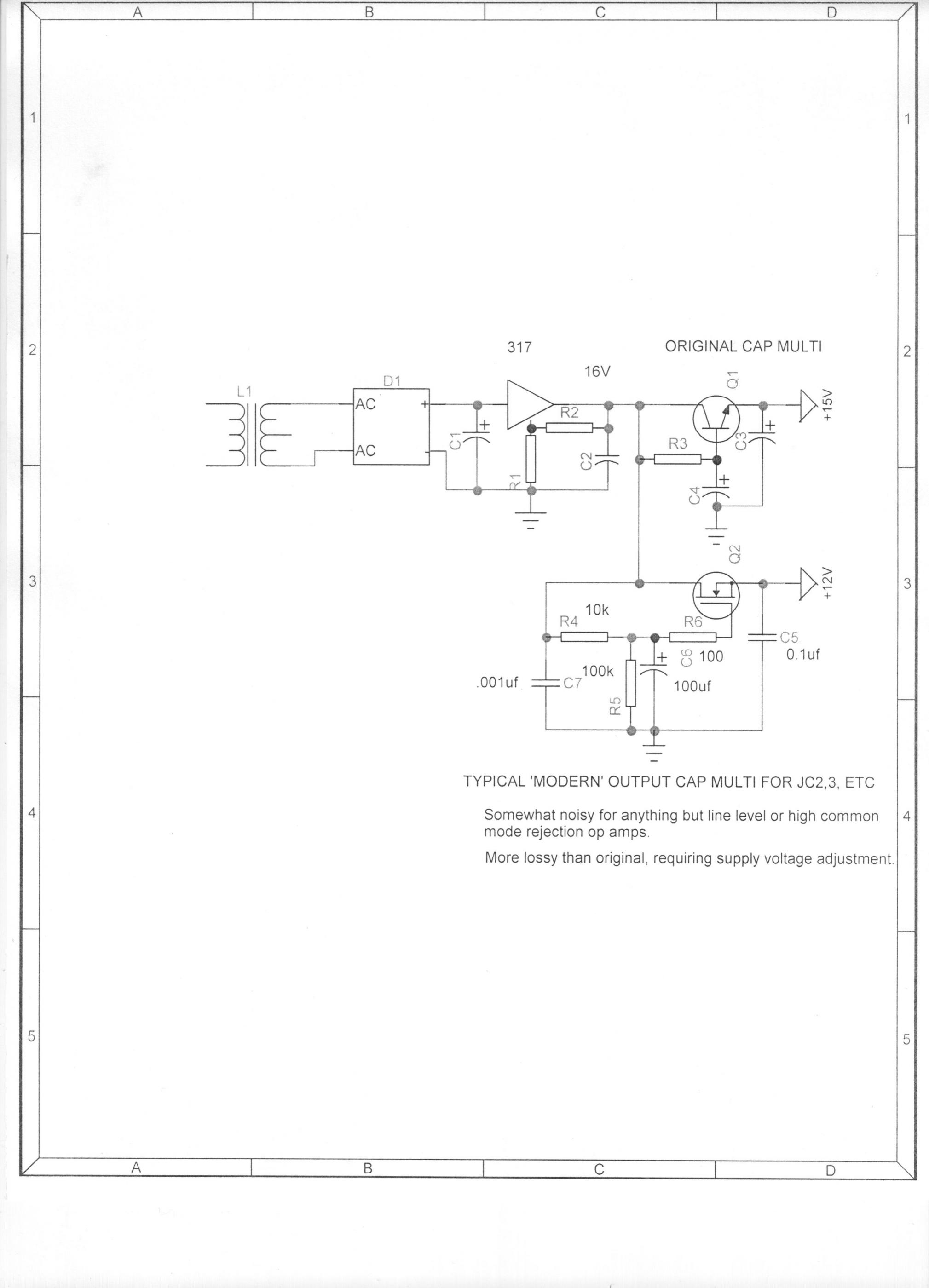

Edit - ahh - you changed the circuit - the 'buffer' is now an LM317. Sneeky :)
Looks like whoever drew that circuit is symbol challenged :)
