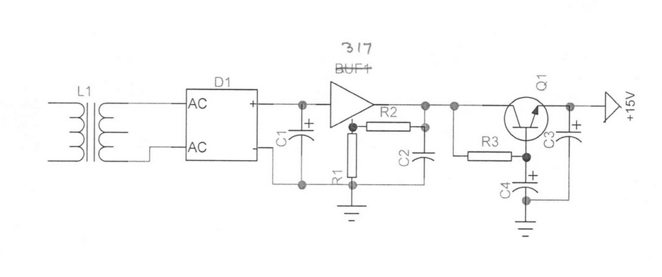

I know that many of you are virtually experts in power supply design, but I would like to go back and explain a few details for everyone else. What I consider most important is not the 'engineering' but the 'covering the bases' for a successful audio supply. Let's look again at my original simplified schematic:

Here are my thoughts on Curl's PSU:
Noise: The LM317 is noisy but most of that is filtered out by the C-multiplier. The noise of the C-multiplier approaches the lowest you can expect without rapidly inflating parts count. Low-frequency noise can still be significant unless C4 is made very large.
PSRR: The LM317 provides basic PSRR and constant voltage functionality. At AC, the C-multiplier will usually have much better PSRR than the LM317 at RF, and will have no more PSRR than the LM317 in the audio and ultrasonic range. In combination a very wide spectrum of noise has been effectively filtered out. Input transients can still cause the LM317 to act up, and if so, then better PSRR will be achieved by putting the C-multiplier before the LM317. The C-multiplier will protect the LM317 from the input transients which overload it's feedback loop and cause it to generate noise and allow noise through.
Output impedance: The C-multiplier will have the same output impedance as a diode with the same forward current. It will be much larger than the LM317, so if output impedance is very important, then having the C-multiplier after the LM317 can be a disadvantage. At the same time the enormous output inductance of the LM317 resonates with lytics and causes noise peaking in the audio or ultrasonic bands. The C-multiplier does not have this problem and it's relatively high output resistance tends to have a dampening effect on any resonances on the rails.

That is a good summary, keantoken. The relatively high output impedance of the follower can be made less important by paralleling cap multipliers for each gain block, rather than using a single cap multiplier. In fact, the cap multiplier can be part of each individual gain block, so that it buffers the audio gain block from any outside rail pickup.

LM317 is noisy if you don't follow Erroll Dietz's recommendations- heavy bypassing of adjust pin and output and pre-loading it to deliver current. Do that and it's reasonably quiet. If that's still too noisy, you might want to reconsider your signal circuit design- any circuit that has no PSR is questionable.
All that matters is what the overall circuit puts out. 40dB of noise reduction in the reg and 40dB of PSR is equivalent (and MUCH easier) than 80dB of noise reduction in the reg and no PSR.

Just filter the heck out of a reference voltage by a very large R - very large C filter, think 100-rds of Ks over 100-rds of uF. You wind up with basically the capacitor noise, but with almost no current producing capacity. Feed this filtered voltage reference into a low noise opamp or opamp/buffer combination to produce the desired current capability and presto. You have the best of both worlds, extremely low noise, as well as minimal Zout.
Edit: hang the opamp/buffer behind an R (10-100Ohm) C (large) filtered supply, an old Philips trick. You lose quite a bit of voltage, but that is 2nd law.

You can use an opamp to supply another opamp. So run the + supply using 1 opamp running between 0V and the unreg V+ and use the same approach on the - supply. Use a well filtered Zener for Vref.
A good opamp will get you to 120 dB PSRR at low to mid f, and 80 dB at 20 kHz.
The signal amplifying opamp also has outstanding PSRR, so when you look at the overall system PSRR, it's theoretically exceedingly good - certainly well above 80 dB across the audio band, and it can be very quiet as well.
When I talk about good opamps, I mean Scotties and LME4xxx types.
