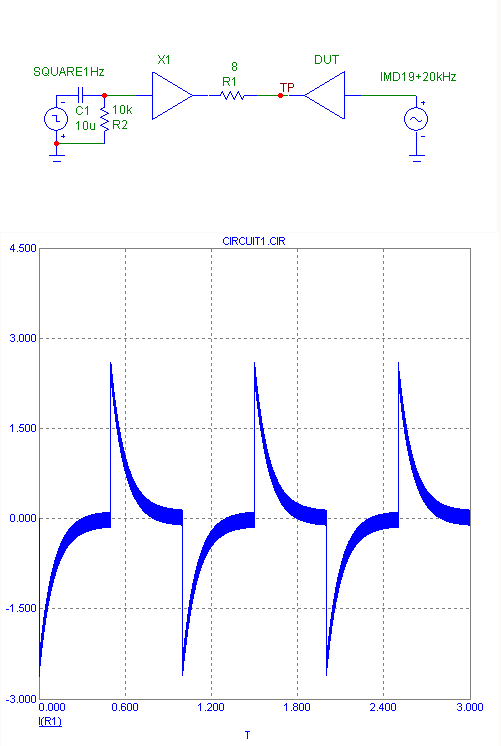

I tried test setup like attached...At TP are with "good" amp only "conventional" products of DUT nelinearity (and so a set of "static" IMD products) and products of non-zero output impedance, fluctuations caused by cycled thermal power are negligible. In my test are "static" IMD products about -110 dB, changes not more than 3-5dB. Square signal can be replaced by any other signal.
