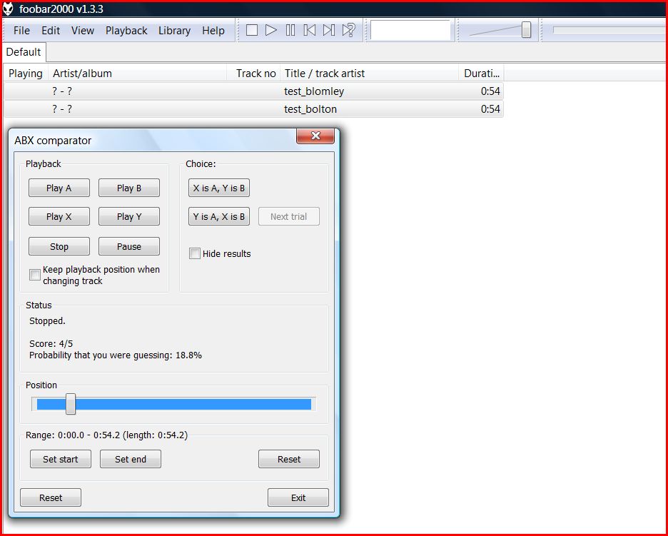

Frank, would you mind trying foobar ABX of Bolton x Blomley? Thank you.
We have had 2 results by now. Mine (negative and not shown) and Karl's (close to negative, at least).

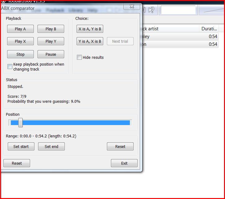

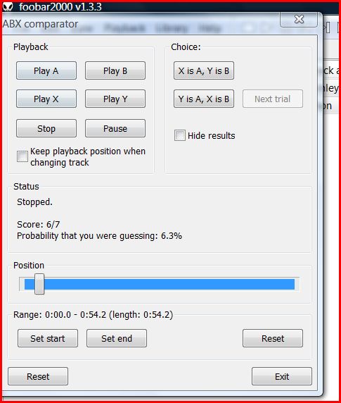

I agree that in case of slight differences it is very difficult to keep concentration and hearing resolution.
Anyway, the 50 ohm loading did not seem to introduce any harsh artifacts, in this case.
What is interesting, that sometimes people who listen with low-end equipment (like Max said, PC with 1" speakers) are able to tell the "clear difference". However, I greatly appreciate your input, that is supported with ABX foobar results.

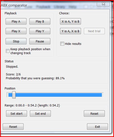

I had another go, this time using the built in speakers on my 8 yr old Acer laptop and with volume low. It all went pear shaped in trial three because I thought I was on to something in my own mind and got over excited
As a very (very very) amateur pianist who has also in the past tuned my own piano using beats and intervals I thought I would try and detect anything in that department. I used just the first couple of seconds of the track.
I would like to say (we've been here before methinks) that I was hearing something but once again maybe this just "proves" the randomness of, well, randomness and that patterns can emerge. On the other hand perhaps a little enharmonicity is creeping into Pavels loaded preamp )

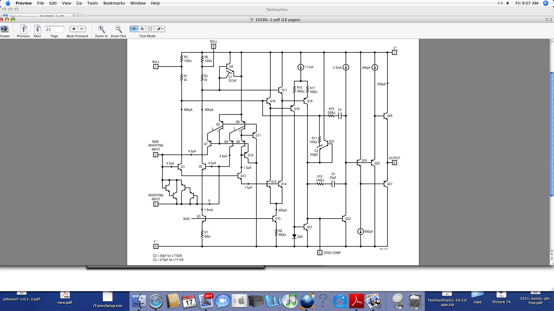

I am not really surprised that YOUR discrete preamp, as it is properly designed and has 40ma of output quiescent current cannot be changed sonically, even with a 50 ohm load, but what about an IC with 1/2 ma Iq? Yes, that is what some 'expensive' IC's have nominally as output quiescent current. That is the equivalent to a 4K load on one of these IC's compared to your discrete preamp. So, no wonder!
Now PMA, do you now feel that discrete is unnecessary and that some of the latest IC's do the job of making line and phono stages just as well?
