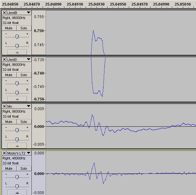

In the meantime, here is a genuine glitch in the original LT2 files - B and D differ obviously - that I'm looking at. Both DiffMaker and Audacity picked it up, and it's occurring at the peak of one of the highest amplitude swings - what's the likely culprit?
I don't know Frank. B and D were in the unloaded condition and so it seems unlikely to be a something happening at the opamp (compression or limiting).
Would probably have to suggest its something occurring in the recording and sampling process although I wouldn't like to say what. A random glitch or the pc buffering or doing something else for an instant and causing a delay or something would be remarkable if it occurred at that peak. No answer on that I'm, afraid.

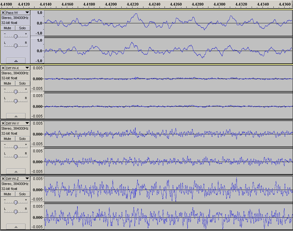

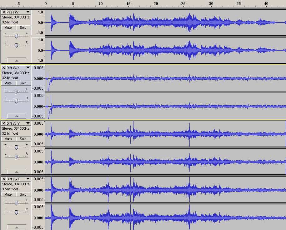

Okay, first comparisons are in on those 4 passes of recording using the same circuitry, by Karl, and, some verrry interesting results - first the bad news: the files aren't identical, not by a long shot; but, there is a pattern ...
To make things interesting, I set one pass as the reference, called it W, and generated the diff files between that and the rest, and this is what I got:
Note the sample rate, I had to oversample to this level to get clean synch'ng. Just in case one might think that the higher amplitude files are due to gain matching issues, I zoomed in at the 4.4 secs mark:
So, what guesses, etc, as to which passes W, X, Y and Z are? And what might be going on?

That is great Frank, thanks for doing that, and its great because it proves that the method used to produce the files is perhaps fallible, not perfect. And that is to be expected given that the equipment (PC, ADC etc) used is non audio based.
So where does that leave things and why is that a good thing ? Well I think because it throws emphasis back on the subjective nature of the tests and that they are really designed to be listened too. A random difference shouldn't greatly detract from the overall listening experience in the way that test driving two cars over an identical route wouldn't be swayed by one drive runing over a pothole and the other not. Its the overall impression that counts.
Those four files were produced in sequence as follows.
1/ Open Audacity
2/ Hit play on the Marantz
3/ Hit record on Audacity
4/ Save the project file and close Audacity.
Then repeat from start. No lead swapping or anything like that. Just four consecutive runs.
So either the Marantz is doing something different each run, or the PC is... or both.
The only way to nail that would be to run one player into four identical PC's all running together. That would give four different files from one playback run. And they should all be the same.

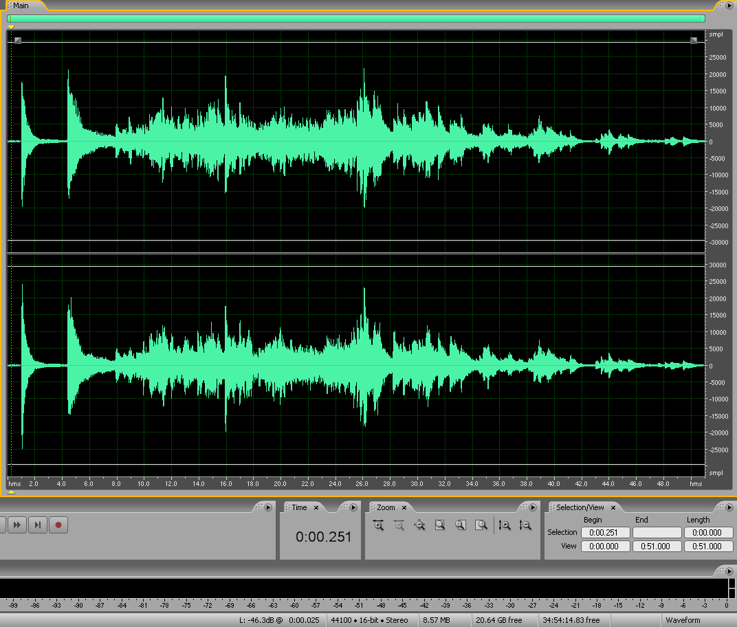

If you can match amplitudes I could do a .wav rip of the track to compare against. Would tat help ? One that hasn't been through a playback and record chain.
Done anyway
Direct WAV
Indeed it would - in the meantime, you supplied recordings 1, 2, 3, 4 - done in that order I presume - any thoughts on how that might correspond to my W, X, Y, Z?If you can match amplitudes I could do a .wav rip of the track to compare against. Would tat help ? One that hasn't been through a playback and record chain.
Karl, thanks for whipping it through - I have some bad news straight away ... the playback/record path is clipping,
Frank, this file? It is Karl's Direct wav.
