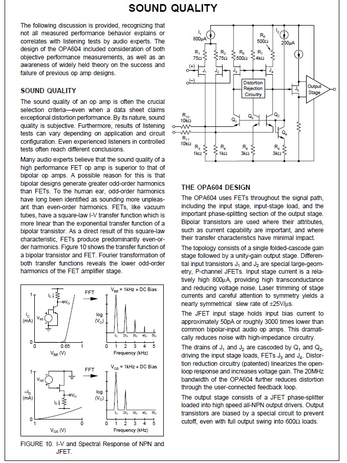

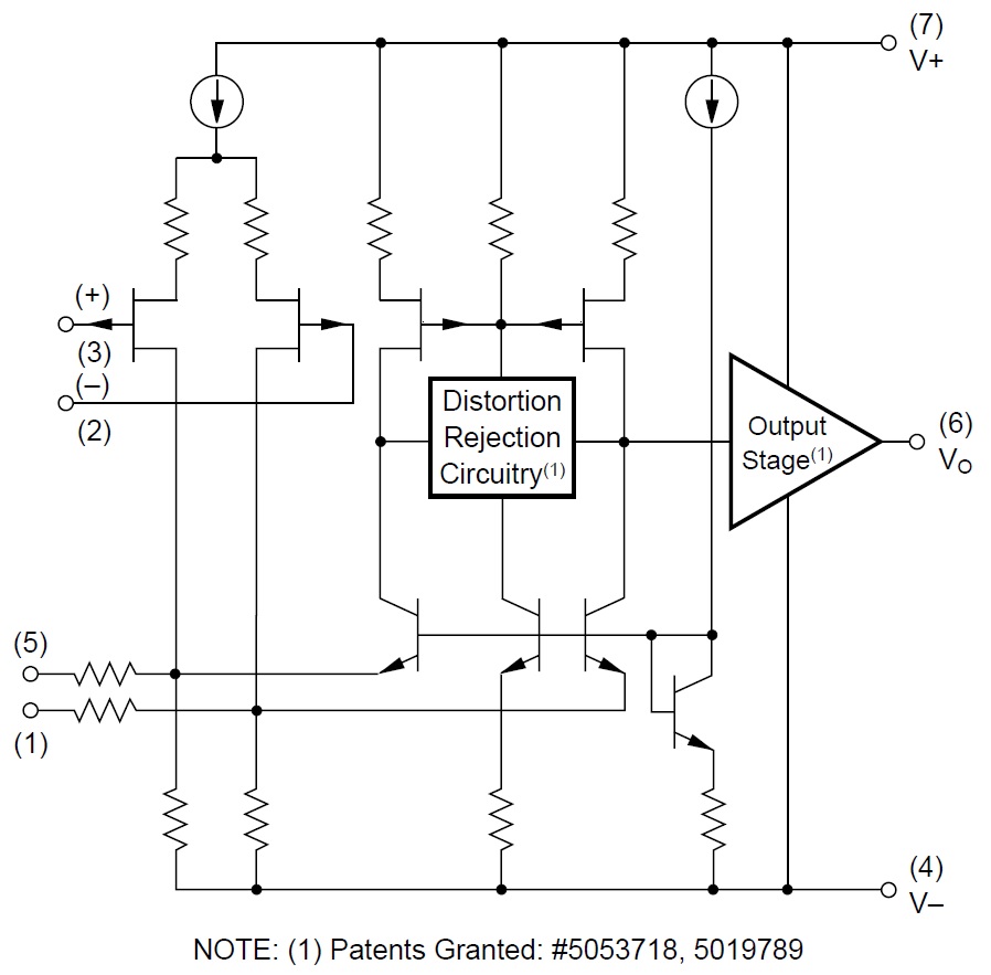

I like the OPA604. Always have done although I've recently started favouring the LM4562 as being the most transparent. That detracts nothing from the OPA though which always turns in a stellar sonic result... you want to keep listening. Accuracy and objectives vs subjectives... same old story
The OPA604 is a FET-input operational amplifier designed
for enhanced AC performance. Very low distortion, low noise
and wide bandwidth provide superior performance in high
quality audio and other applications requiring excellent dynamic
performance.
New circuit techniques and special laser trimming of dynamic
circuit performance yield very low harmonic distortion. The
result is an op amp with exceptional sound quality. The lownoise
FET input of the OPA604 provides wide dynamic
range, even with high source impedance. Offset voltage is
laser-trimmed to minimize the need for interstage coupling
capacitors.

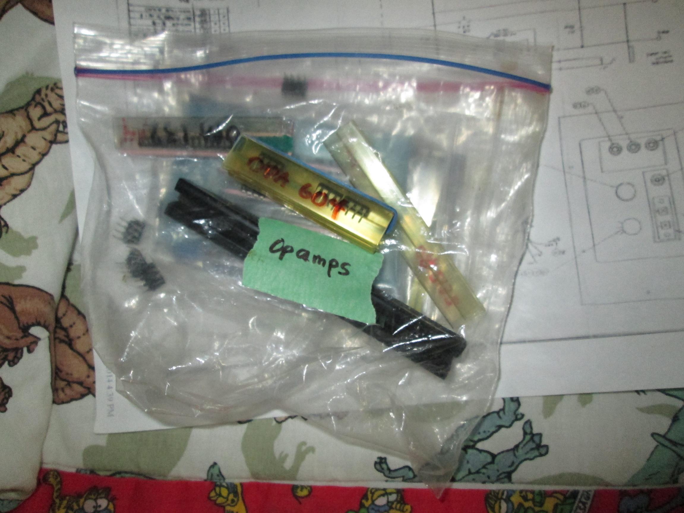

Muh-hu-hu-hu-ha-ha-haaaaa! I've got a handful around here somewhere ...
, no not snoopy, Garfield!
