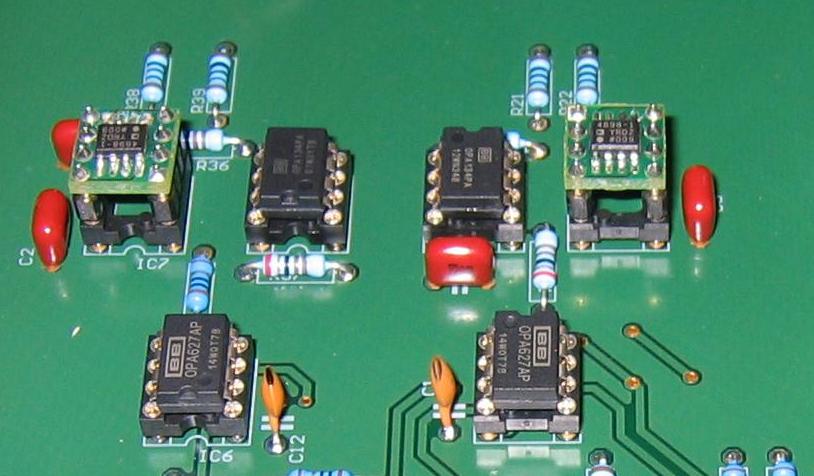

It is a fantastic IC but IIRC it's only available in SOIC - that's why I ended up going with the AD797 for my new preamp.
The ADA4898 is about 1 dB quieter than the 797 as well in the 700 to 2.5 k Ohm source resistance range.
Yes, exactly, only in SMD.
If you do not request for higher output drive capability and unity gain ultimate stability+high slew rate, then AD797 is still better regarding lower distortion.
