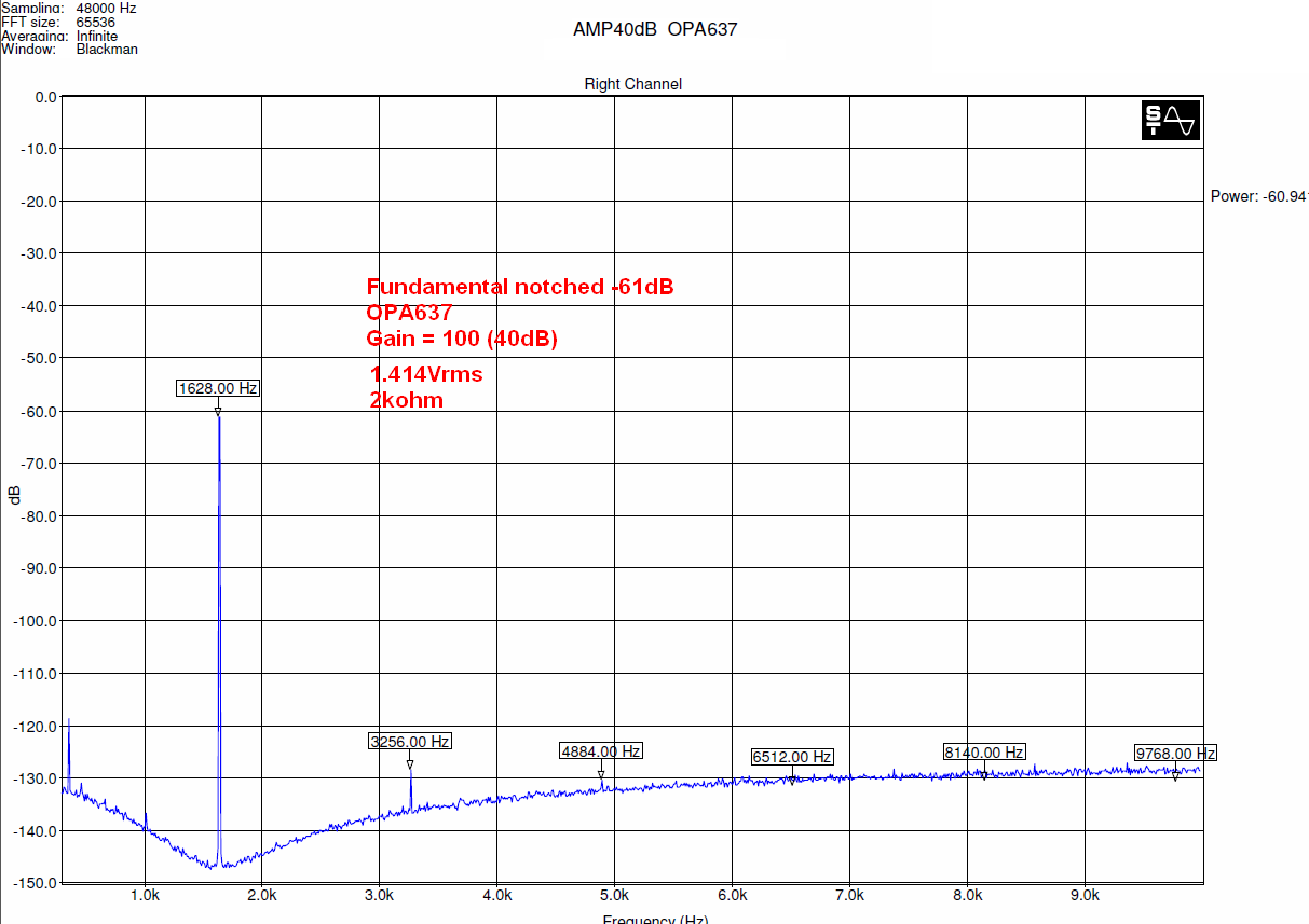

Re opamp measurement, distortion etc. - please see OPA637 at gain 40dB, 1.414Vrms, 2kohm load
P.S. Feedback resistor is 1kohm.
