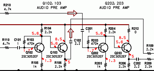

and it should be easy to improve the audio output section. That should be fun.

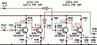

Perhaps the digital designers are not experienced in analog. This really looks like a cut and paste from a prior design. Note the 2.2K output series resistors, these allow for a Y to mono.
I just got in 4 of these for a project, they were just plain cheap! So that could also be a reason... designing for a price point.
I think the upside is that very few are scratch building any more. So here is a chance to make a significant improvement at just above the newbie level!

Nasty! That Hfe-dependant biasing is the one classified as a "disaster" in Horowitz & Hill [fig 2.19]
Beats an IC op amp, in my opinion.

I think that this stage merits a simple fet follower with one fet used as a current source load and the other as a follower. Drive cap could be reduced in value. Output cap still up for grabs, so to speak.
I must admit, I still don't think too much of standard IC op amps, even though I sometimes design with them.

Before we "diss" the designers, we should note that reports say there is enough processor noise to disrupt am reception unless you move the antenna away from the case.
The output stage has modest gain and I suspect bandwidth. An FET follower would work but with less output level.
Some of the "audio" purpose built opamps I have used would probably perform poorly due to the "hash" surrounding it.
So tweaking it is not quite so simple. I would probably use an FET input opamp with a wide bandwidth set up as a 100K or so low pass filter.
