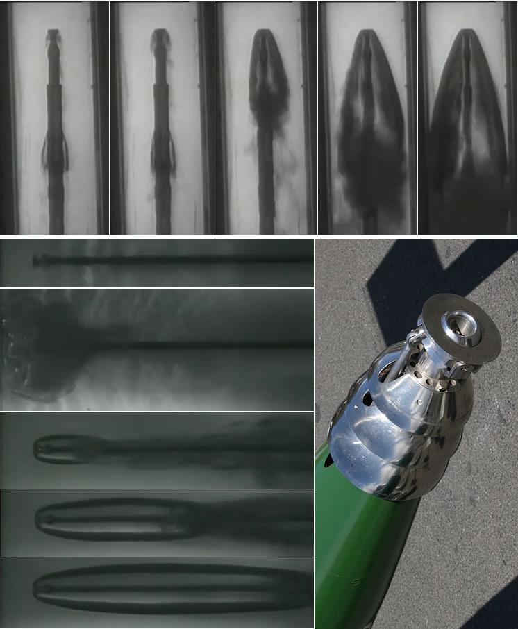

cavitation issues
You've probably seen pictures of Juliet Marine's Ghost stealth vessel in the papers.
Each of it's submerged buoyancy hulls has two counter-rotating supercavitating props mounted on the front, which dress the surface of the hulls in a shower of air bubbles.
The air reduces the drag of the hulls to a fraction of the wetted surface, which enables the vessel to reach speeds of up to 60mph, fully stable.
The Ghost basically rides on air, has two wings, and uses flaps for steering.
Pretty close to flying.

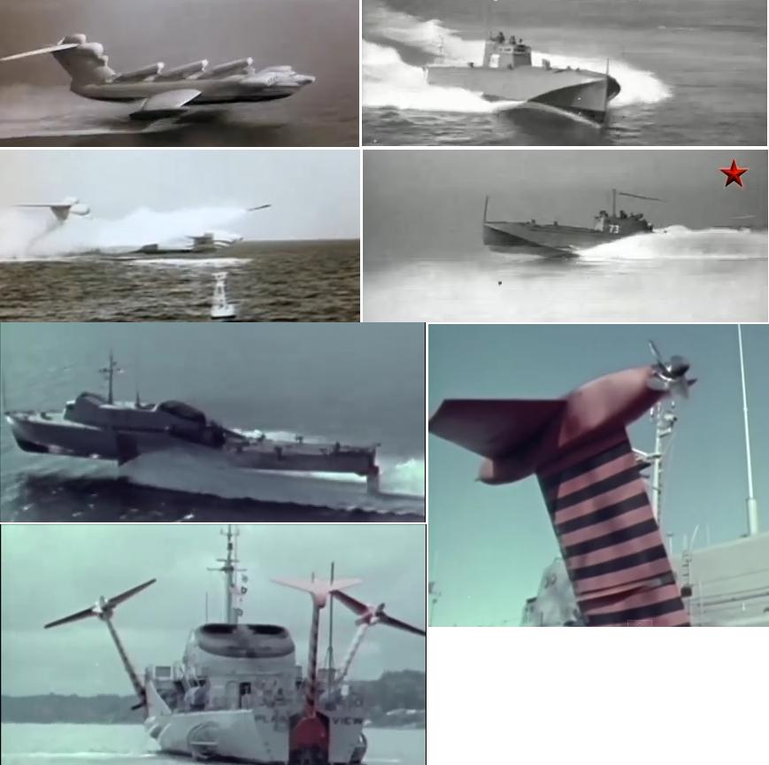

I’ve looked and looks impressive, I looked further, there is a long history behind it.
US Navy operated hydrofoils and jetfoils for V>40knots since 1963 (supplied by Boeing and Grumman).
At that time, USSR was much more advanced (R. E. Alekseev achievements since 1950).
Supercavitation R&D started in USSR ~1960, Result: VA-111 (your penguin?). In USA Gen. Dyn. (Supramar AG)~1970
George
