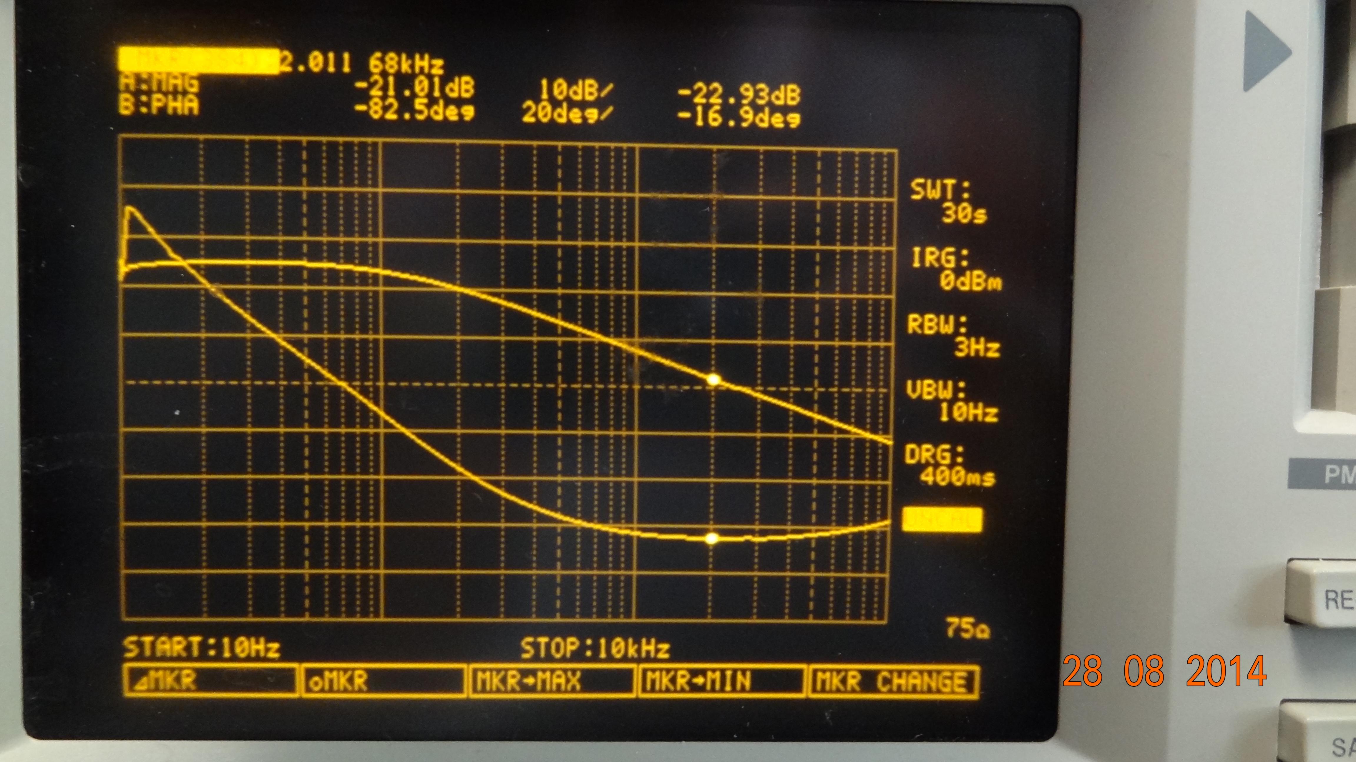

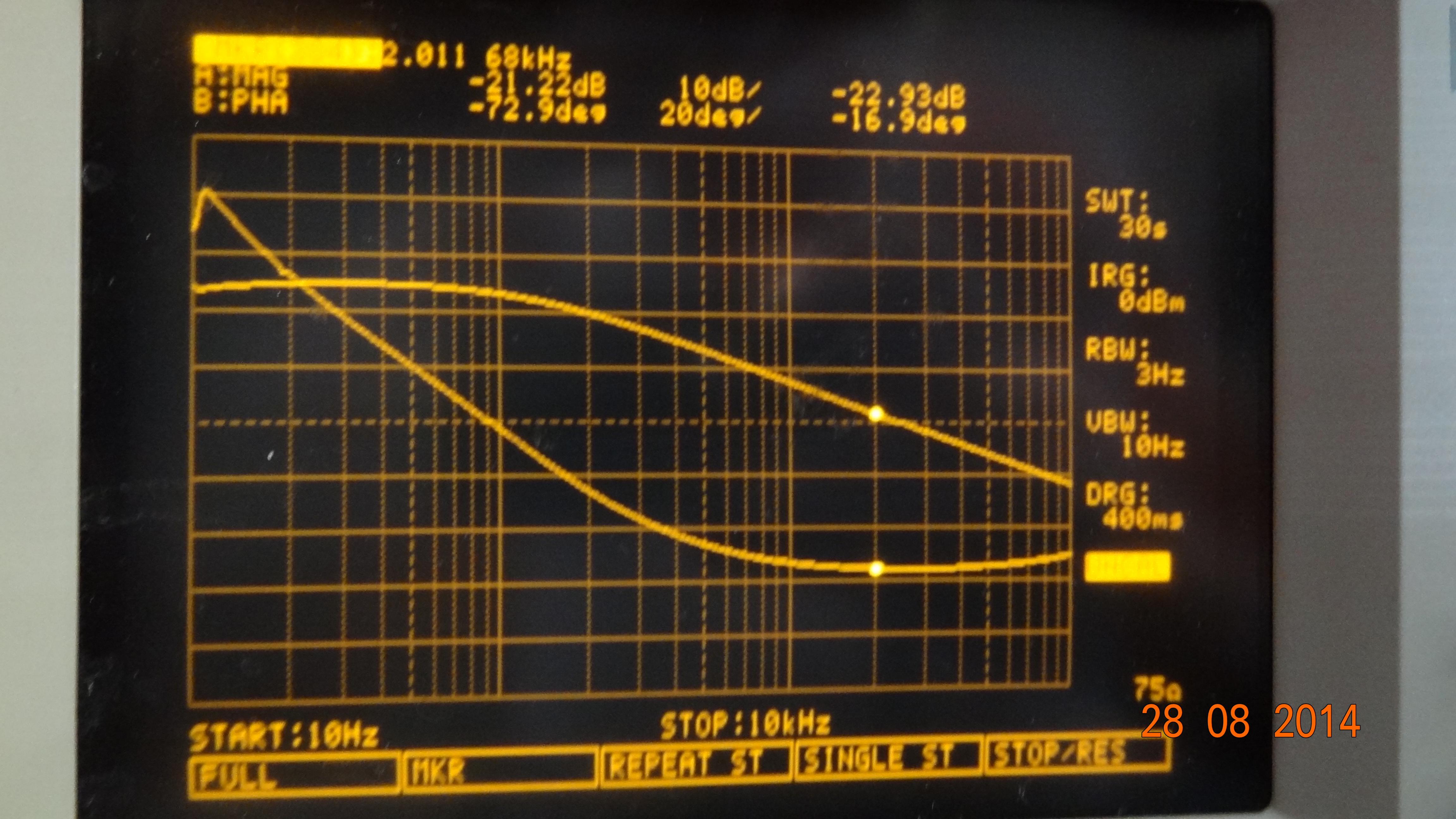

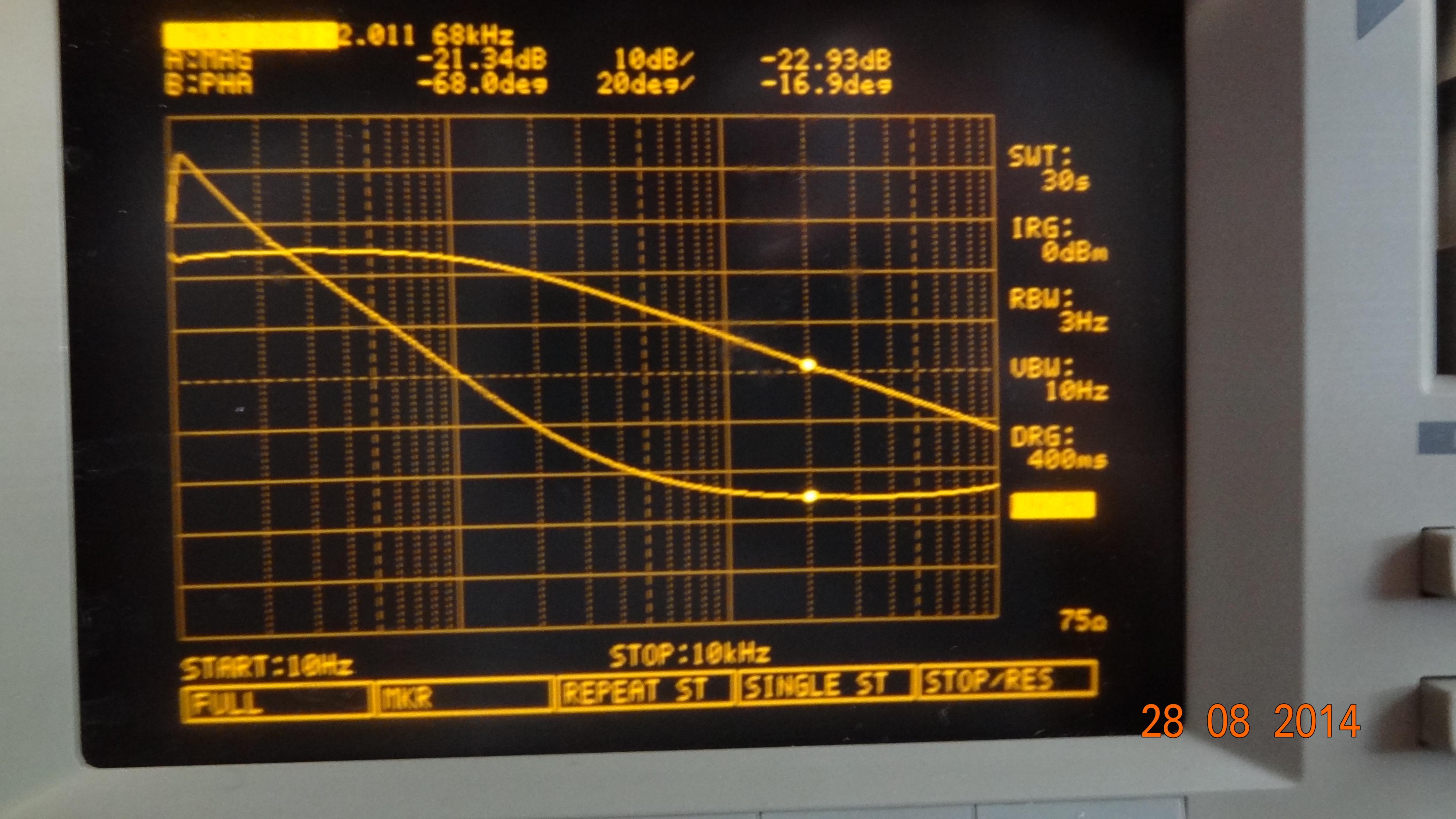

Back to C and esr vs temp affects ---
I did a quick test this morning using bipolar cap used for speaker cross overs (a new cap) -- at difference ambient cap temps..... 77 degrees F, 87F and 97F. Note the phase response changes:
C + 77F.jpg base line
Phase change with this cap is -- about 15 degrees.
Does that matter to a cross-over filter? I think so.
This is just one cap illustration.... other values give larger changes. So, this is not worse case. "Your milage may vary".
I already showed large phase changes with just a few inches of wire between cap and its load.
With this particular cap, 12 inch of wire added to cap changes the phase at 2KHz from 82.5 degrees to 52 degrees. About a 30 degree phase change!
BTW-- its the esr that keeps the cap from being 90 degrees. Its the esr that is changing the most with temp as the magnitude of the Z didnt change.
