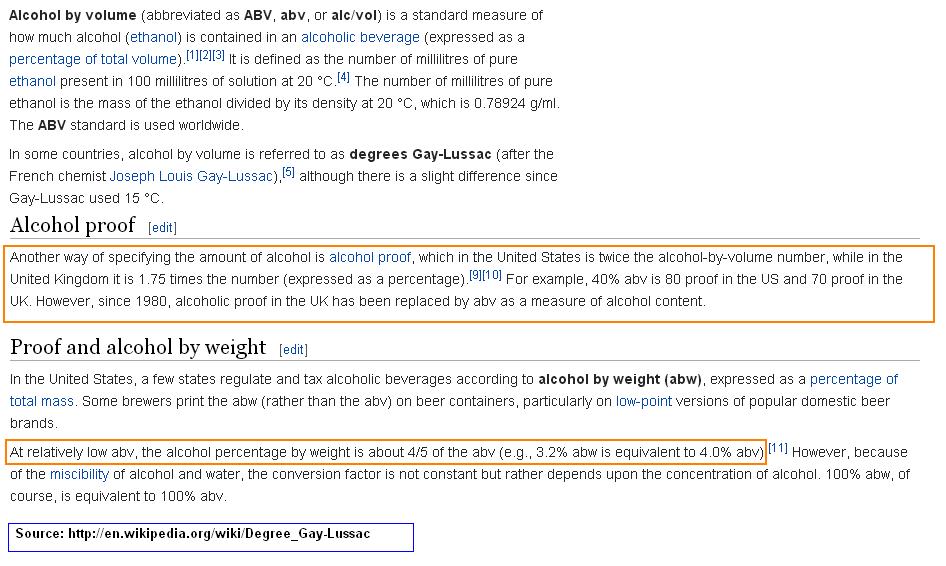

When I was there for work, I quickly learned that they do not rate alcohol content by "proof". They use the term "degree", which is equivalent to percent alcohol. Least, that's what they told me...
I had thought it meant thermal temp, somewhat like hot sake. Clearly I was incorrect.
When I was on the tarmac for the return flight, we were delayed two hours because the air quality was quite bad. It was like pea soup, but it was not fog.
jn
"degrees proof" is a common, and correct,usage. See Alcohol "Proof" and "Alcohol by Volume": Definitions and Explanations
