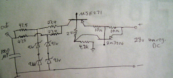

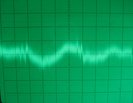

I just drew the circuit up real quick. There is a 7k resistor at the output, and a 4k resistor across the output of the unregulated 28 volt DC wall wart which I forgot to draw. The MJE271 is a Darlington, just too lazy to draw it.

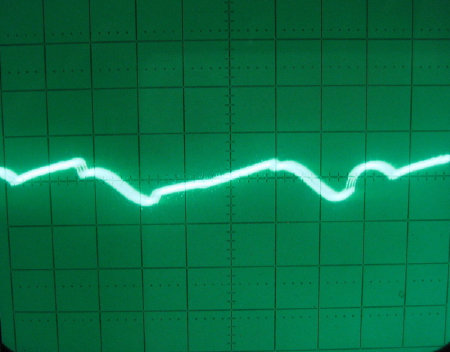

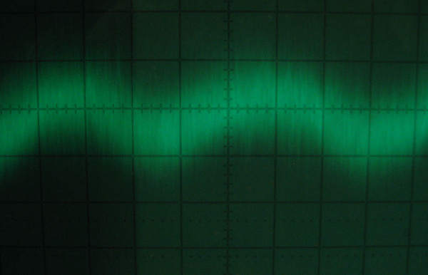

Here is the hum, though it's usually about 2 or 3 times worse than what I photographed.
And after I grab the wire of the 28 volt supply. The hum is -115dB here, I'm not sure what it is before I grab the wire.
Well, a pretty simple circuit and I got more work to do. The unregulated power supply ripple is 0.2 volts peak.

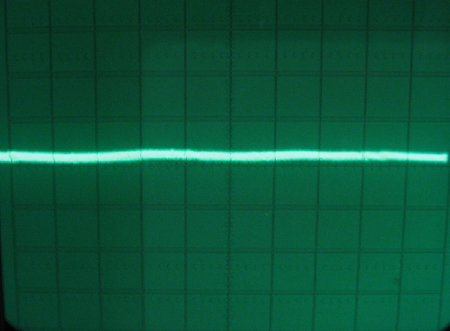

Thanks John, I tried reducing the 27.4 ohm resistors to 12 ohms and that did cut the hum by about half. The pictures I posted before didn't really catch how bad this hum often is, and the 0.2 volts ripple from the wall wart supply doesn't change either. So, there is some other problem there. This is at 0.2 volts/div after being amplified by 4,300. Hum is -84dBv.
I also had a 47.5 ohm resistor in series with the positive output of the wall wart just before the reg input, which I forgot to draw in. I put that there when reg current was only 20mA with the active shunt, but at 70mA passive it was costing me 3.3 volts. I reduced that series resistance to 12 ohms and the hum got worse.
Then I put 0.1mH of inductance in place of that resistor and got this, at 0.01 volts/div. Hum is -115dB.
Anyway, not sure what the deal is. But, the inductor seems to have fixed it.

For my money, it's oscillating at some very high frequency, which is why the effect of your finger's presence can make such an effect. 50/60Hz is effectively unaffected by such a small capacitance/inductive change, but 200MHz can be wildly affected.
Why VHF oscillation is audible at the local mains frequency I have no idea, but I first had this effect 30 years ago on a preamp stage that had ABSOLUTELY DC supplies. And some low level hum. The hum vanished when I added grid stoppers to the CF output stage, and obvioiusly killed an oscillation too high to be seem on my (then) 20MHz scope.. This has been a stable datum for me ever since, anything weird, especially weird hum that's affected by hand capacitance, first check for VHF oscillation.

I had similar troubles in diamond buffers, local oscillations at 250MHz, of some 10-20mV. It was detected by 3GHz spectrum analyzer, and as a secondary effect there was a hum increase.
@Johnloudb
Convert that circuit into emiter follower (change MJE... for NPN).
Use different biasing for 2N3906, right now you are feeding noise into it's base.
2N3906 should drive voltage reference at base of output transistor.
If you are using noisy Zeners as voltage reference, filter Vref through RC filter before driving base of output transistor. You will enjoy more
And load output with few mA to lower output impedance. Resistor + LED will be OK, you got working indicator for free

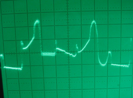

John,
Your scope pics show (apart from the low level hash) charging current pulses from rectifiers - don't know exactly what your setup is but it appears you have a ground issue. Seems there's some common grond wiring/tracks shared by both the supply and the signal grounds. Possibly the return leads to supply caps or the return to the wall-wart?

Yes, glad you pointed that out. I put a 221 ohm resistor in series with the base.

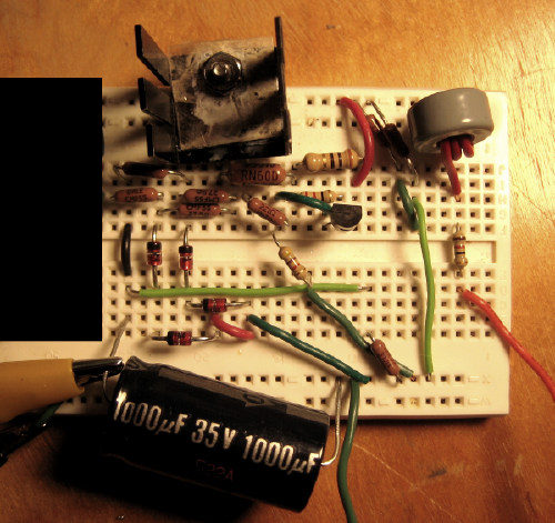

It's breadboarded, but I cleaned up the layout and star grounded. I think it helped a bit with HF noise but hard to tell, since it is close to the noise floor of my measurement setup. Other than the slight hum, I can now see no difference between the noise floor of measurement setup and the output of circuit.
I couldn't see any oscillation on my 100MHz scope, but it can be hard to see ringing sometimes.
Here is what it looks like now.
Only thing that really works to stop the hum is the 0.1mH ferrite bead choke. So, I think you might be right Hitsware, about the demodulated high frequency noise causing the hum problem.
In any case I think it works pretty good now. Or maybe I'm just easily satisfied? Thanks for the all input guys.
