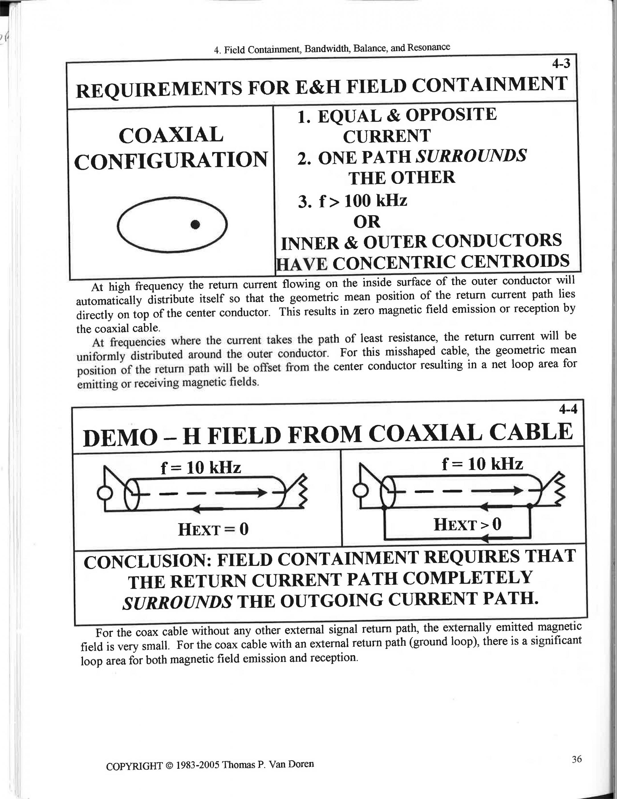

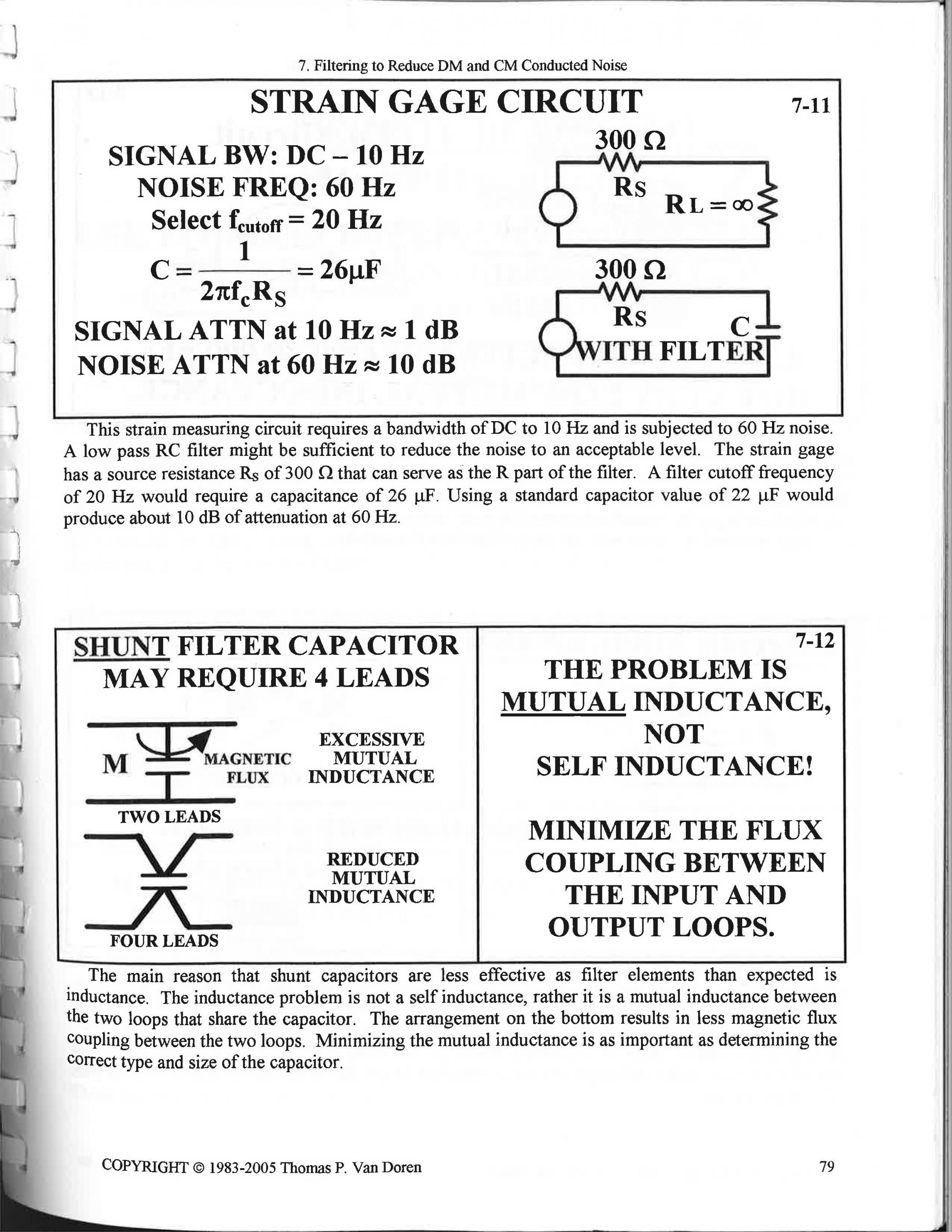

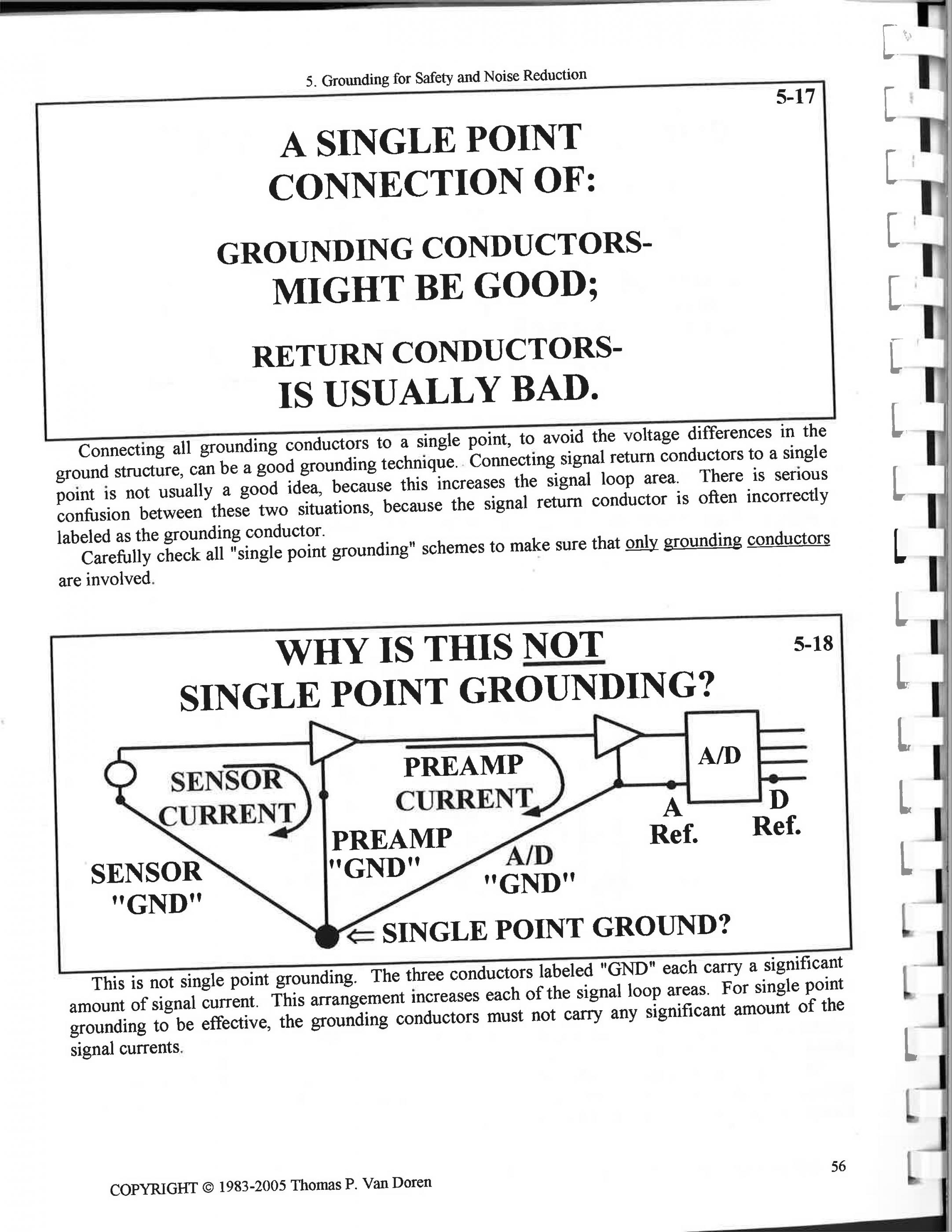

Pages of interest.
This content can be found on the web, I find it useful.
I present it only for discussion, teaching, and learning.
Attribution is at the bottom of each page.

Jn,
The second picture shows what can go wrong in connecting signal grounds, but does not offer the solution. Putzeys article in la does, for those in search of a better way. Basic setup works at any level, that is, on pcb or between components
Yup. Tom's lecture/presentation was geared towards audience Q & A. I do the same with my presentations, as I believe presenters should not simply read from the screen, but embellish. Most audience members tend to read the entire slide long before the presenter, and then they check e-mails or play angry birds until the presenter finishes reading the slide.
