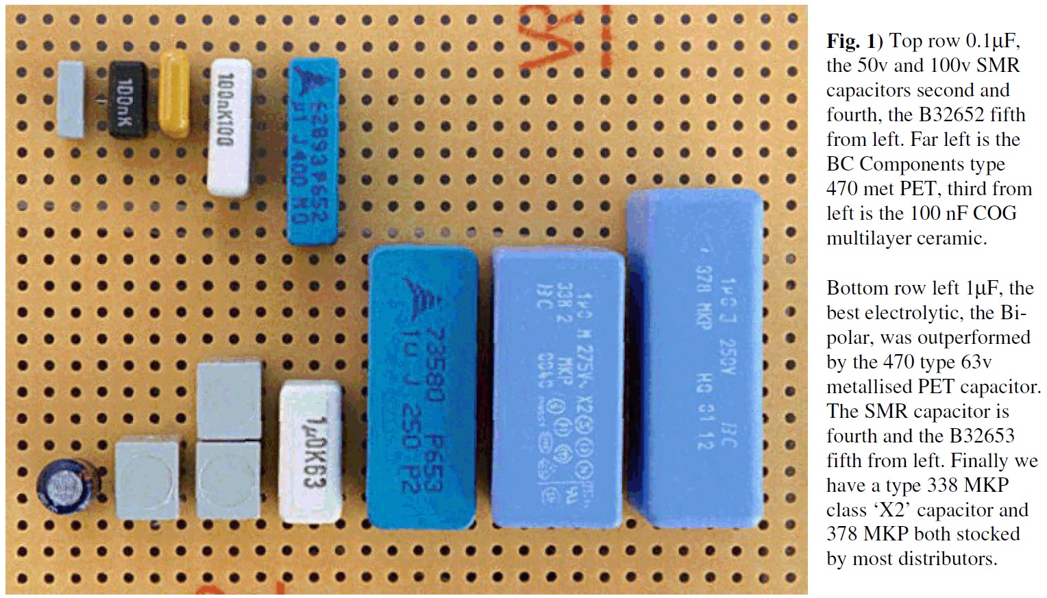

For those of you interested in 'Capacitor Sound' or lack thereof, I have posted Cyril Bateman's landmark article series on my personal website.
Thanks to Cyril and the Editor at Electronics World for making this possible!
Enjoy!
Jan
Wow, thanks Jan, Cyril and EWorld!
Here are the "straight forward" recommendations:
Cyril Bateman:
Capacitor Choice.
For the lowest distortion I still prefer PS, however from my measurements, it proved almost impossible to distinguish between an extended foil/PS and a similarly made foil/PP capacitor, apart from small increases in second harmonic, measured for the PP versions. Both types are easily available from mainstream distributors in values up to 10 nF.
For small, low distortion capacitors up to 10 nF, my personal choices would be C0G ceramic, perhaps also including discs up to N750, extended foil/PS or extended foil/PP, with the leadout wires soldered to the electrodes.
For capacitances up to 10 nF, low distortion, small, low cost capacitors are easily available, so I would avoid using metallised PET capacitors for such values. For capacitance values above 10 nF the near perfect C0G, foil/PS and foil/PP types are not easily available.
For 100 nF capacitance we find the lowest distortions are generated by choosing either C0G multilayer ceramic, metallised film
Polyphenylene Sulphide (PPS) or double metallised film electrodes with Polypropylene (PP) film.
Much better film capacitors were listed in my last article but at 1 uF, a metallised PET capacitor provides the economic choice. For the lowest possible distortion, especially with increased signal drive or DC bias, the better quality film capacitor styles shown in figure 1 and recommended in my last article, should be used.
Figure 1
100 mF choice.
Provided the AC voltage developed across the capacitor at the lowest audio frequencies is 1 volt or less and no significant DC bias is used, a double Bi-polar series pair provides an economic solution. When higher AC signal voltages, especially combined with significant DC bias, must be applied, the metallised PET combination produces less distortion. It costs eight times more and takes five times more PCB area than the double Bi-polar.
For the least practical distortion, an assembly of metallised polyphenylene Sulphide capacitors might be feasible. It needs double the board area and is five times more expensive than the PET assembly.
For small AC signals with modest DC bias and for supply rail decoupling, I choose the double Bi-polar 63 volt solution.
10 uF choice.
We have three possibilities. A double Bi-polar using two 22 uF 50/63 volt Bi-polar electrolytics, a 10 uF metallised PET or an assembly of three 3.3 uF PPS capacitors. The lowest cost solution for use with signal voltages less than 1 volt and no significant bias, is a double Bi-polar series pair.
A 10 uF MMK metallised PET takes the same PCB area and distorts less with DC bias.
The PPS capacitor assembly ensures lower distortion, especially when used with increased AC signals or DC bias voltage. However it occupies more board area and is expensive.
An assembly of Polypropylene capacitors, as used in the DC bias network, would provide the lowest possible distortion but
requires a five times larger board area and is most expensive.
For small AC signals and modest DC bias, I choose the 10 uF MMK metallised PET capacitor.
http://www.linearaudio.nl/linearaudio.nl/images/pdf/Bateman_EW_10_2002_mar2003_10_nF_and_less.pdf
http://www.linearaudio.nl/linearaud..._12_2002_mar2003_1uF_electrolytic_or_film.pdf
http://www.linearaudio.nl/linearaud..._10_to_100uF_caps_and_100_Hz_measurements.pdf
