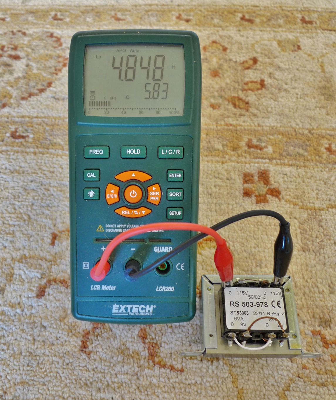

Here is one US supplier: Triad Magnetics Product Specs They don't have your exact choke but they do have a 6H 200 mA inductor. It weighs 2 Lb (1 Kg) and is stocked at Mouser for $23 ea. You are pretty assured of continuous conduction with 6H. It also has a DCR of 150 Ohms. That translates into 15V before you get to the cap. And with a choke input supply the output voltage is approx .707 X the RMS voltage going in. However $80 for two supplies for just that part quickly gets the BOM in the uber premium range. And they are not wound with 6/9 copper even. I would look for a small shop that could make a bifilar inductor so you would have one chunk of iron for both rails. Use it in normal mode, common mode won't do much.
Hi Demian,
Thanks for the link.
I checked in my transformer box this morning and found this. In my misspent past I have often used the secondaries of EI transformers as differential chokes. The drop is inductance due to partial core saturation does not present an insurmountable problem so long as the reduction is factored in.
I will test this one to see if 30mA DC in the primaries leaves me with a working solution. Anything above 2H total should be enough so that means I can withstand a more than 50% reduction.
It's worth checking because if it works it's a zero investment, instant fix.
The total DC resistance of the primary coils is about 200R.
I will be interested to check the performance of a choke vs 2 x 100R resistors. To be honest I would not expect much difference - especially as the supply will be housed in it's own grounded steel box so the actual pre-amp circuit will not be exposed to any EMR from the action of the diodes.
mike
