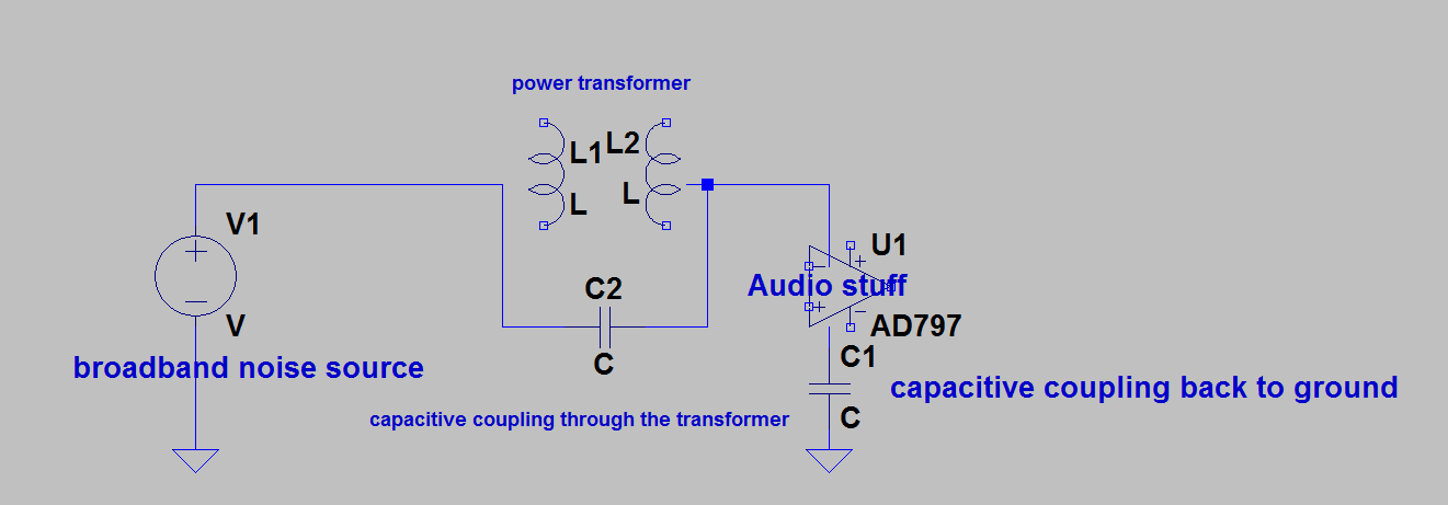

Let me try to explain why the transformers performance matters little to the common mode noise problem. The drawing below should illustrate it. Typically there is a fair amount of common mode noise on the line from emi/rfi and even power line communications. The cables in the wall and in your system can also pick up radiated noise. It may have started as transverse mode but after a few hundred feet or more there is energy between all three wires. That energy is pretty high impedance. What that means is that a series impedance won't reduce the current.
Maybe this explanation will be clearer than mine. The drawings are better if nothing else: http://www.conceptorg.com/techlibrary/PowerTechnology/Powerline_Noise_Supression.pdf
Ultra isolation transformers have dual or even triple box shields in them that use a lot of space and reduce the coupling between the coils and the laminations. This reduces the efficiency: usually a 5% to 10% loss through one. Typical isolation is in the 120-140 dB or .001 pF primary to secondary. http://www.controlledpwr.com/brochureFiles/41/Ultra-KBrochure.PDF
All the power transformers I have measured were at least 50 pF and many were much more from primary to secondary. At 30 MHz (the highest you will usually see on the power line, the losses get very high above that) 50 pF is 100 Ohms series impedance. The stuff pushing noise into the line won't see much attenuation with 100 Ohms series impedance.
My point is that providing a return path is necessary to get the noise out of the audio system. Noise filters that shunt to the chassis are the worst option for these problems. You do not want the noise getting to the chassis.
