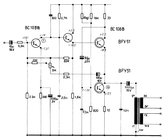

For those interested - this is the output stage that was extensively used by German manufacturers at the end of '60s.

I'm glad this circuit was brought up, it seems useful to study considering it's reputation. One thing that sticks out to me is the phase and RF behavior. In modern days I don't think anyone would accept such a result, because of what we've learned about stability compensation and RF behavior.

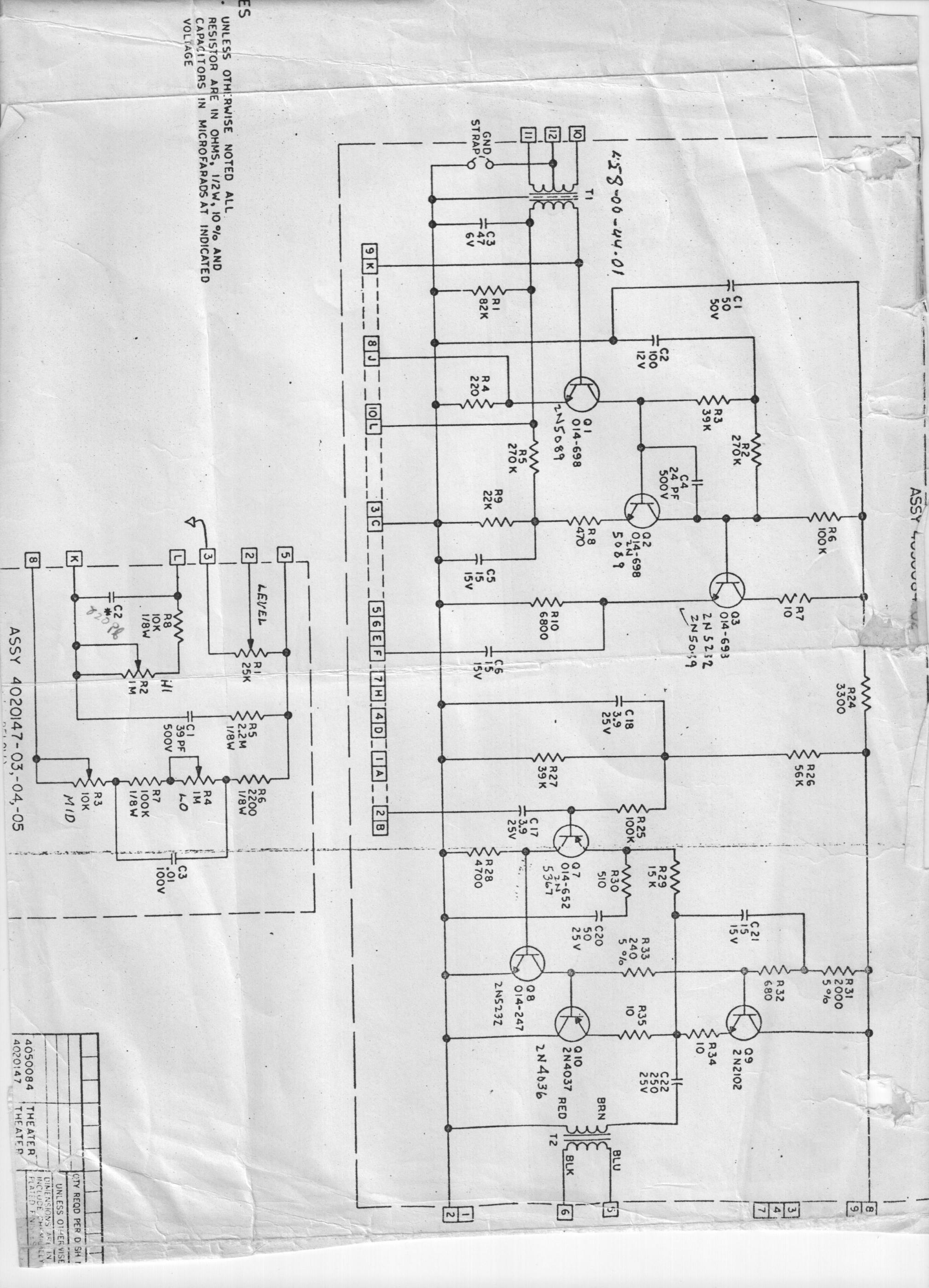

This is a typical Ampex line amp schematic, although the input transformer was usually optional. This is mid 60's, before the time that I actually worked there. However, I have made dozens of mastering quality tapes from circuits like this, and at the time, only really high quality tube circuits could beat them. Remember they are essentially Class A in operation, and they are not really OP AMPS. This is important.

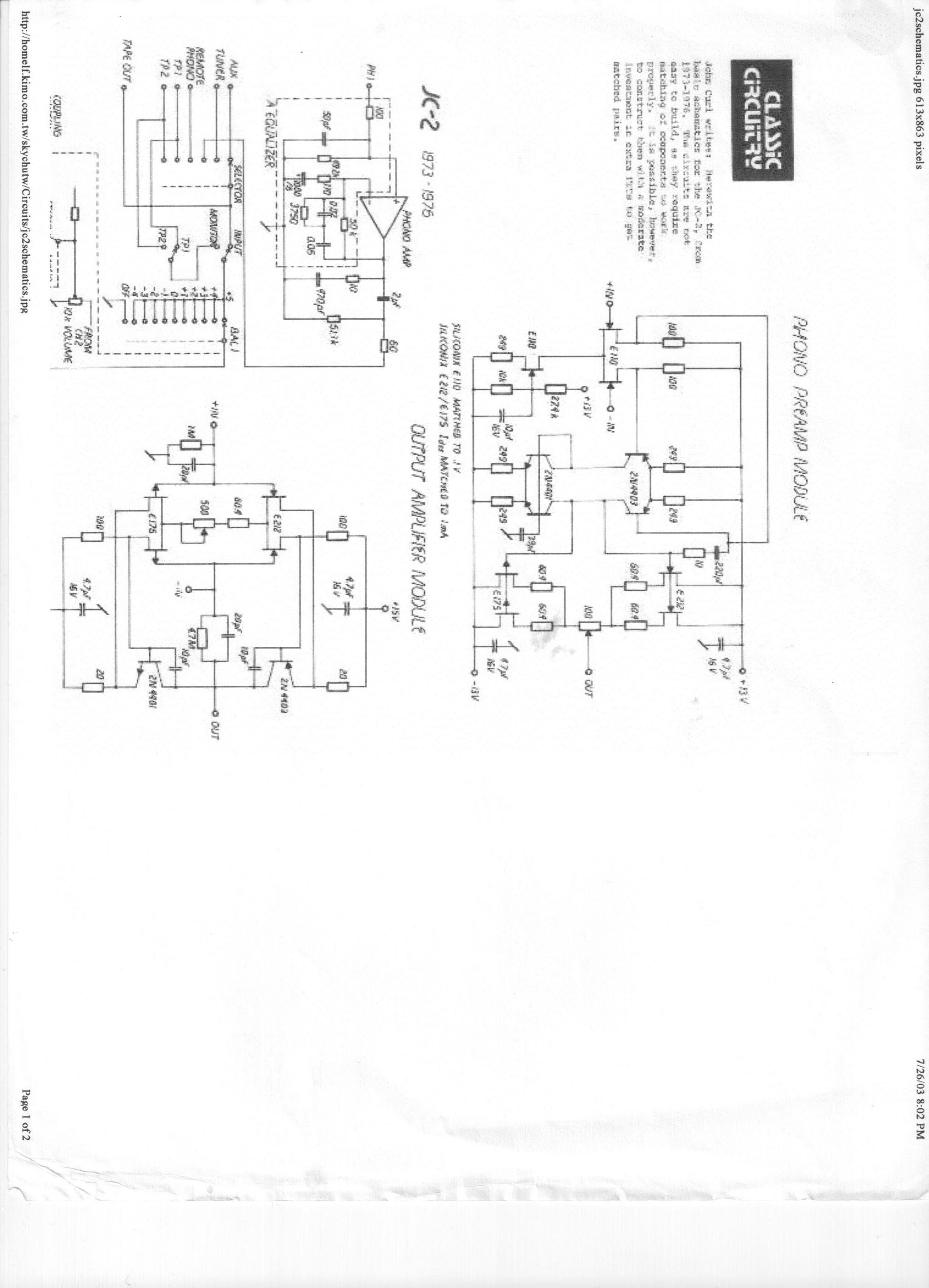

There are a few dozen 3/4 transistor circuits like this used in professional applications like the one above, and in single ended form, in commercial hi-fi. Mullard has a famous series of app notes with disc equalizers, input buffers etc as well.
There may have been a case 40 years ago to have said these sounded better than the 741, but no longer. The tide turned with the 5532/4 in the late 70s. And, opamps have not stoped getting better, while transistors have pretty much not changed.
Input noise and bias currents now better the best discrete circuits, and you have to go to heroic configurations to beat them on noise. PSRR is orders of magnitude better than discrete circuits.
