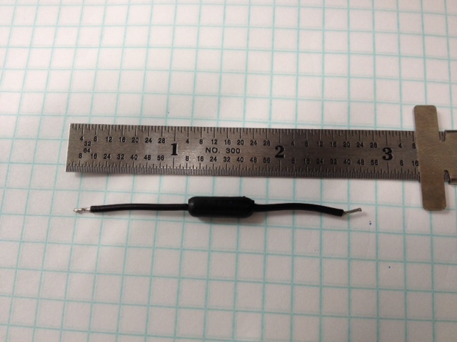

The infamous Bybee!
Thanks SY I can measure them!
The infamous Bybee!
It could also be a thermal fuse, something real.
have seen those in many Japanese gears...
But then they might cease to exist.
