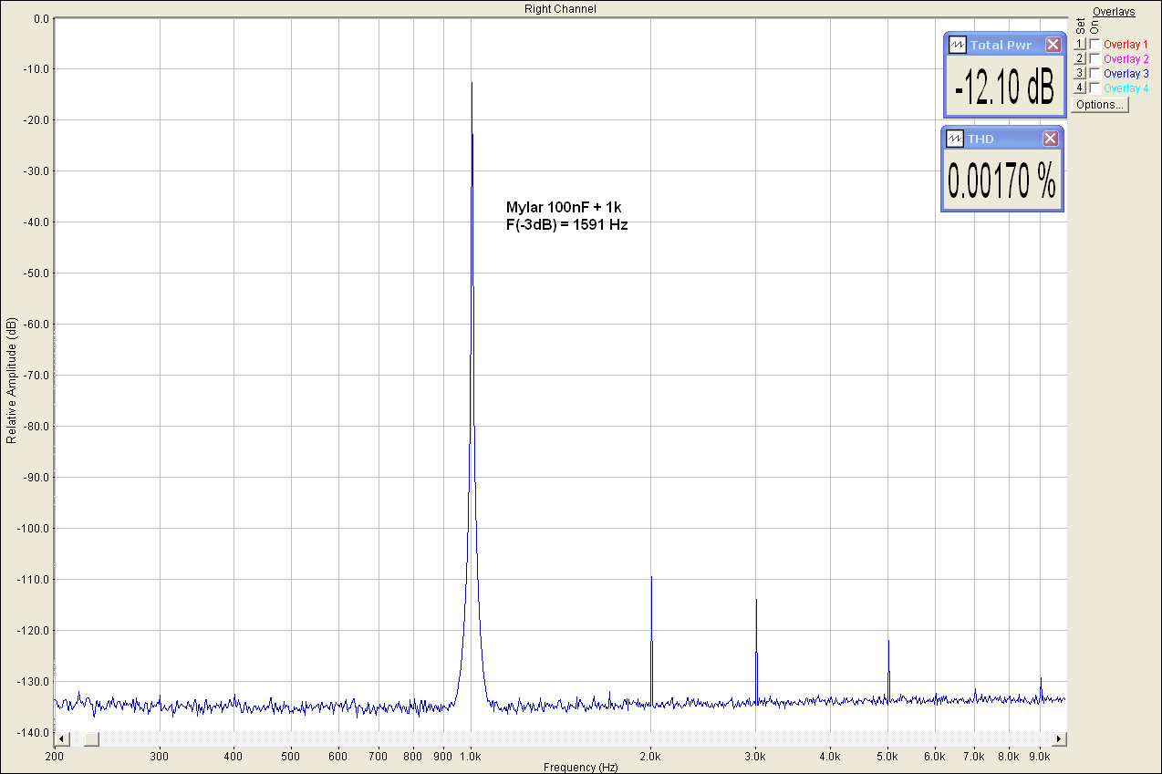

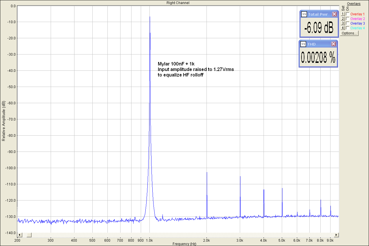

I have just tried a Panasonic Mylar 100nF capacitor.
1st, let me comment that 100nF + 1k makes HF filter, F(-3dB) = 1591Hz. At 1kHz, we have -5.5dB amplitude roll off. The capacitor is substantially loaded by 1k resistor - this would never happen if the cap was used as a coupling cap.
I am attaching 3 measurements.

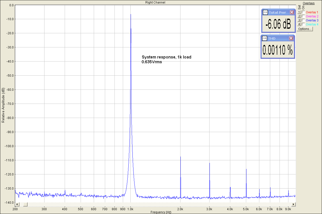

1) system distortion into 1k load. Input voltage 0.635Vrms.
2) Same voltage, 100nF + 1k load.
3) 100nF + 1k, input voltage raised to get 0.635Vrms output voltage.
At 1kHz, almost 50% of the input voltage remains across 100nF capacitor. Capacitor and 1k resistor create voltage divider at 1kHz. Nevertheless, the 100nF mylar capacitor raised the system distortion no more than 0.001%.

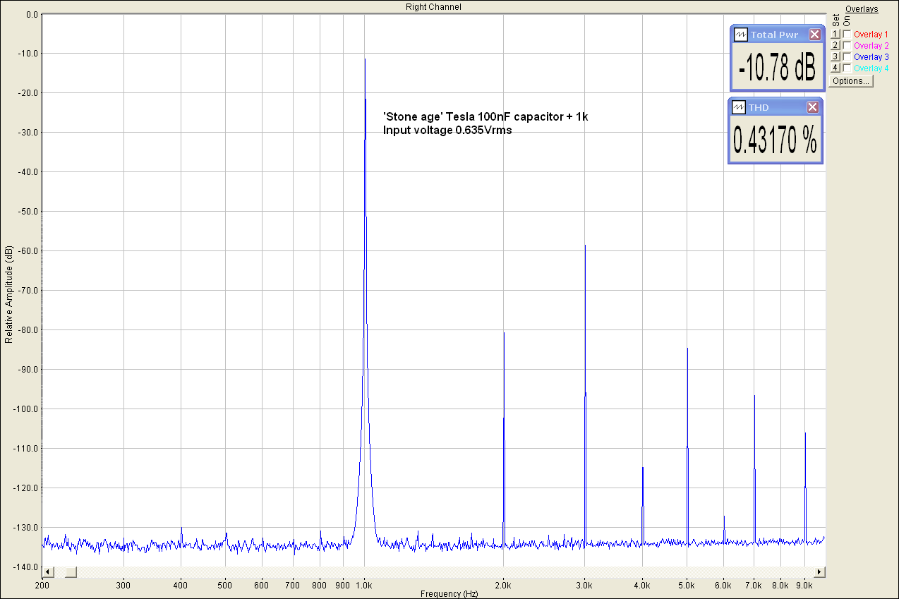

Same measurement as (2), for a 'stone age' (1975 plus minus) ceramic capacitor. We can see huge distortion, into 1k.

All this info may be easily read from datasheet non-linearity charts. The purpose of plots was different - to show that mylar would make some distortion only when heavily loaded. 100nF mylar loaded with 100k will make no distortion. And no one would use 100nF X7R ceramic as a coupling cap.

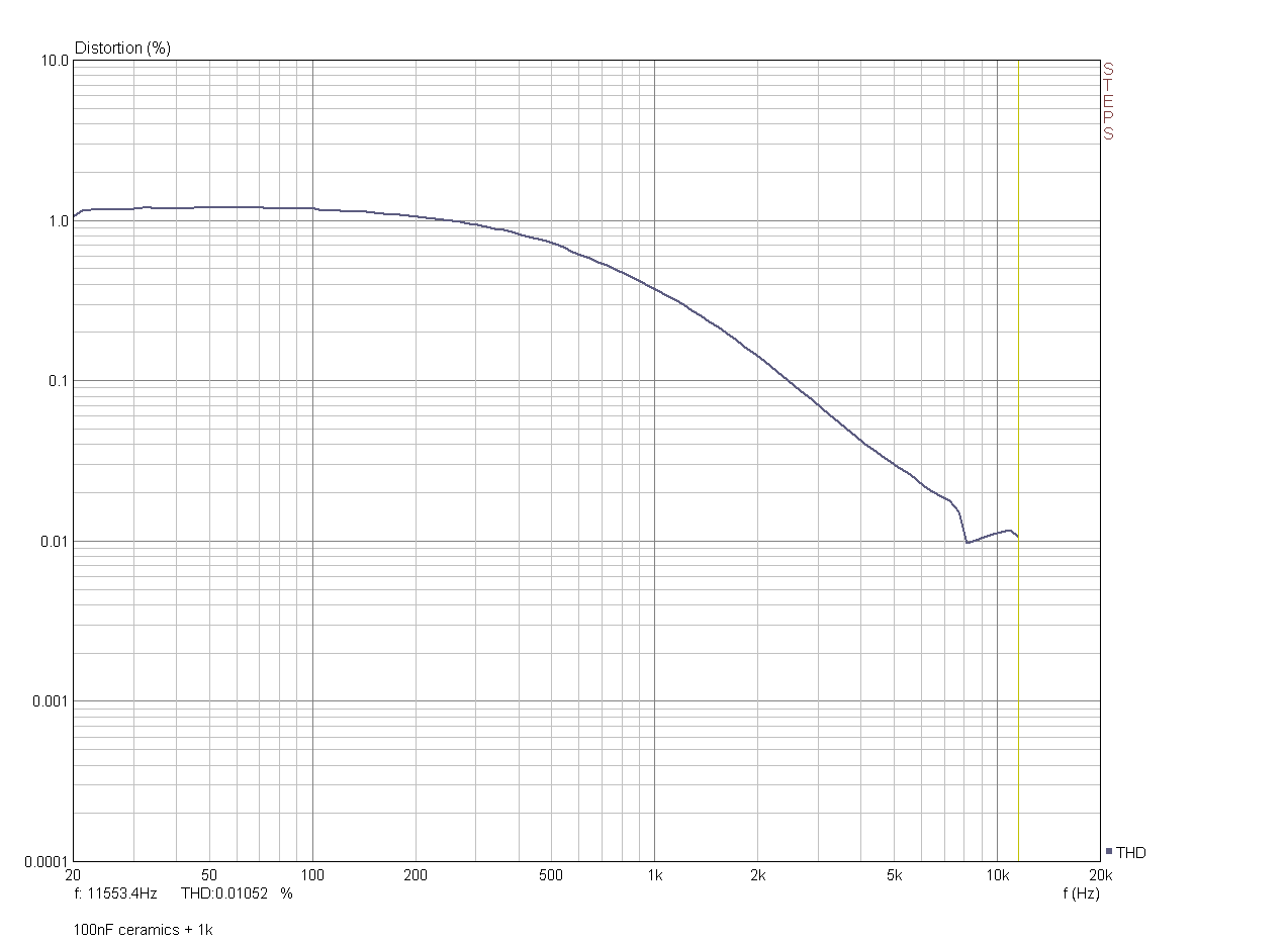

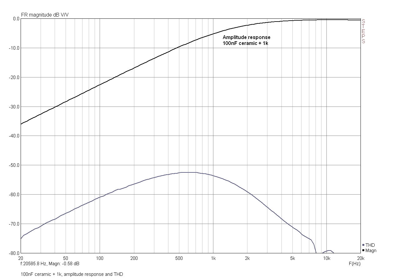

Yes, low enough Fc and avoiding capacitors like Y5, Z5, X7 etc. would prevent additional coupling cap distortion. We can see it even in case of ceramics that distortion rapidly falls down when we are moving away from Fc.

Measurement 3) would say more if it could be compared to a baseline for system distortion at the elevated voltage level.
= measurement (1). Input means input teminals of C-R, input to measurement is across R. C and R make voltage divider.
However, I am not sure why to bother with 100nF distortion into 1kohm load. This would apply only for filters of some kind, not for coupling capacitors.
PMA, not convinced, you did raise the voltage for measurement 3, so it makes sense that equipment hash generator side goes up as well, hence my suggestion to also baseline for the raised voltage.
Anyhow, I use caps in filter applications, and 100nF loaded by 1KOhm is a bit heavy, but 2kOhm loads are quite normal. So, for me, it's relevant (but no cause for worries because I came to trust a good cap).
