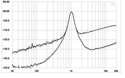

At 24 bits low level resolution is not an issue it's just a case of how close
sonically a 16 bit dithered down version comes to it's 24 bit counterpart, all
other things being equal.
I believe most mastering engineers will concur that with the best dithering
algorithms there's not a huge amount in it. Ref pic below of a VHQ DAC,
1kHz, -90dB tone at 16 and 24 bits.
cheers
Terry
I would not take the whole Mastering community as an authority here. After all, they seemed to go silently along with the con that digital master tapes for 1980 LPs were an upgrade on the 1979 releases (thinking about the Decca and EMI classical releases, anyway). Comparing those LPs today shows just how much was thrown away in 16/44.1, for any kind of orchestral or choral music.
It was all the greater pity, since the 1979 Deccas, in particular, were spectacularly improved against the year before.
