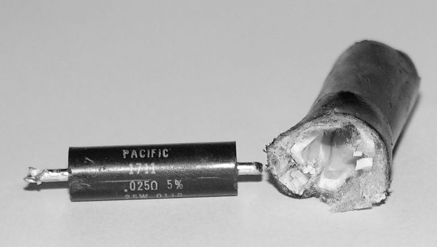

And you wonder why people think there is something wrong here? Pure BS and he knows it or should, or perhaps he really is that naive or gets some money out of this? He can not state one scientific thing to prove the things work, and others have purchased them and taken them apart and showed that they were nothing but a resistor. This is why he gets the feedback and ridicule here, sometime he more than deserves it.

Don't remember if it was Sy or who it was but if we look back months ago when this came up again it was stated they were tested and disassembled and nothing inside, just a resistor.

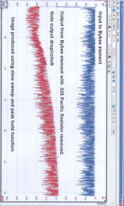

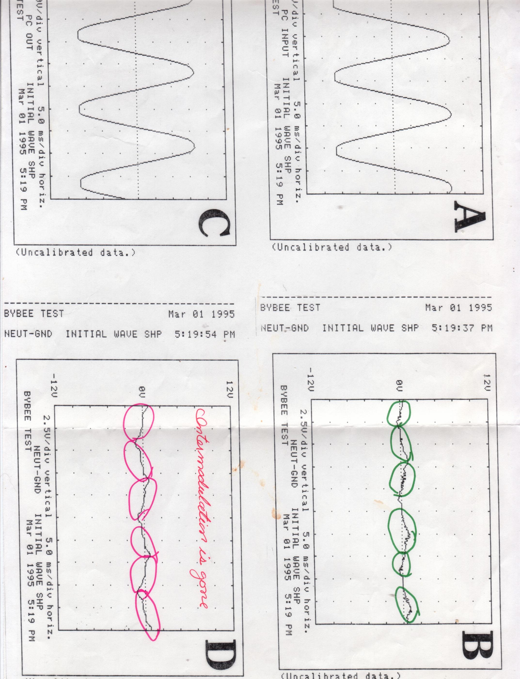

Bybee measurements:
