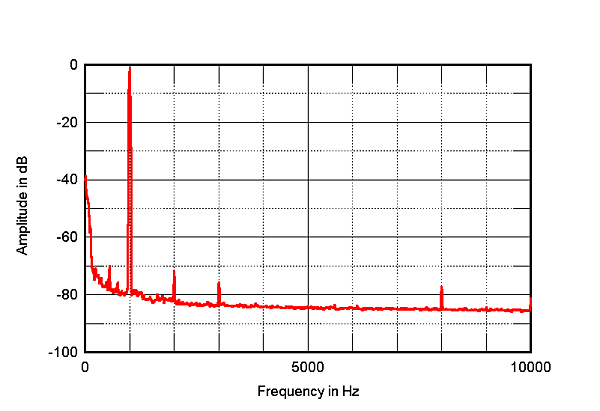

I'll go out on a limb and state the QUAD is the lowest distortion speaker ever made.
Thx-RNMarsh
This is pretty good. What is that 8th??
Has not this fetish for burn in come from burn in testing that most life/mission critical equipment has to go through, it is a part of the specification for all class 3 based electronics I have worked on, and is to stress the whole assembly at the specified operating conditions including often severe changes of temperature...
Quite a bit lower...maybe a 100 times lower than 1%.
-RNM

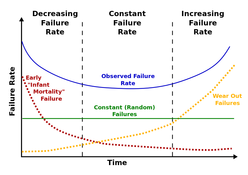

Yes it is related to the well-known (to some) 'bath tub' failure curve. Typically, electronics fail either very early (infant mortality) or very late in their life time (old age). So with burn in you want to weed out the infant mortality failings, which makes the rest work reliably for many, many years.
Has nothing to do with (sound) quality.
One thing I do find curious (or maybe not) is why burn-in always improves stuff, never makes it worse...

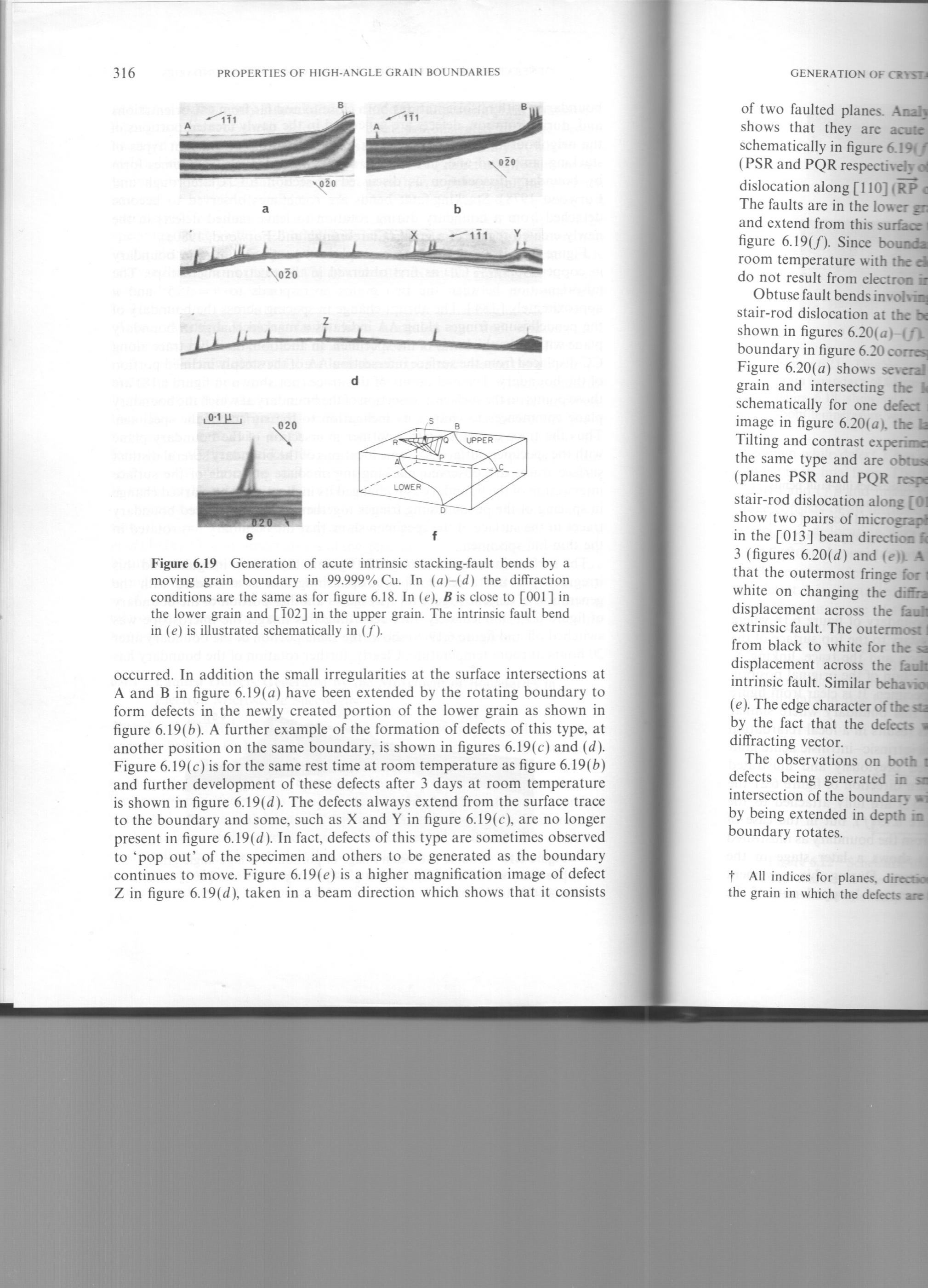

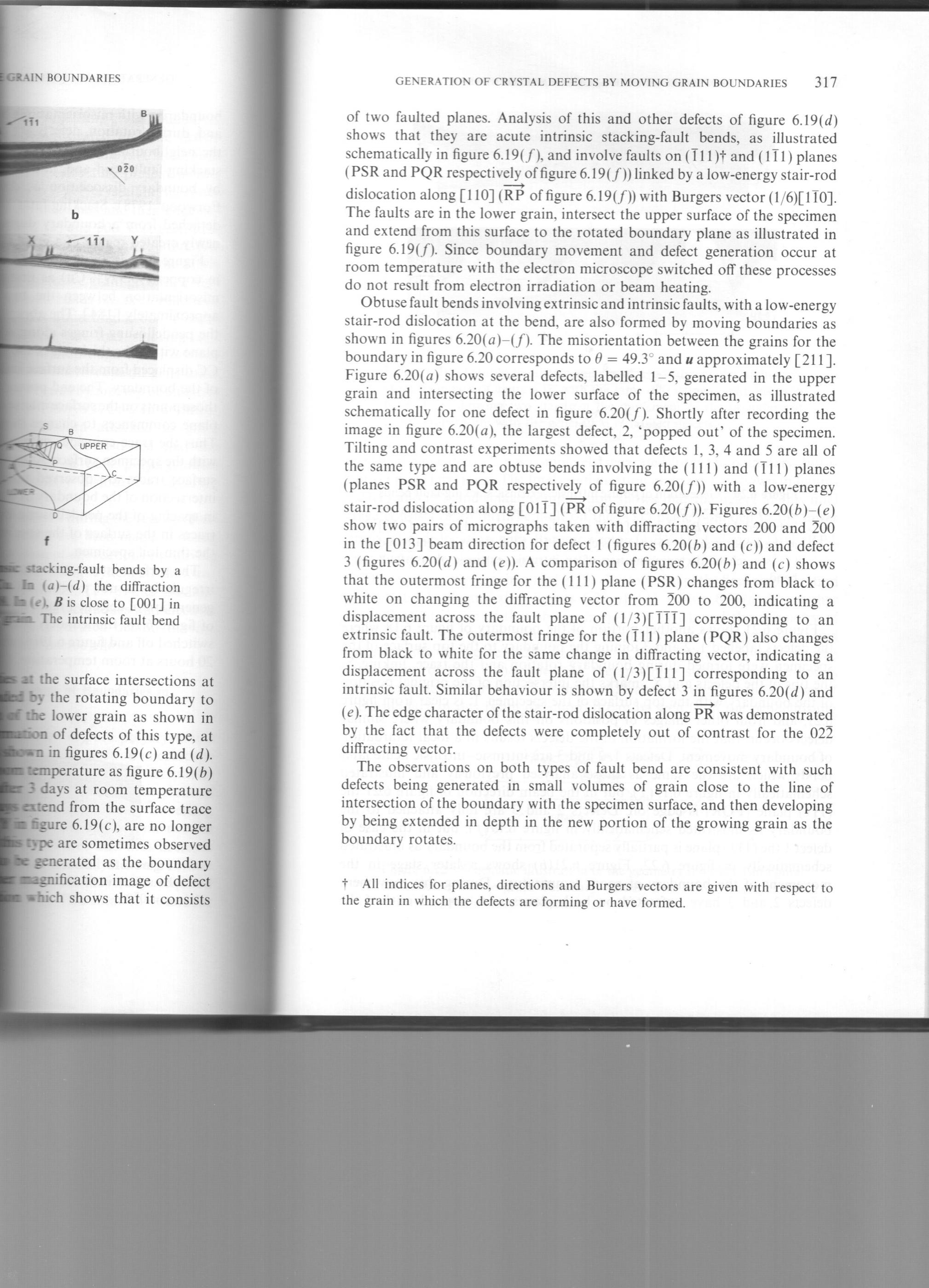

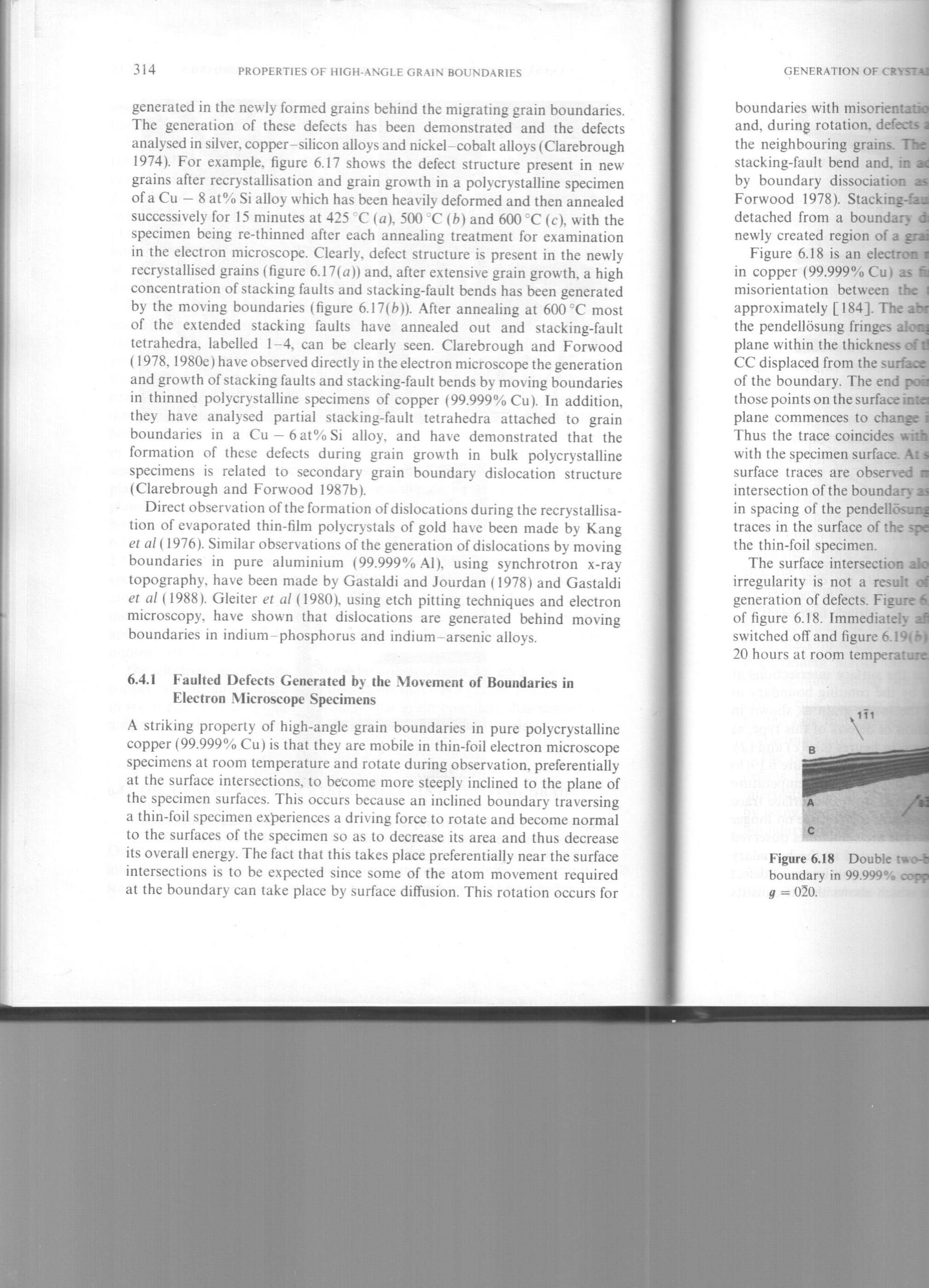

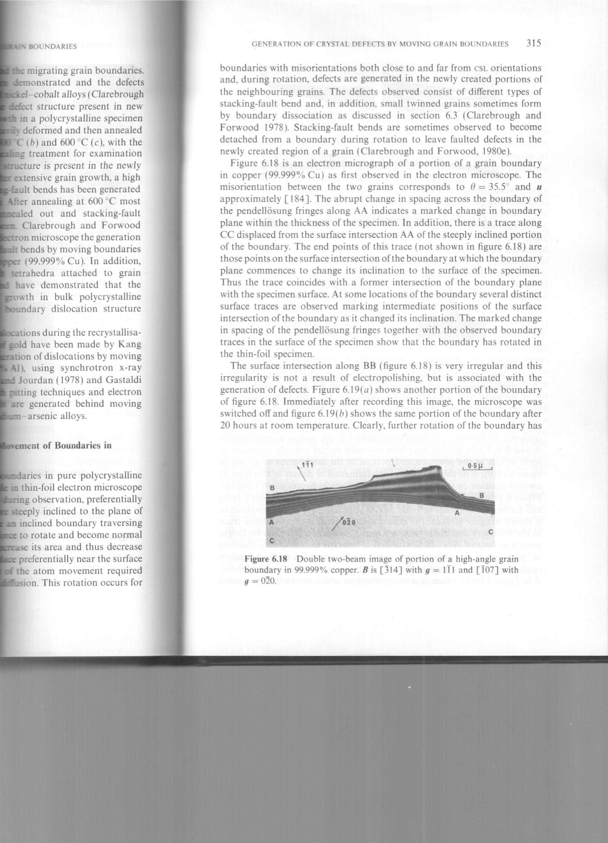

Here are two pages. The second page states that the mechanism is NOT due to the Electron microscope, so there! '-)
So, how does he prove it's not induced by beam heating?
How does one take a picture of an object using a beam that can change the object, yet claim that the picture of a change was not caused by the beam being used??
Are you always that gullible John??
