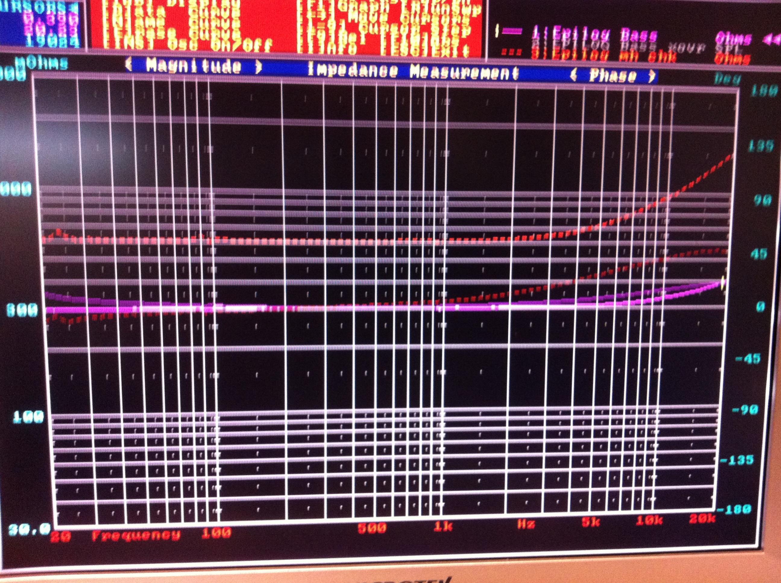

Hey Inductive man, whats causing the rise, too much mass or too low a BL..

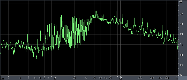

Sure, you can make a tape free, digital free one take recording direct to cutter. Modulation distortions of tape and digital are gone, leaving distortions of cutter system, and those of pickup system.
In vast majority of phonograph recording pickup systems, freely pivoting tonearm with mass orders of magnitude greater than stylus and cantilever system of cartridge, also with relatively high mass is used. Stylus provides both desired signal of recording, and groove pitch signal from cutting lathe. Cantilever suspension must deal with both. Modulation distortion is rampant.
Once in a while, somebody posts a recording made from phonograph. Here are two examples:

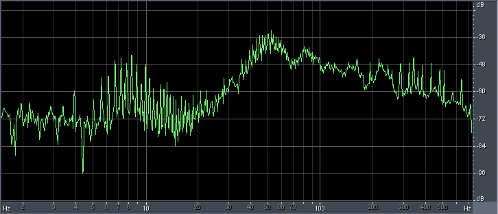

And:

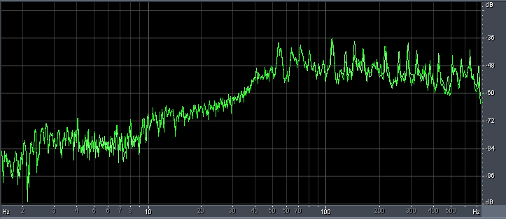

For comparison, a CD track with characteristics similar to numerous CD recordings I've looked at:
Low frequency resonance of phonograph players is gross.
Speaker drivers do similar transformations, but require sparser spectrum such as two tone, with at least one of the tones close to driver resonance to see what is happening, and correlate it with what is heard.
In case of phonograph players, once the correlation is made by a listener of IM effects, the turntable mostly stops spinning. Others revel in the IM effect, and its exacerbation of similar effects in speaker drivers.
