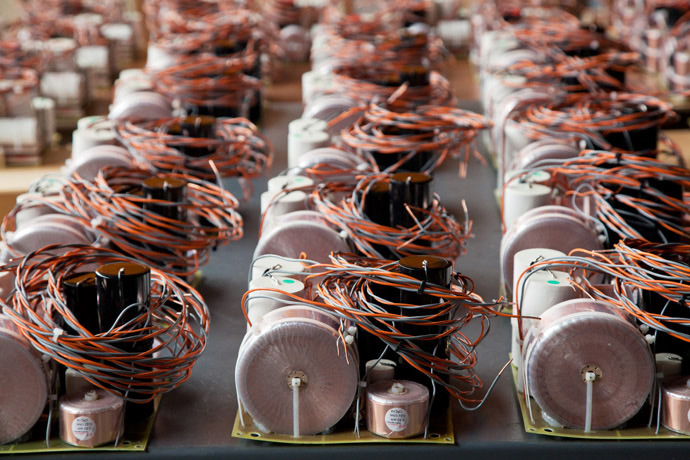

My goodness, people using iron core inductors. Not with hi end!
Worse, some butt up coils on wafer thin boards in 100K+ speakers Laminate core , only in the bass and at power levels 50% below saturation, never on the mid-range , foil or aircore only. Non linearity in AC, means plenty testing back and forth , Foils are completely different and will require different approach...
From the looks of it, that wafer thin pc board has lots of copper on the back. The coils flat to the board will have lower inductance and will go resistively non linear at close to half or a third of the intended crossover frequency.
Sheesh, don't they read Maxwell, or even lenz?
