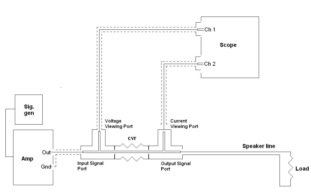

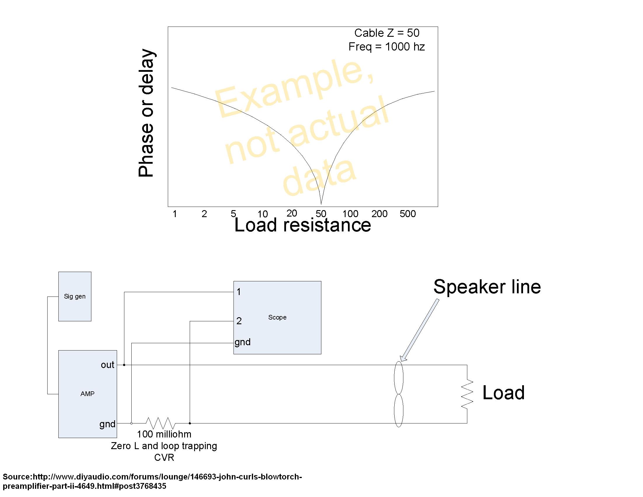

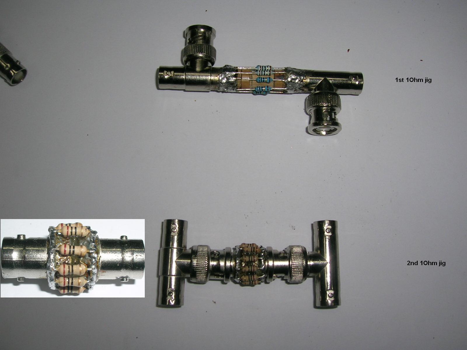

My coaxial cvr jig for impedance measurements

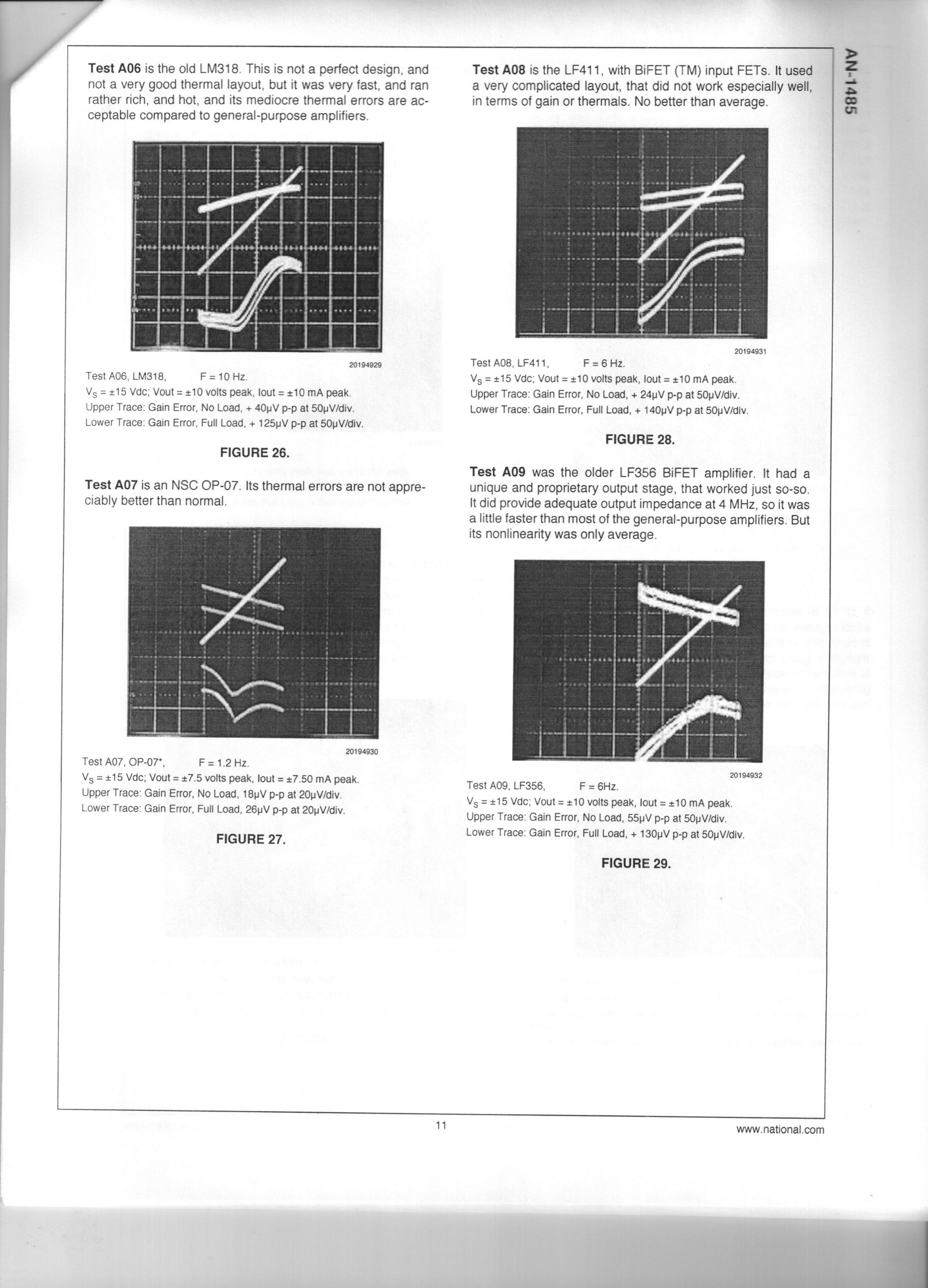

there he goes again.. ..with more ~30 year old "examples"
check the chips issue dates please - LM318, 411, LF356?, even OP-07 isn't exactly new although it did have DC precision specs- please spare us

"Temperature gradients from a few tenths to a few degrees centigrade develop across the chip, with the output section being hotter then the rest. As illustrated in Fig 4, these temperature gradients appear across the input components of the op amp and induce an input voltage which is proportional to the dissipated power" Solomon?
with a simple output buffer there no reason for the input chip to modulate by mW driving >100 kOhm, few 10s pF of the buffer amp input
so even 0.1 C isn't expected if you care to design out the "problem"
