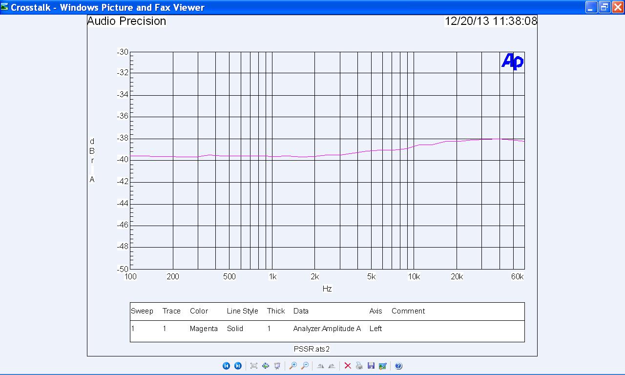

Here are the results of 200' of portable mic cable. I ran the F plots at 10mV but stepped the phase up to 10 volts as the AP seemed to lose it's grip on reality.
The most important band is around 5,000 hertz and the coiling seems to reduce the phase shift there.
Looks like something (noise) is ramdomly triggering 2pi phase wrapping. You also have pi/2 net phase with no features in the frequency plot of any significant magnitude, doesn't this bother you also.

I showed five runs of each test. The noise bumps are quite an issue. It seems the AP is jumping phase lock. If you subtract out the bumps you get the same phase curve that has no discontinuities. So looking at those there is a small phase difference that might actually be heard.
As to no change in the FR plot for the phase change, yes I would expect -3db at 5,000 hertz for the FR plot if the losses were due to RC action.
I read this as there is very loose coupling in the coiled cable. That is to be expected as if you twist wire "A" with wire "B" about 1/2 of the time "A" will be close to the next turn of "A" and about 1/2 of the time to "B". But it won't be exactly 1/2 so there will be some net action. This of course is complicated by other factors.
So if someone else with an AP wants to run the Frequency and Phase plots, it should be interesting to compare results.
Personally I find the phase skips quite disturbing. BTY where you see a T above the plot means the AP believes there is an error.
In fact it's a nearly perfect all pass 180 degree phase transition. Is this a clue?

Scott,
The parameter we are looking at is called crosstalk. I placed two 50' coils of microphone wire near each other. The send coil was sourced from 50 ohms and terminated in 150 ohms. The receive coil had a 10,000 ohm termination and fed the input of the AP. The results are shown.
What to me was interesting in the phase plots was the "noise" jumps even at a signal level of 10 volts and that they mostly appeared at the same spot on the frequency sweeps. I suspect there is a very interesting issue here we are missing.
Just for informational purposes, is the AP stimulus swept, impulse, MLS, or...?
The swept signal mode.

Scott,
So, now we've changed the subject?? Crosstalk of two balanced shielded cables is not the same as solenoidal inductance. I guess we can assume you gave up on that, and are now going after crosstalk...excellent, as that is exactly in line with my previous discussion about lenz, eddy, coupling, and dispersion. It requires field spillage, which is crosstalk..
What is the field termination impedance for a balanced mike?
What is the shield coverage for the cables you just tested?
Where is the schematic? Did you drive balanced and receive balanced?
When confronted with test results which seem inconsistent, you have to approach it in a logical fashion. You're jumping about in your presentation.
Now, is this statement about the previous phase plots?
It was indeed weird that it happened at the exact same spot. You should have run a sine into it and scoped the output, then sweep it through the point where it goes nuts. edit: you must keep the exact same drive and termination impedance however, as it may be important to keep the reflection coefficients at both ends the exact same as the AP does.What to me was interesting in the phase plots was the "noise" jumps even at a signal level of 10 volts and that they mostly appeared at the same spot on the frequency sweeps. I suspect there is a very interesting issue here we are missing.
The phase droop upper band is the most interesting, disregarding the huge jumps, because the amplitude doesn't change much. What you need to do is a variable frequency TDR. I don't suppose you have a modified RF bridge, do you? An alternate approach would be a low inductance CVR and the drive end ground, then scope the line phase.
If you peruse Cyril Bateman's article on this, it may make more sense to you.
