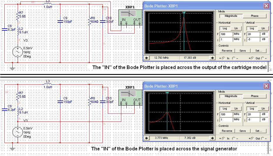

My :up: was for the acoustic effects on the resistive loading (they confirm my own conclusion).
As for the height of the simulated peaks I concur with the comments of Scott and yours. They are too high.
Why? The simulation is correct as far as the electrical part of the chain is concerned. (*)
The deviation from the reality is to be found on the lacking sim model of the cartridge. There, we have to model the mechanical part of the cartridge and then we have to model the coupling of the mechanical part with the electrical part of the cartridge.
The mechanical part model will give some HF resonances which are in the sub 100kHz range. (**)
The mechanical to electrical part coupling is to be modelled by a transformer. The coupling coefficient M is disappointing and I am afraid is frequency dependent too. (***)
The HF energy in the vinyl music grooves doesn’t go too high in frequency.
The system exciter is surface scratches and needle mistracking. These can excite the mechanical part.
The resonances of the moving mechanical parts will be attenuated by the coupling coefficient M and will be electrically LP filtered by the L of the coil. So don’t expect much HF signal-related excitation energy at the cartridge pins/interconnect cable interface.
George
(*) Joachim, please ask Mr. Carr about the pick-up point for these simulations. See on the attachment below how the effects change when the Bode Plotter input point changes (all else equal).
(**) http://shure.custhelp.com/ci/fattach/get/29245/
(***) I have not managed to excite HF mechanical resonance when I was feeding the coils with my signal generator (up to 2MHz). This with a DL-103 and various MM cartridges.
