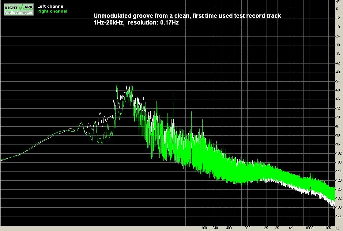

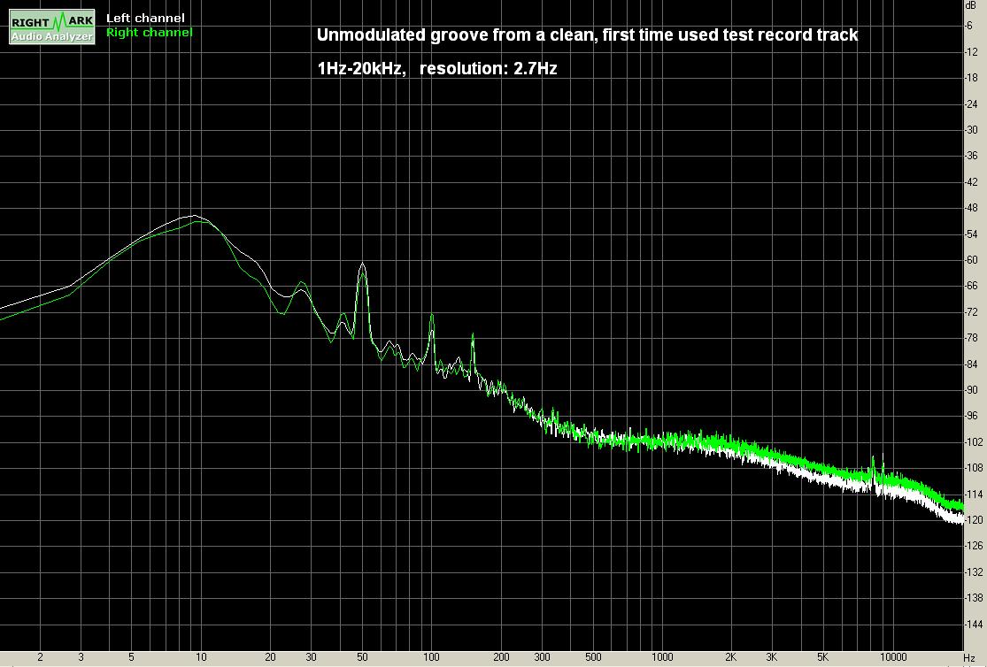

Here is the 1Hz-20kHz spectrum from a cartridge reading an unmodulated test track from a brand new test record, first in low resolution and then in high resolution.
[url]http://www.diyaudio.com/forums/attachment.php?attachmentid=380373&stc=1&d=1383491245[/URL]
[url]http://www.diyaudio.com/forums/attachment.php?attachmentid=380374&stc=1&d=1383491245[/URL]

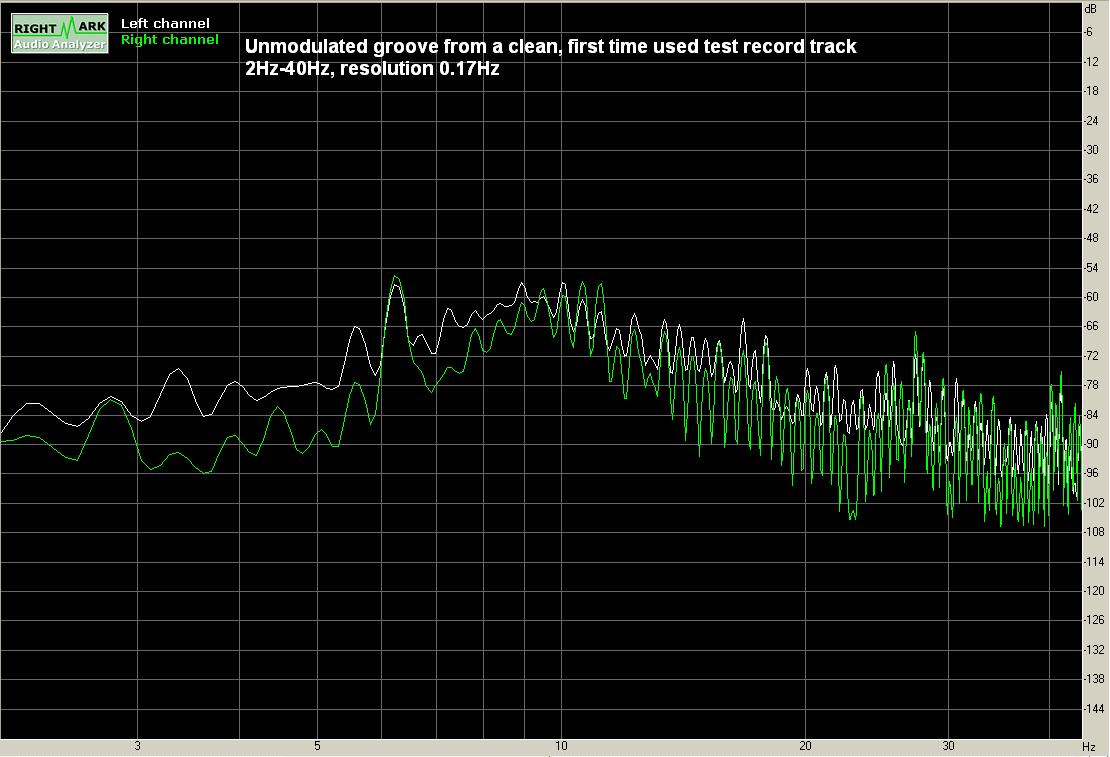

Now zoom in at the 2Hz-40Hz range in high resolution.
http://www.diyaudio.com/forums/attachment.php?attachmentid=380375&stc=1&d=1383491245
You see a waviness (which continues all the way to 20kHz), the frequency of which is 0.55Hz due to 33.3rpm record rotation velocity.
You see the peak at 6.2Hz due to motor rotation velocity (belt drive).
You see a hump at 8 to 11Hz due to arm-cartridge resonance.
You see an imbalance between the spectrum of the two channels caused by minor asymmetric scratch-dirt on the grooves.
All these from a clean –almost scratch free-unmodulated groove.

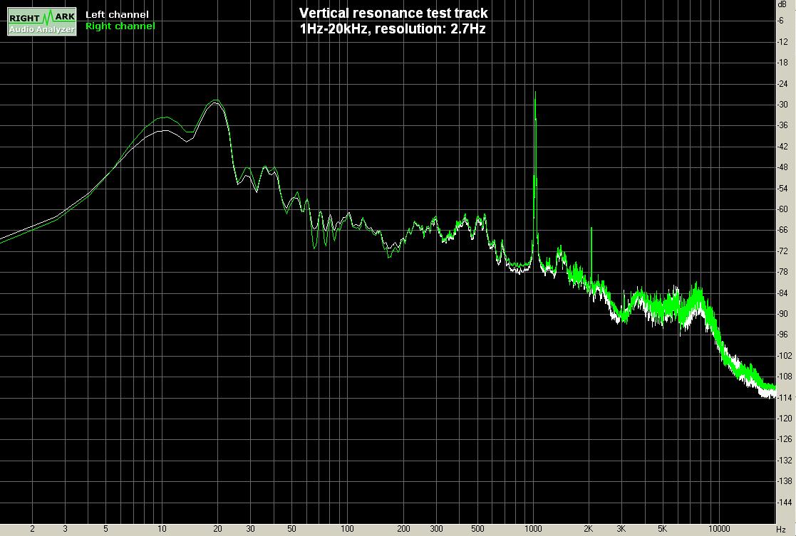

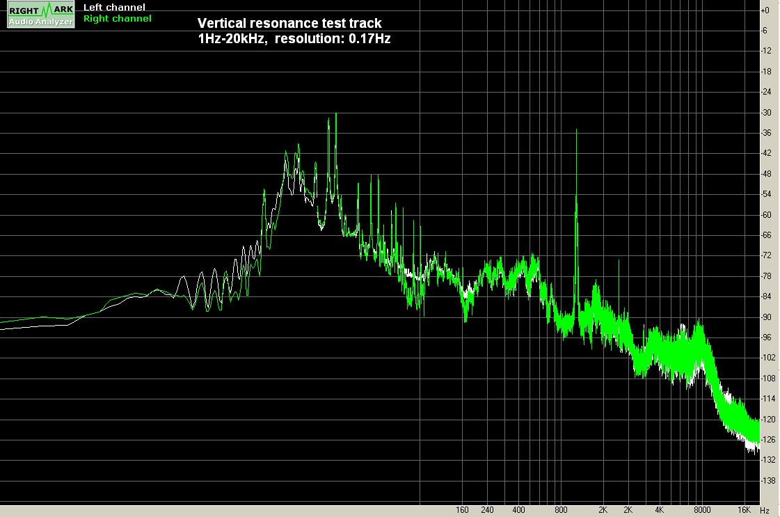

Here is the 1Hz-20kHz spectrum from a cartridge reading the vertical resonance test track from this test record, first in low resolution and then in high resolution.
http://www.diyaudio.com/forums/attachment.php?attachmentid=380376&stc=1&d=1383491245
http://www.diyaudio.com/forums/attachment.php?attachmentid=380377&stc=1&d=1383491245

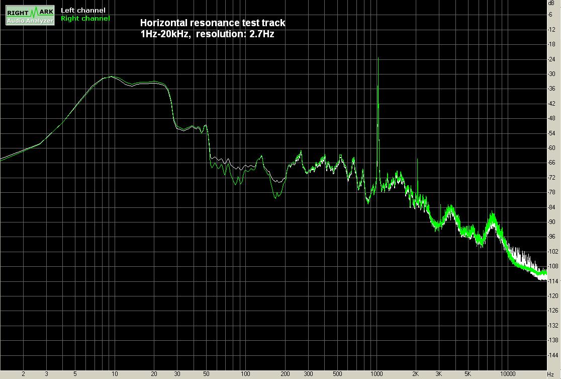

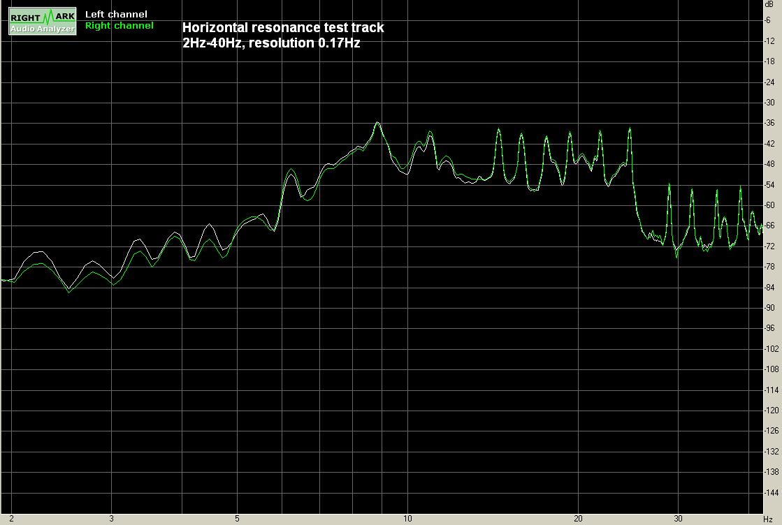

(below horizontal resonance spectrum, first in low resolution,then in high resolution plus zoom in) http://www.diyaudio.com/forums/attachment.php?attachmentid=380379&stc=1&d=1383491245
http://www.diyaudio.com/forums/attachment.php?attachmentid=380380&stc=1&d=1383491245
http://www.diyaudio.com/forums/attachment.php?attachmentid=380381&stc=1&d=1383491245
All of the mechanical components imprint their signatures on the electrical waveform of the cartridge. Pitch change, freq modulation, amplitude modulation, vibrato, tremolo are all there across the complete freq spectrum.
HP electric filtering -passive or active- right at the preamp input will not change this but it will reduce the additional repeating of this modulation process at the amplifying stages –which may be significant-and will protect from LF overload.
DSP processing by convoluting the cartridge signal with the impulse response of the complete mechanical system would provide a cure but this impulse response is strongly amplitude dependant, so there is no straight DSP cure either.
I am convinced that the "gloom, full, bodied ect. sound" of the LP reproduction is because all these effects -and some more-are interacting with various parameters in the psychoacoustic domain.

I especially love the sixth plot, do you think the cart is actually moving in a little helix a different frequency in each axis? Aren't your "verticle" and "horizontal" in this context the modulation of the 1kHz tone? I have an entire RCA STR series test record recorded to digital somewhere, I should dig it out and do the same thing now that I can do megapoint FFT's on it.

The test record is the HFNews test LP release 2002 (“HFN 002 Test LP”)
The unmodulated groove take is from side two, track 6
“Residual system noise (unmodulated grooves)
Unmodulated grooves which when played at normal listening levels will pick up any noise in your system such as rumbling bearings or poor plinth design.”
The horizontal and vertical resonance takes were from side two, tracks 2 and 3
“Cartridge/Arm Lateral/Vertical resonance test (sweep)
These give a visual indication of the resonant frequency of your arm / cartridge combination. When the cartridge suspension becomes excited there is an obvious 'wobble' of the stylus and the pilot tone warbles. You are aiming for a reading of 8-15Hz and applying tonearm damping can help here if your cartridge is a mismatch for the arm.”
It turns masochistic to do this test with every change but it is a way to get some understanding of what is going on, apart from the listening evaluation.
When I was modyfying the TT and the arm, the sound was going to the stiffer side. I said to a friend of mine : The TT sounds quite close to a CD now”. He said: Undo all the modifications then”
Ed, you are referring to the higher 2nd harmonic, yes?
I reached to that conclusion after much thought.
The two-peak (f1, f2) resonance has to be due to the two mass systems, the one in front of the arm vertical bearing and the other behind the bearing. These two systems vibrate in antiphase, that’s why there is not a peak at the f1+f2 frequency point.
IMO had the effect of increased 2nd harmonic was due to the delayed release of energy, one of the peaks would have to change it’s Q as the mass of the two systems is very different. But I may be wrong and as always, thank you for the help.
Bruce, every change, even small, will show a difference in the spectrum. Tightening the cartridge bolts, changing the record matt, hardening the sub platter suspension ect.interesting to see how much of this is repeatable from cartridge to cartridge and how much is arm articulation...
George,
When you have a resonance the energy will continue to build as long as the stimulus is present. So depending on your measurement method a resonant source may show more energy that the exciting source.
In room acoustics I have seen this as a 3 dB rise above the source level. In a mechanical aluminum resonance 20 dB or more has shown up.

What I mean is that you probably could never excite only H or V resonances without some crosstalk. That is the cart is actually going side to side and up and down at the same time on any of these cuts.
Another way to approach this is as coupled tuned circuits in a radio. When "over- coupled" (coupling coefficient bigger than critical) double peaks appear. "Critical" coupling gives highest output, but not necessarily highest Q, probably bad for our case.
Where do the twin resonances come from? My first thought is like Scott's, that the horizontal and vertical resonances happen at the same stylus. Interesting.
Thanks again,
Chris
By George you've got it. Modeling mechanical resonances as electrical circuits often leads to errors particularly if you use the wrong model!
If the energy going into a mechanical resonance is greater than the damping (loss) it will build until failure. Failure is often a buckling mode which then effectively changes the resonant frequency.
Thank you Scott for explaining.
Yes I agree. And the impossibility of isolating lateral from vertical resonances applies in practice to many parts of the system, not only to the cartridge.
Every interface that has some compliance, becomes an L-V cross road. (I once proposed a cross pin attachment in place of the stylus stem compliant suspension in this line of thought and the idea was wooed)
That said, for having a better comparative view of the two resonance mode spectrums, I compiled a new plot with detailed freq points (you guys are tough!).
The fundamental double resonance is almost the same in the two spectrums but past that, the picture changes, a sign of partial L-V mechanical decoupling.
Great work, and so refreshing!
Imagine, actual measurements that can be correlated to actual, well-understood mechanical phenomena, and which can also be correlated with system changes and listening results! What will become of the folks who say we can't measure anything useful?
Thank you. Correlation of measurements with mechanical theory can be realized in a simple mass -loaded (no sub chassis) TT and a simple straight arm with not many bells and whistles on it.
I bet some beers that such a combo will measure well and sound superb too.
