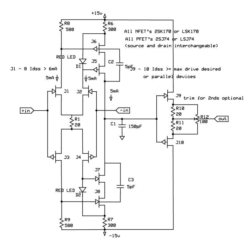

Hi Scott,
You posted this schematic a while ago and I am trying to make a mental sim of it, but I don´t get it quite yet.
The first question I have is with regard to J6..8. In the way it is drawn, wouldn´t it act as an inverted common mode amplifier? The only way it could work in my head is if J6 would be an nfet and J8 a pfet.
The second question is why the non-inverting side is connected to the rails through resistors R8 and R9, while J2 and J3 share a connection to the rails with the succeeding stage over R6 and R7. If this is to compensate for nonlinear behaviour in J5..8, can you please give a clue as to how this works?
No J6 and J8 act as folded cascodes to one side of the input stage and the other side drives the gates of J6 and J8 but at a fairly low gain. The result is the differential current in the input quad comes out of the drains of J5 and J7 and essentially all the gain is taken at that node. The usual use of this connection has substantial voltage gain from J1 and J3 and that side does most of the "work".
Just play with it in LTSPICE, it does work as drawn.
