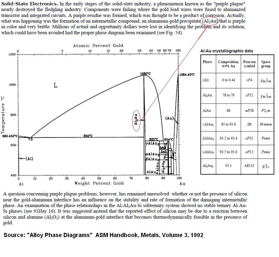

I was reading on alloy phase diagrams and I found this (attached jpeg).
I thought to send it to you
The key elements in the formation of Al2Au is composition and temperature (during bonding or later during service).

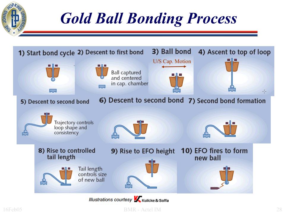

Did you do thermosonic bonding at that time?

Yes. Both thermocompression (T/C) and thermosonic (T/S).jneutron
George
T/C uses compression and heat. T/S uses ultrasonic energy.
Also aluminum ultrasonic, 5 mil up to 25 mil
My responsibility was incoming electrical inspection of the silicon chips. We would sample manufactured lots using AQL, sampling a specific number to assemble, pass on one failure, reject on two. It was a stats thing.
The higher ups had determined that the good wirebonders were for production, and that the trainees would learn on my incoming samples. As a result, I learned all of the various ways chips could be damaged or destroyed by wirebonding. And there were lots of ways. Also, when the bonder wasn't working right, I had to learn how to troubleshoot and repair the bonders.
I also learned all about the physical structure of the chips, and how sensitive to physical damage they could be on the top.

I searched for this article that fits well to your job description
http://articles.adsabs.harvard.edu/cgi-bin/nph-iarticle_query?1997ESASP.395..411J&data_type=PDF_HIGH&whole_paper=YES&type=PRINTER&filetype=.pdf
(See the mention of temp of 125 d. C as a limit, above which Al-Au intermetallics can degrade the bond.
Notice also the positive comments on mass production and stats)
And here are some test data plots that warn against high operating temperatures which promote the formation of intermetallics. In combination with contaminations they cause bond failure
https://www.reliabilityanalysislab.com/IntermetallicsandWearout0302.html
George
Kulicke and Soffa..whoa, names from the past.
The jpeg is thermosonic. Thermocompression is a tad diff..
Sigh..precap visual inspector.. I still have nightmares..
jn
