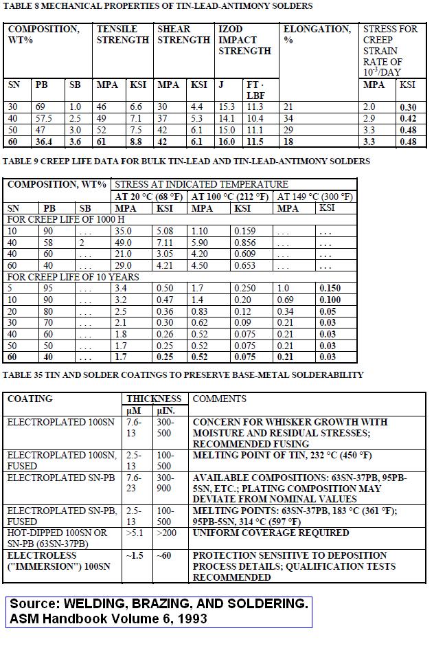

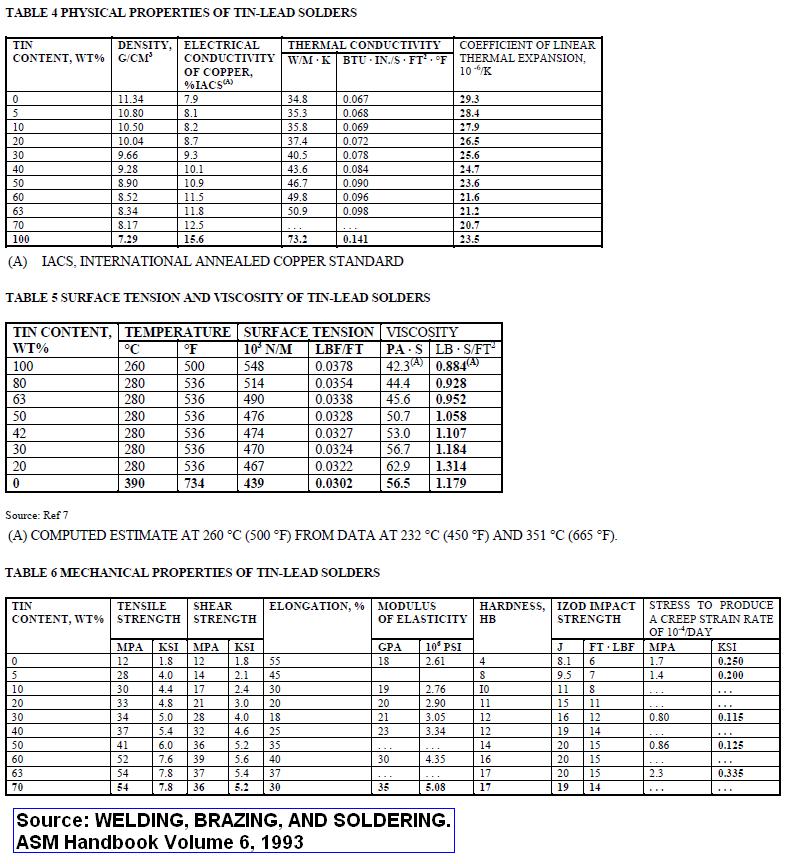

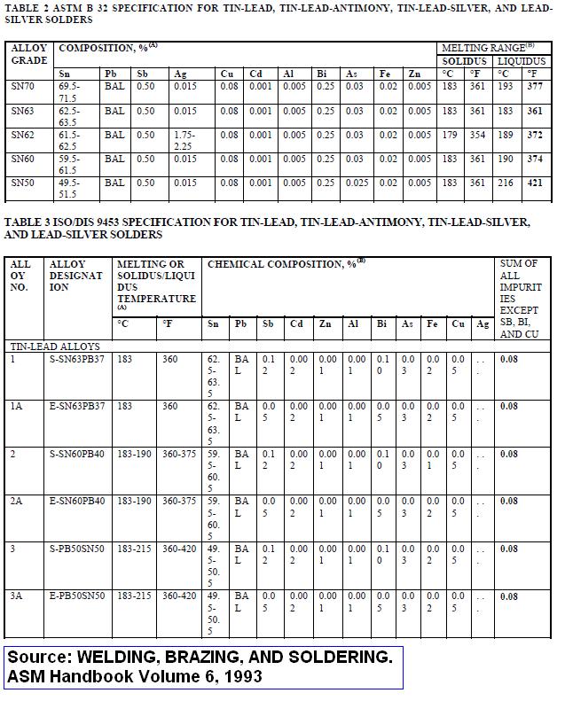

Ah, a point
From a good source
ASM Handbook Volume 06: Welding, Brazing, and Soldering
The addition of an activator to rosin fluxes increases their chemical activity. Activators can be organic halogenated compounds, such as amine hydrohalides that contain chloride, fluoride, or bromide ion groups or "halide-free" activators, such as oleic, stearic, or lactic acids. Halide-free fluxes are recommended for materials that are sensitive to stresscorrosion cracking. The concentration of activators, which defines the corrosivity of the flux, determines the flux category as being one of the following: rosin-base, mildly activated (RMA), fully activated (RA), and superactivated (SA).
Generally, rosin-base fluxes have poor high-temperature stability; that is, the fluxes degrade rapidly after excessive exposure to elevated temperatures (for example, >25 s at 260 °C, or 500 °F).
The ability of base metal to form a stable intermetallic compound layer with a solder limits the number of basemetal/solder combinations that are suitable for the majority of applications. The formation kinetics of intermetallic layers must permit the thorough wetting of the solder for efficient processing. Therefore, some metals are more readily soldered than others.
Another factor is the passivation characteristic of the base metal. Passivation layers form a physical barrier to metallurgical wetting. Before the base metal can be metallurgically wet by the solder, the solder must make intimate contact, on an atomic scale, with clean base metal. Passivation layers are normally oxide films that may be only a few atomic layers thick. Even so, they affect the ability of the solder to contact the base metals underneath them. Many metals will passivate extremely rapidly. Stainless steel becomes unwettable, even with the use of very active fluxes after a short exposure in the atmosphere at room temperature.
Another issue that relates to passivation layers is their chemical and mechanical stability. Because the passivation layer that forms on solder is chemically weak, it can be reduced by weak fluxes. Nickel, on the other hand, forms a passivation film that is strong both chemically and mechanically. It is adherent to the base metal and requires much stronger fluxes to remove chemically.
The attachments is a patch of data, answering questions that have been asked
George
