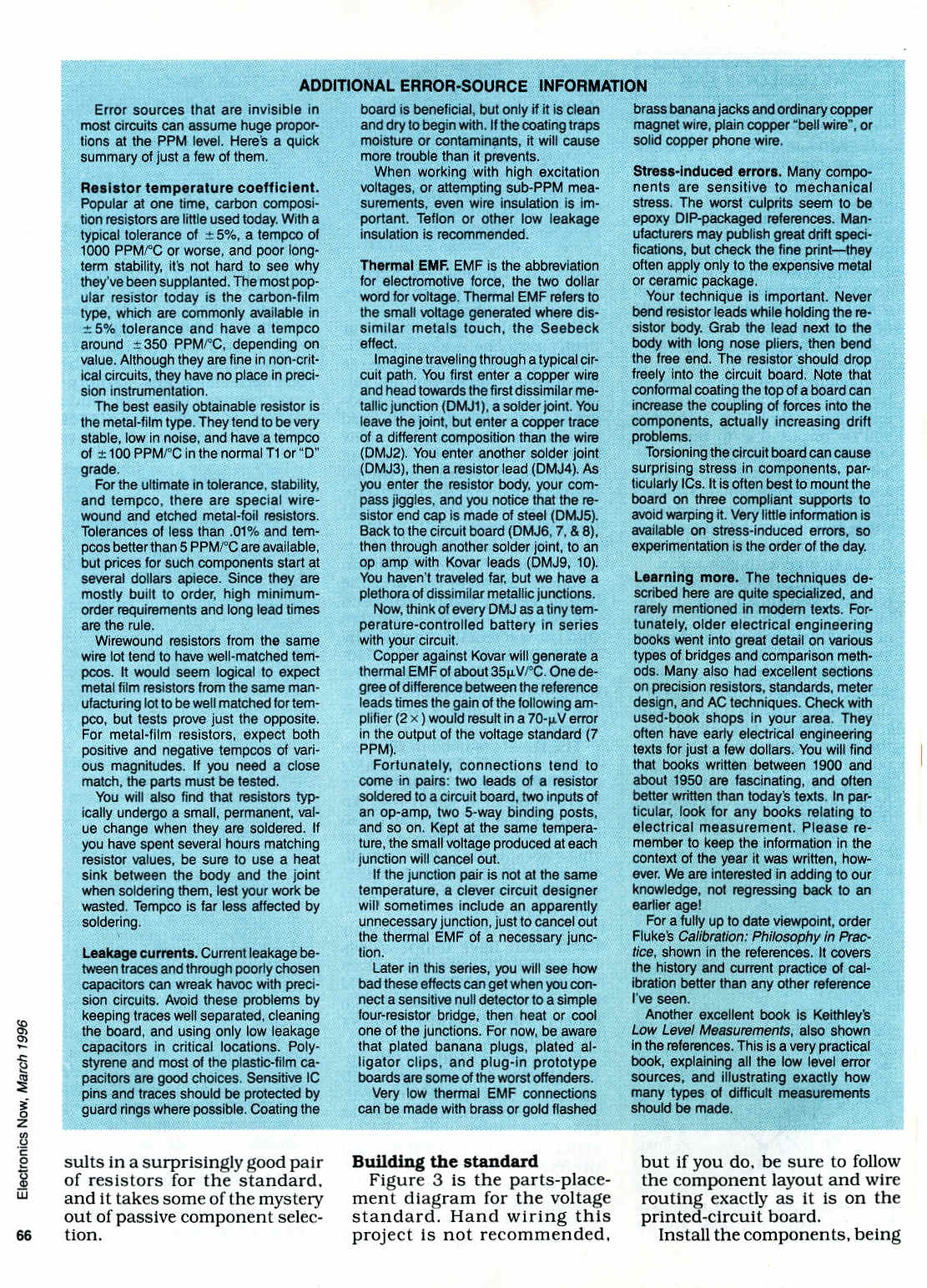

back to resistors and the associates issues. This link http://conradhoffman.com/MML%20files/1_vref_p4.jpg to some info from a contributor to DIYAUDIO highlights a number of issues that probably influence the sound we get but are not usually considered. For example the usse of stress on a resistor affecting its resistance- if the PCB the resistor is mounted on is exposed to the acoustic field from associated speakers its conceivable that its resistance changes a little. That small change with be delayed by the acoustic delay in the space. If its change is enough to be audible (a big unknown) then the net effect could be a variable that makes pinning down the effect difficult.
Years ago I build a custom preamp that was acoustically sealed in 3/4" Delrin. It seemed to make a big difference. However sealing the cables was a major PITA and not for commercial application at the time.
When I placed resistors on a shaker table, the only type that showed problems were the carbon composition types.
Capacitors were a different story. Not surprisingly some of the ceramics could be used as guitar pickups.
