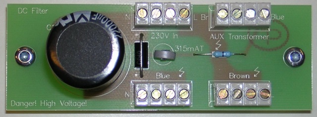

Sorry that i posted the DC filter without further analysys.
I simply copied it from the LC Audio Website.
On the other hand it may be good that i posted it because people that read this thread are now warned about the danger of this circuit.
I read the schematic as using a transorb not a zener. Yes the zener symbol was used to make things inaccurate. A transorb can be made quite large to handle large jolts of energy. Some are essentially zeners triggering power mosfets. Some are bidirectional, I assume that is what is used here.
I suspect the actual device is not quite built as the schematic shows, or else the manufacturer probably would have noticed the explosions.
So the lesson is when you steal circuits, sometimes you may pay a penalty!

Honestly I think the reason is likely that rarely more than 1.5V volts DC is present on mains. I found that it also varies constantly, so I guess the cap just doesn't see reversed polarity for a sufficiently long time.
If you look in the web, there are many dangerous variations on this and yet it seems not much happens. That's really fortunate. Even more so as it seems that even experienced designers are not aware of this problem and design according to their common sense (a few volts won't hurt...).
Have fun, Hannes
The cap does not care if its ratings are exceeded by DC or by AC. What it cares is that something is in parallel that shortens it out of the path before it reaches the 1.5 Volt or so.

Here is a picture of how the LC Audio DC is actually build.
