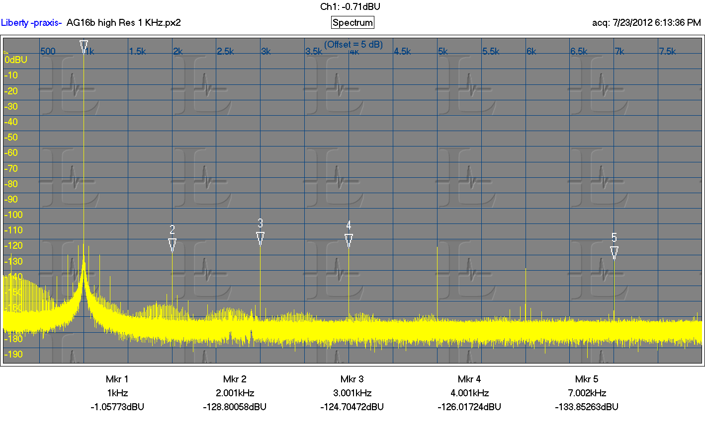

Richard:
Terminology here is a trap. I think when you say parallel FFT you are really meaning parallel ADC, something quite different. Parallel FFT doesn't make a lot of sense unless different algorithms get different results (then one or the other is wrong). Or maybe you are looking at the spectrogram stuff that the SDR guys are playing with. The parallelism is to look at changes with time. It doesn't magically produce lower noise. What you are describing are limitations of real world hardware.
Below is a closer in view of an FFT I have shown before. Except for some hum leakage in the low frequencies and modulating the 1 KHz fundamental there is nothing above -160 dB (except the harmonics). The stuff below -160 dB is probably noise in the test setup. Probably not artifacts of FFT or even artifacts of the ADC. Getting noise or artifacts this low in a real audio system with connections to sources, speakers and power would be exceptionally hard. For what its worth the ADC plotted has a rated dynamic range of 123 dB.
