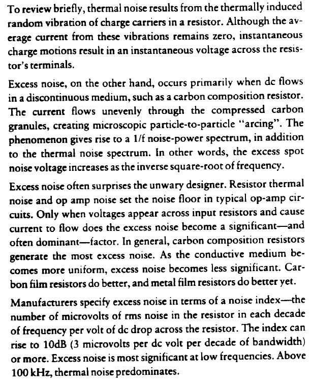

Most people, myself included, don't have what it takes to measure resistors to such degree. Just knowing that some resistors have high excess noise is just more frustrating, instead of helpful. What'd be helpful is to get some data from people like you who do have access to such measurements. At least pointers to where data can be found.
Can't really find it as excess noise; could it be called "current noise" in some data sheets? For instance Vishay Z-bulk metal foil series RNC90Z mentions less than 42 dB current noise.
Doug Grant and Scott Wurcer mention excess noise in AN-348.
douglas Self has measured Resistor noise and distortion in his new book.
He tested Through Hole and SMD.
Here is his list of excess noise:
Noise (uv/V)
Carbon - film TH 0.2 - 3
Metal - oxyde TH 0.1 - 1
Thin - film SM 0.05 - 0.4
Bulk metal - foil TH 0.01
Wirewound TH 0
He found that distortion is higher in small resistor packages and thin film SMD is much better then thick film SMD. So the best resistor whould be a big value wirewound TH folloded by a big value Bulk metal. With "big" i meen resonable size.
For example a 0402 thin-film SMD had 40dB more distortion at 10kHz then a 1206 case.
A 0402 thick - film had even 45dB more distortion at 10kHz.

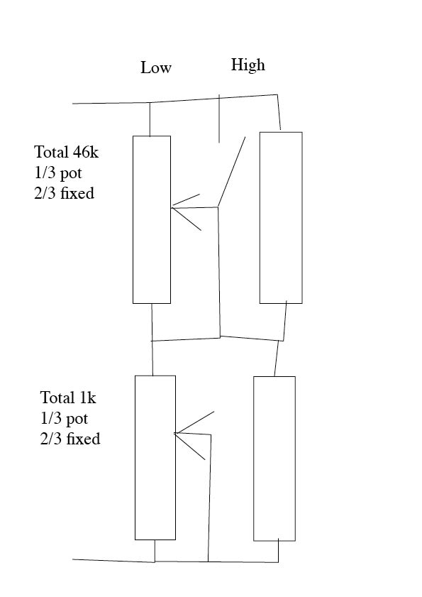

btw, i have another idea for cartridge loading with potmeters.
i will do i little scetch.

Actually, voltage coefficient is DIFFERENT from excess noise. Excess noise, often called the NOISE INDEX, is a little difficult to interpret without formulas, but generally speaking metal film resistors are about 10 times quieter than carbon film resistors, and sometimes almost as good as wirewound resistors, for many applications, especially without too much DC voltage involved. Unless you are a noise nut, like Joachim or me, usually any quality metal film resistor will be adequate. I recommend: "Low Noise Electronic design' pp. 176-179 Read it if you have it.
SY, please don't waste our time with a useless input.
If you've got data showing excess noise in wirewounds, let's see it. That will be news to many.
The extra cost of wirewounds would keep most here from using them. You should know better.
In reality, there are only a few critical resistors. What's $20-25 in a high end design? You spend more than that on a single cap. If the thread is now about bargain basement construction, then I apologize for butting in.
John, I'm not one to shy away from doing the leg work necessary to find info whether in a book or data sheet. That's precisely why I asked, because I'm having a hard time finding any data sheet that mentions noise index or excess noise.
