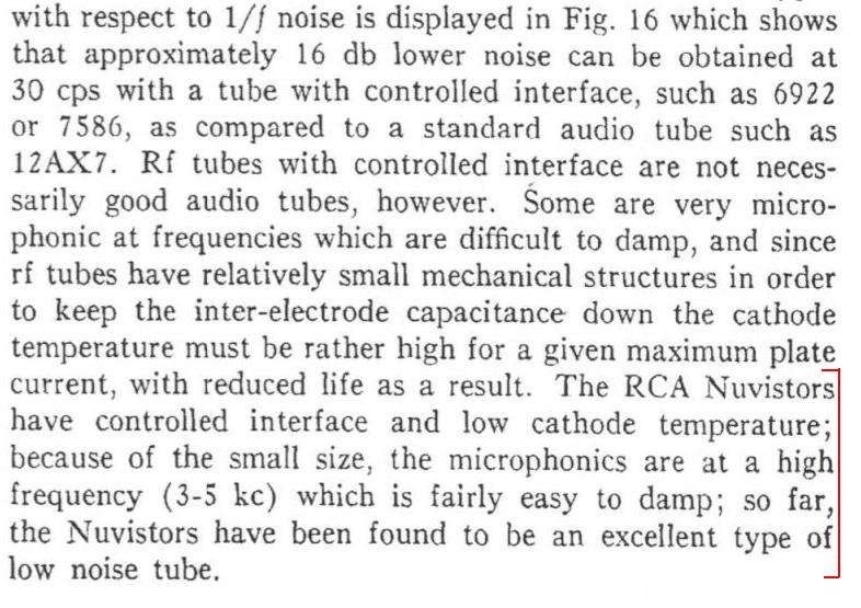

I read it. I even learnt something: that cathode interface problems can be a source of 1/f noise. That may explain why some people prefer 'computer' versions of valves, as they have cathodes designed not to form an interface layer when the valve is left with heater on but no anode current.john curl said:(If they will read it) '-)
The reality of cathode interface is often denied by audio people; for some reason it seems to be rather better known by RF people even though it has greater effect at lower frequencies. Maybe RF people are just more technically aware?
Maybe if audio circuits were considered as RF design exercises they would perform better, subjectively ...Maybe RF people are just more technically aware?
Still Nuvistors are held as no-no for riaa pre On what grounds? (and I have some of these waiting to be used ).
… to form an interface layer when the valve is left with heater on but no anode current.
Have you experienced this effect?
Is it severe?
I use the pactice heaters on, then HT on and for short periods of non use I turn off only the HT as I don’t think the thermal shock from heaters turning on is a good thing.
George
Stunningly microphonic.
So, I read your answer as “beware of external vibrations”.

Please don't use nuvistors for audio. Their natural habitat is VHF receiver front-ends so that is where they should be left to live their lives. I'm not certain that even the Russians still make them so prices are creeping ever higher.
"They were used normally in high frequency or very wide band applications (e.g. radio, tv, Tektronics oscilloscopes), but also in some very specific audio systems. And in spite of their scarce notoriety, they were used by major companies: for example Conrad Johnson (Premier 6 and Premier 7 pre-amplifiers, where nuvistors were used in the head pre-amp), McIntosh (MR65, MR71 tuners, in RF stages), Harman Kardon (Citation VII tuner again in RF stages) and also AKG (C-12A microphone, as pre-amp) and Neumann (U47 microphone, again as preamp in some variants: in facts the small size suggested to use them also as internal pre-amplifiers in these famous microphones)."

"They were used normally in high frequency or very wide band applications (e.g. radio, tv, Tektronics oscilloscopes), but also in some very specific audio systems. And in spite of their scarce notoriety, they were used by major companies: for example Conrad Johnson (Premier 6 and Premier 7 pre-amplifiers, where nuvistors were used in the head pre-amp), McIntosh (MR65, MR71 tuners, in RF stages), Harman Kardon (Citation VII tuner again in RF stages) and also AKG (C-12A microphone, as pre-amp) and Neumann (U47 microphone, again as preamp in some variants: in facts the small size suggested to use them also as internal pre-amplifiers in these famous microphones)."You could take heroic steps to isolate from vibration and acoustic impingement. Is it worth it?

Yes Skov, which I hadn't seen, thanks for that! is good for his day. It looks as if he relies heavily on the good Bell book, and it's a bit odd that he doesn't mention the van der Ziel "Noise" which had been out for quite a while by then. The remarks on FETs are necessarily terse as they were so new at that time and rapidly improving, and until the landmark van der Ziel paper of 1962 even the very nature of the noise mechanisms was controversial (should really say just wrong!). And the 1962 paper was not absorbed by many for some time thereafter --- it tripped me up for a while because I trusted some astronomers at Princeton
I also like Skov's managing to get "cooled" terminations in there, in such a relatively short paper.

PS I did do some testing of nuvistors recently, after discovering a box of 6DS4s in the residue of parts from a failed business, and after buying some expensive sockets for them, found them rather less-than-ideal triodes in terms of constant mu. So I was a bit disappointed, even though it would be ludicrous to design with them today.

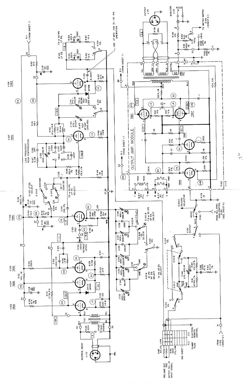

It's funny to read all these comments on Nuvistors, knowing that the actual tape recorder was manufactured and very good music was recorded on such machines. Some of your favourite LPs/CDs/SACDs might even contain material that has gone thru MR-70 electronics at some stage. Vanguard, Everest, Audioquest, Acoustic Sounds, Stereophile ..
Several complete MR-70s and even more MR-70 electronics are still in use to this day, as far as I know.

Here's the PB part of the electronics:
