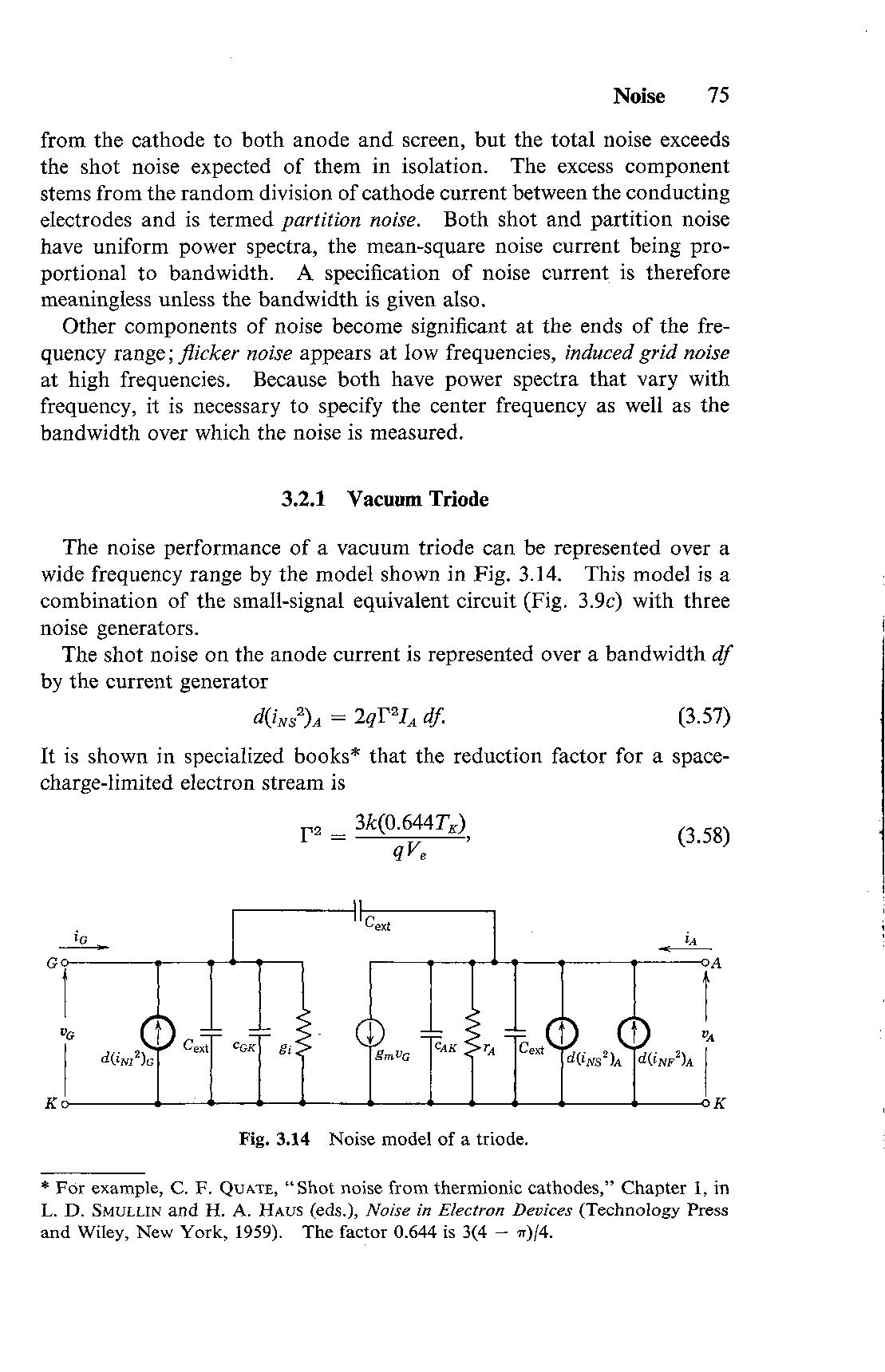

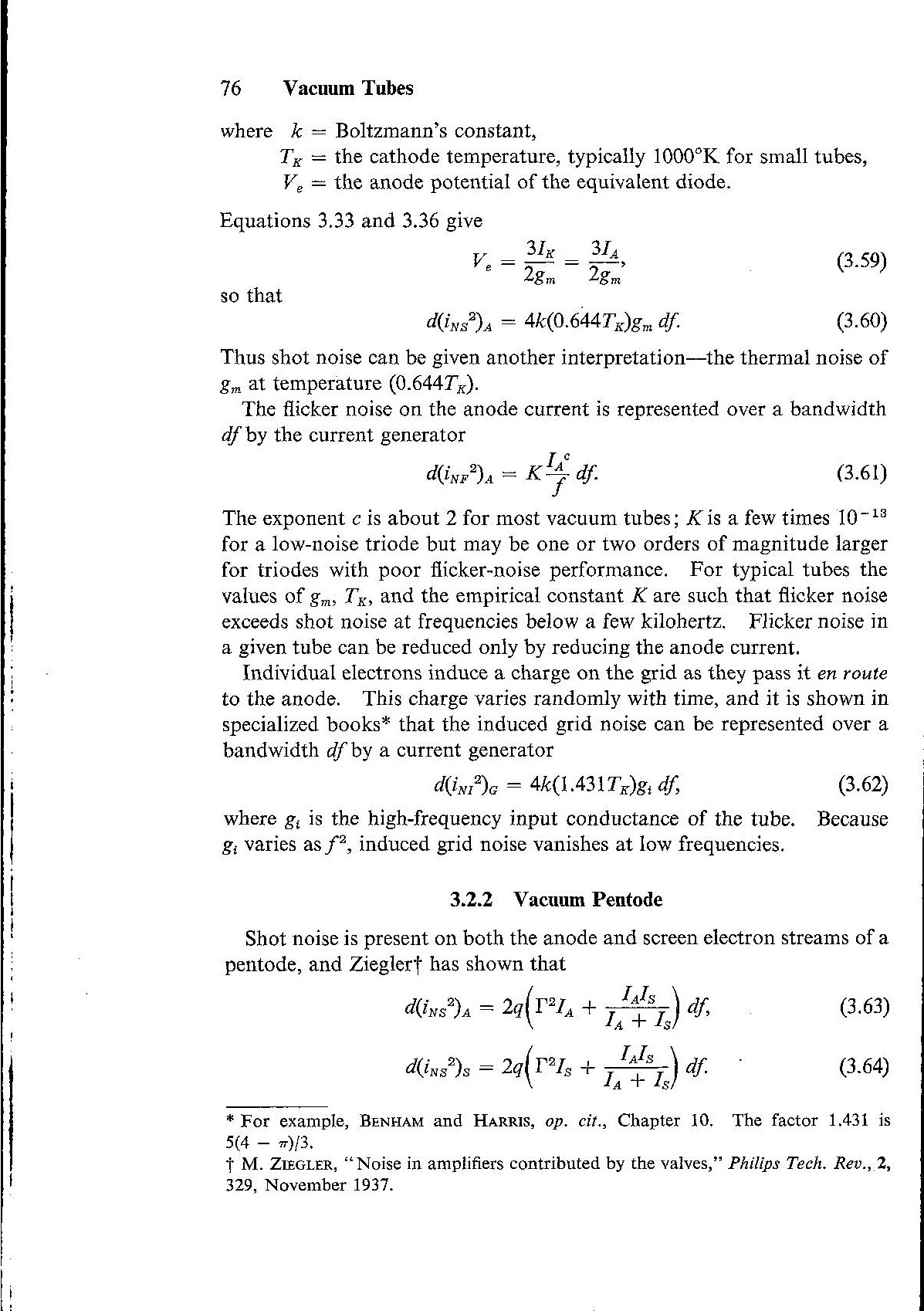

I believe Telstar is referring to random noise (i.e. not "hum"), which in a properly-designed tube power amp should be dominated by the first stage and will depend on details of the tube used there, but which for triodes with typical-temperature cathodes can be approximated at mid-high frequencies by an equivalent noise resistance proportional to the reciprocal of the transconductance --- see Cherry and Hooper* for details. At low frequencies the excess "flicker" noise will rise significantly over the midband noise, usually with a 1/f^n dependence where n is about 1. And it just keeps going as you go down in frequency. Fortunately the ear's acuity falloff is our friend here.ahh interesting, do you happen to know the nature of that noise ?

Some have conjectured that tube noise seems somehow to interact less with the signal and somehow allows the ear/brain to differentiate and find the noise less objectionable (phrases like "it floats above..."). I'm not aware of any studies done to affirm or deny this.
*Amplifying Devices and Low-Pass Amplifier Design" Wiley, 1968

Vacuum tube noise midband in triodes is primarily a shot noise phenomenon modified by a space charge smoothing effect. However, the cathode temperature enters into it as it pertains to the way the transconductance is determined. There's a similar situation in bipolars, where the expression for transconductance involves temperature as well, so that when the expression for one component of the noise resistance is shown, that due to the equivalent emitter resistance at a given collector current, it looks like a sort of thermal noise.
At risk of copyright violence I'll scan the brief discussion in Cherry and Hooper, since that book is difficult to obtain.
