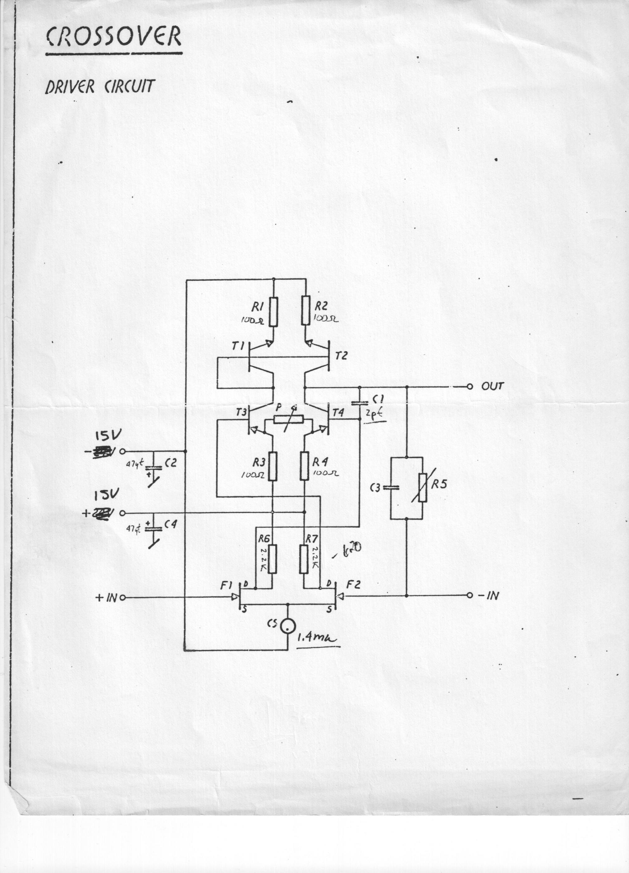

I generally use IRF610 and IRFP510 devices of output followers or cascodes. For common source amplifiers, these devices have to be at least Harris (Fairchild) for the P's. Hitachi devices like the 2SK214, 2SJ76 work OK too.
The 'complementary' argument is sort of weak. It is not that true complementary devices would not be desired, but the lack of true complementary parts usually just means a bit more 2'nd harmonic. It must be remembered that usually the complementary part is working WITH the other part, not just being a parasite, just drawing current (at minimum) or even adding to the load, AND as well having a complementary distortion curve as well.
John, have you tried complementary double emitter followers instead of mosfets (for a line amp op stage) or even diamond buffer? They sound better to me.
Mosfets sound better to you?I have tried just about everything. '-)
MOSFETs like IRF510/IRF9520 are also good for input stages. They have to be biased at 35 - 40mA then (each). They are even more RFI resistant than JFETs, and probably even better at this position, for power amplifiers.

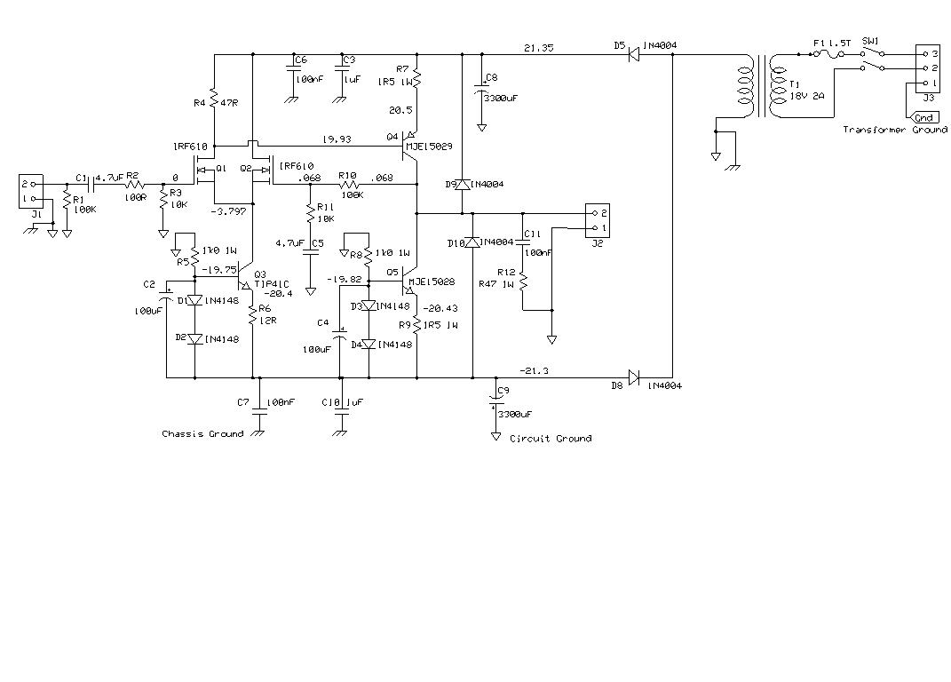

This is a circuit we let students build.

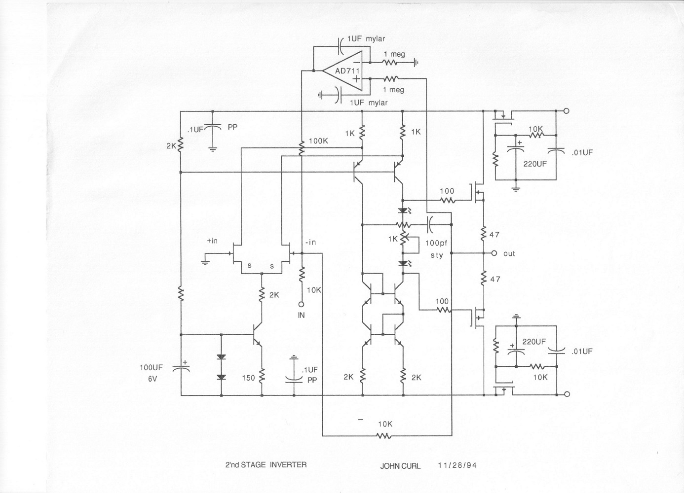

It would appear that just showing schematics does little to encourage progress. This is understandable, but a bit of a problem.
The problem is: Can I convey what the DIFFERENCE between the schematics is, in terms of audio design excellence? With so many believing that virtually everything reasonably well made, sounds effectively the same, why not just switch to IC's and forgo the hassle of getting parts, making boards, wiring and testing? It can be done for us at the factory, with BETTER SPECS as well.

John,
I am dumb and learning. I am more than willing to listen to you explanation of the resistor arrangement. I have the simplified version sitting in eagle cad, on hold, as I want to see the benefits of this arrangement.
