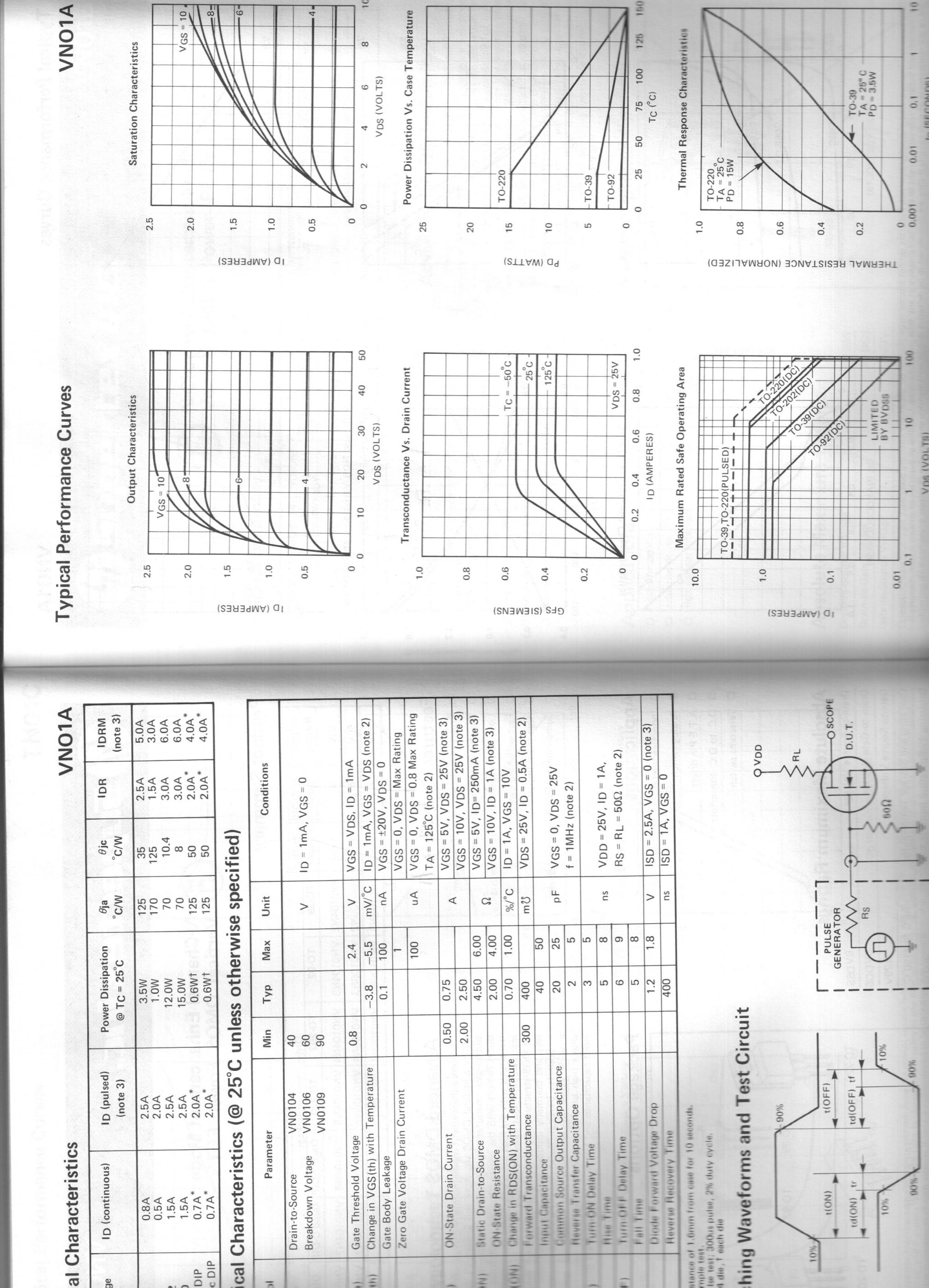

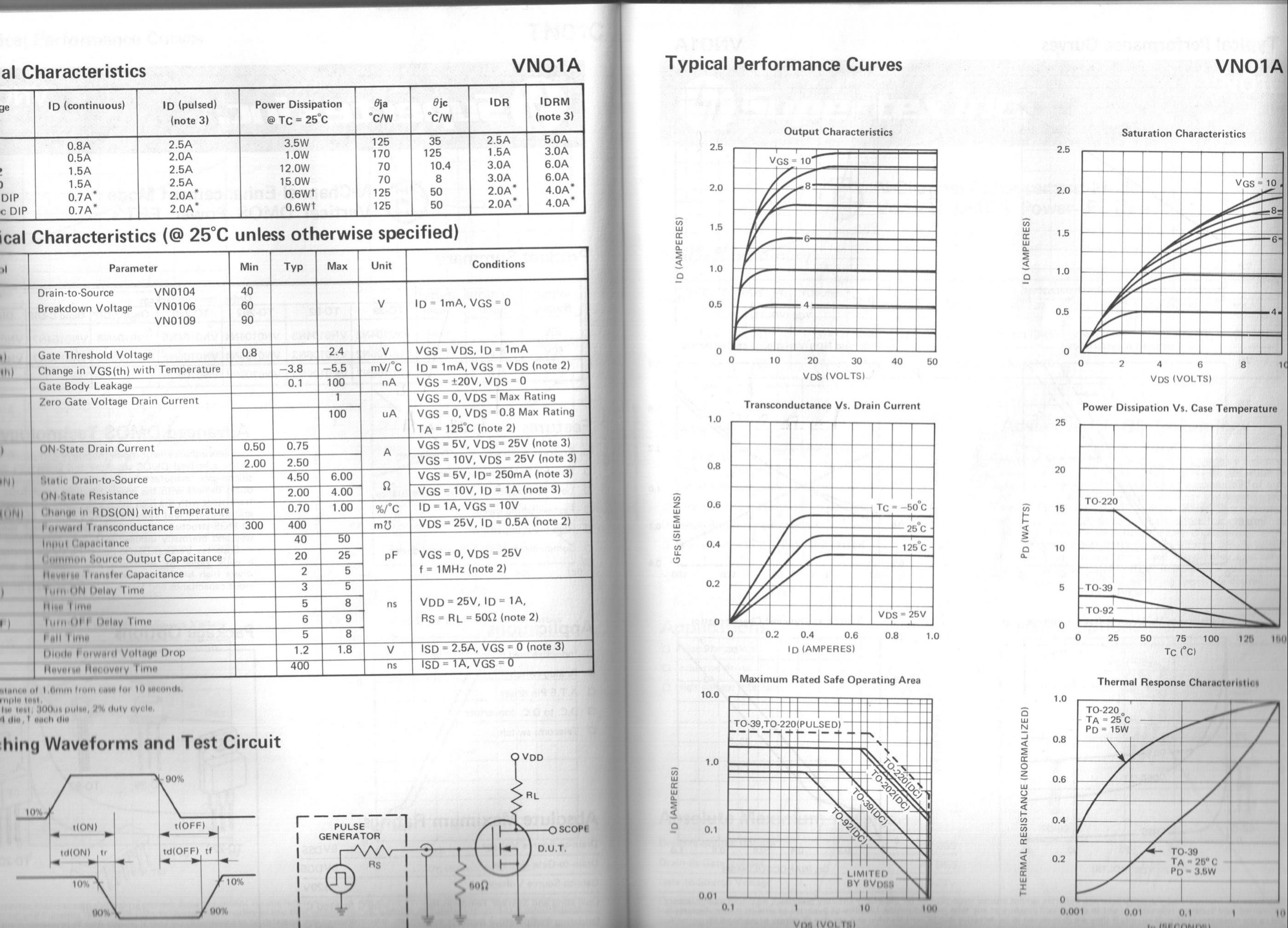

Now, what can we do with to TO-92? I need to dissipate 50ma at 30V or 1.5W per unit, to make an effective line stage. Can I do this with device? If not, what is the alternative?

Sorry everybody, I forgot to show the pages of the Supertex device from 1983.
And here they are in proper orientation.

Also remember that the one lead in particular (usually the drain for DMOS, or the collector for bipolars, or the gate for JFETs) is by far the best heat path to the chip. The ratings are typically for ambient, for which TO-92 is pretty high thermal resistance.You might have to just break down and parallel two of them.
Use of a little copper flag or for the adventuresome, BeO etc. pressed into good contact as close to the encapsulant as possible can provide a remarakble improvement over the ambient rating. Although I am glad that Patrick has done his heatsinks, if you really want to push things I think this is the way to go.
