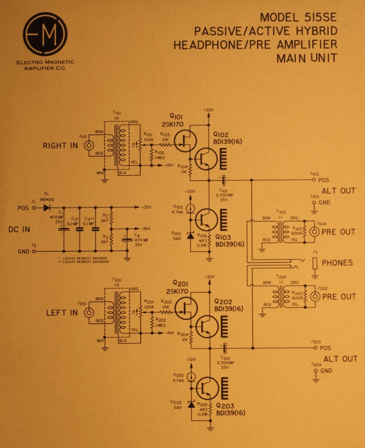

JC mentioned iirc that the configuration with the 1k output termination of DMOS drains was particularly robust against loading-induced instabilities, and such circuits particularly useful for problematic line-driving applications like performance venues and their ilk. Note also that RFI/EMI induced into the output will be less likely to find its way to rectifying junctions, unless quite high-level.
Of course the standard technique is to throw down a high-loop-gain opamp circuit and put a fairly low-value resistor in series to the output connector. Note that the same interference considered above will likely find its way back to the input of the opamp via the feedback network and get demodulated to some extent.
The load-compensated JFET buffer I showed a while back is also rather well-behaved with reactive loads --- the bandwidth degrades gently but it doesn't readily break into oscillation. The trick is to know what the loading is for proper compensation. The buffer linuxguru showed and related circuits is nice as it compensates for loading more-or-less automatically, as long as things stay in class A, nothing "running dry". However I think it is a little more temperamental with reactive loading. I still mean to get round to showing some enhancements of his approach, using some DMOS in place of some of the bipolars.

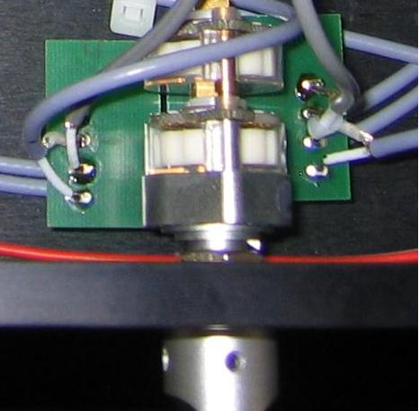

Oeww, love the volume knob of that one, big enough to club someone with.
And you should see them fly! They make great shurikens once you've ground down the skirt to a razor sharp edge.
(but the case longs for 2-tone anodised aluminum, with the box joints)
There is a time and a place for two-tone anodized aluminum. This is not one of them. I'll stick with the ebonite.

Just for fun here is a "Million Dollar" circuit. Any guesses as to why and what it does?
