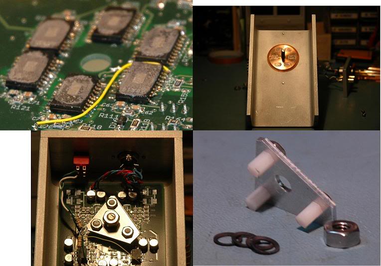

I am sucking > 6W from each TPA6120 op amp by clamping its power pad to a copper slug PC cooler:
side view of 6x TPA6120 mounted "belly up" to clamp pwr pad to CPU heatsink Cu slug
internals:

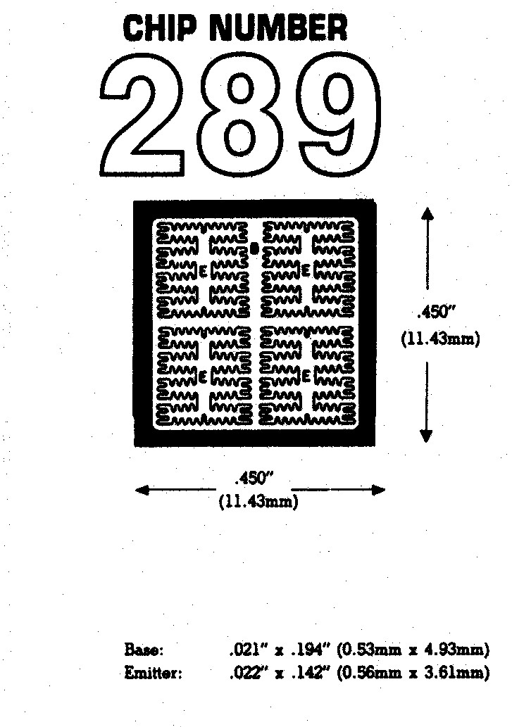

Now, how was this power rating determined?
Would you believe with an INFINITE HEATSINK? Or perhaps tested with a 'swimming pool' of Freon surrounding the device?
John, if you have no knowledge on a subject, PLEASE do NOT expound on it. It's foolish looking.
The limit on a transistor dissipation is based on the temperature that occurs on the top of the die. All of the dissipation in a bipolar in the old days was within the top thousandth of an inch of the chip, that is where all the diffusions are. That is where the CB/EB junctions are.
Early limits on die dissipation? How much of the top area was actually dissipating... Emitter finger patterns, aluminum thickness, where the emitter bonding pads were and how many... all change the dissipation distribution. Check out solitron, they have die pics readily available online. I worked with the 4 emitter pad, half inch square chips..I forget if it was the 068 prefix die ...back in '83.
Another heavy limit on dissipation is the attach bond to the chip bottom. In the early days, they'd use a die attach preform (maybe the RS type, or "rapid solidification" where they cool the molten solder on a spinning copper surface to the tune of 10k degrees/sec), I recall Moto had a proprietary 4 component alloy, and I believe they used a nitrogen belt furnace. I don't believe they used a DAP process, but then again, that was a while ago.
How did they determine the limit?? Easy. They measure it.
A circuit which forces dissipation on the transistor, then turns off for 100 microseconds or so...during the short turnoff phase, measure either the EB or CB forward voltage with a 10 or 100 microamp current source.
The time constant from junction to case is well into the 10's to 100's of milliseconds. Settling time to get a temp read is in the 10 uSec range, so they can get a read of the silicon temperature physically within a thousanth of an inch from the top surface.
They make and sell testers like this commercially. Back in 84, I had to build one. Mine was a little different, in that I used the measured temperature to modulate the power dissipation. I could detach the device case from the heatsink during high dissipation, and the circuit would adjust the dissipation to maintain constant die temperature.
They also overcame many early secondary breakdown problems due to hot bonding voids (a void under the transistor die). This is production tested with a high power pulse to determine transient thetaJC ..some will subject the units to BVceo(sus) to cull out secondary breakdown faults as well.
John
ps..device ratings are always junction to case. The manu could of course cheat by putting the case thermocouple directly under the die to give better numbers. But that seldom gets repeat customers.

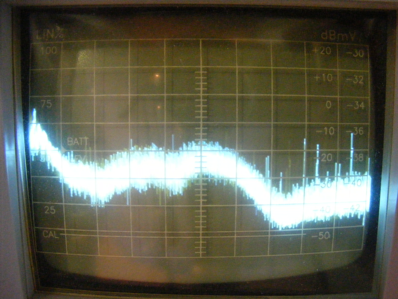

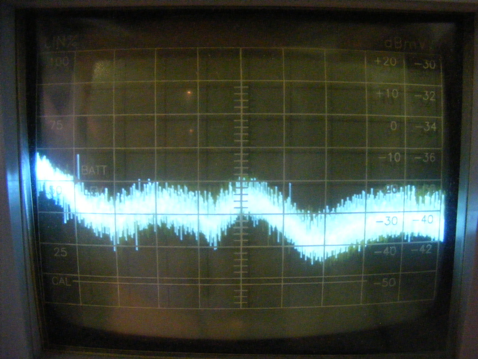

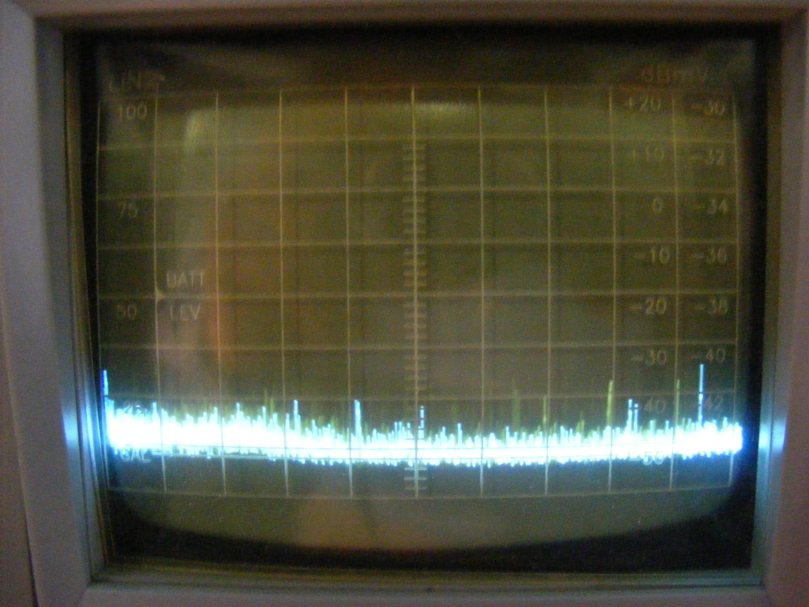

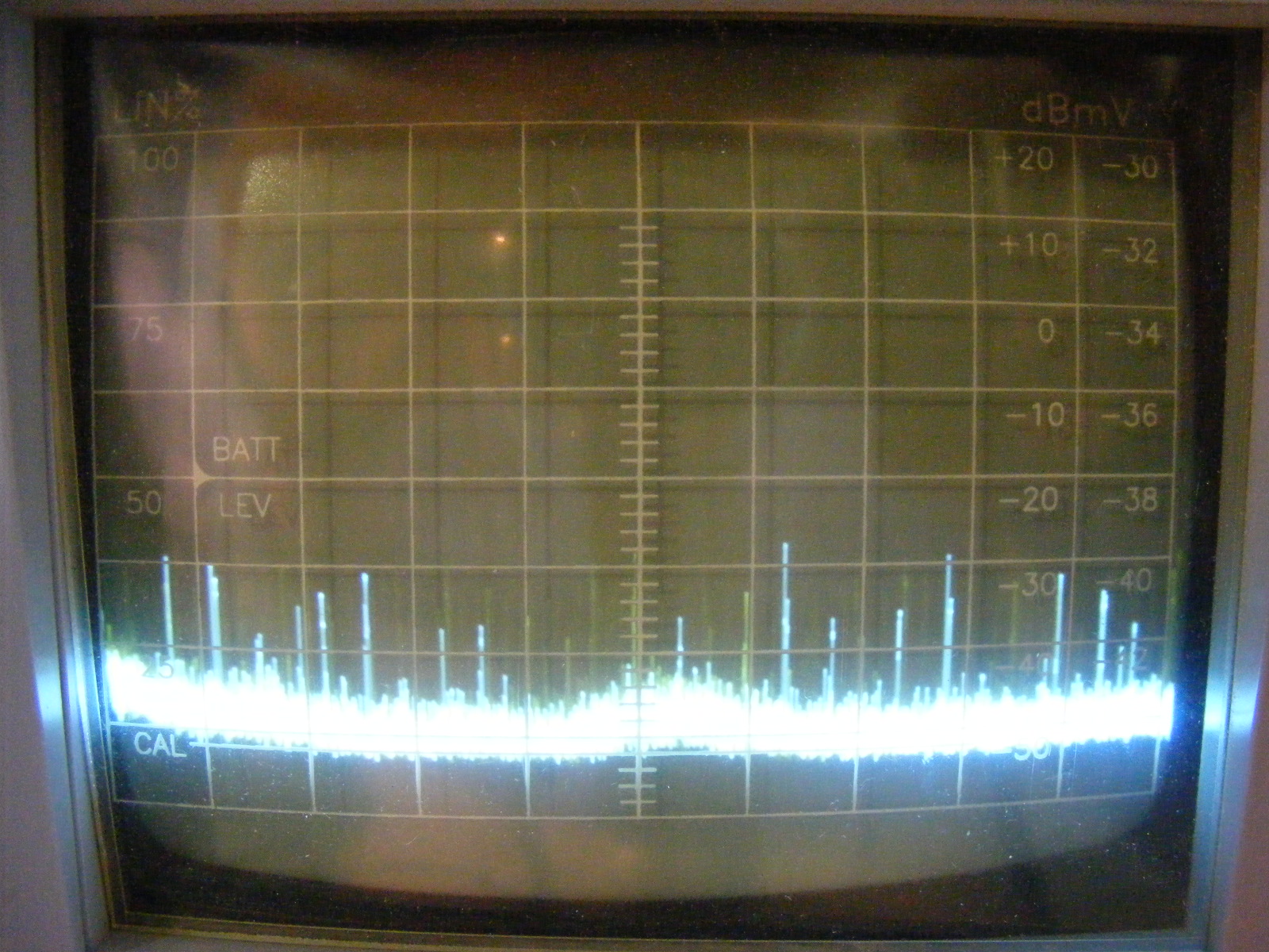

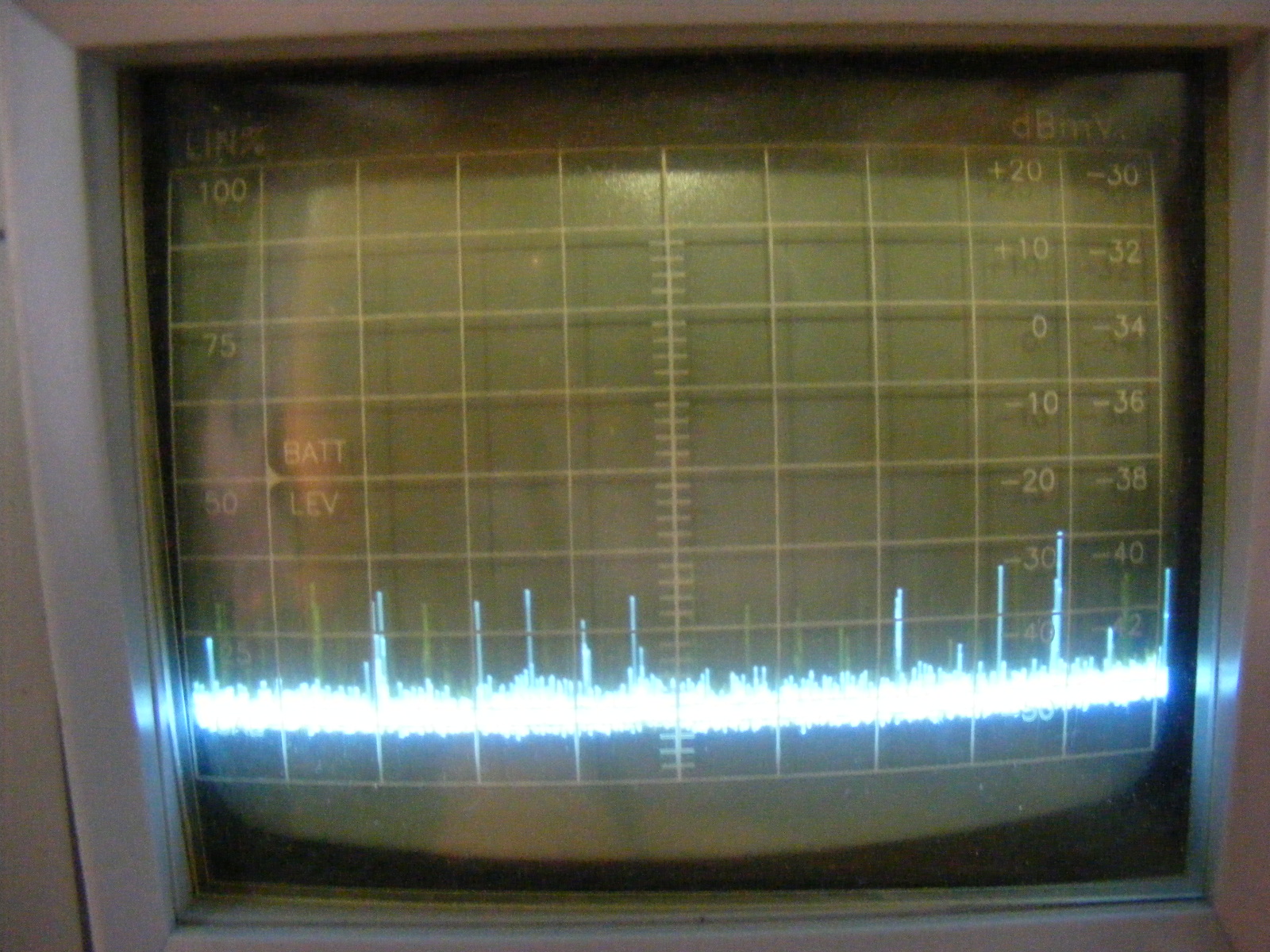

Well let me troll a bit and show the RF noise passing into a power supply.
First is the noise out of a 2 x 12 VRMS 12.5 A Toroid connected to the power line.
Next is with my noise generator turned on.
The third is with a center tapped dual diode rectifier feeding a 4700 uF filter cap.
The fourth is with an added .01 uf ceramic disc capacitor
The last is with a full wave bridge to limit the RF conduction time.

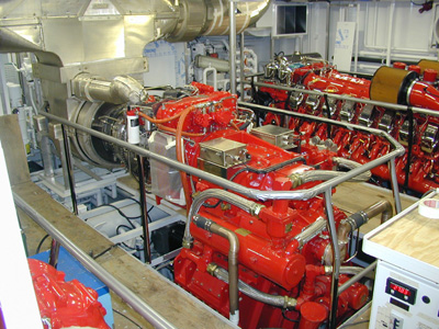

any more than you cannot reduce cubic inches in an automobile, without serious tradeoffs.
Chrysler Turbine of the early '60s.
Picture of a yacht engine room.
The silvery thing in left top center weighs 1500lb, does 5600hp.
Each of the diesels on the sides weighs 20.000lb, reaches 2/3d of the little one's power level.
OK, so a MiniMe costs four times the 1 million dollars of the heavyweight, not a serious tradeoff for some.
(bet you a million bucks there will be newlywed gasturbine cars again)
